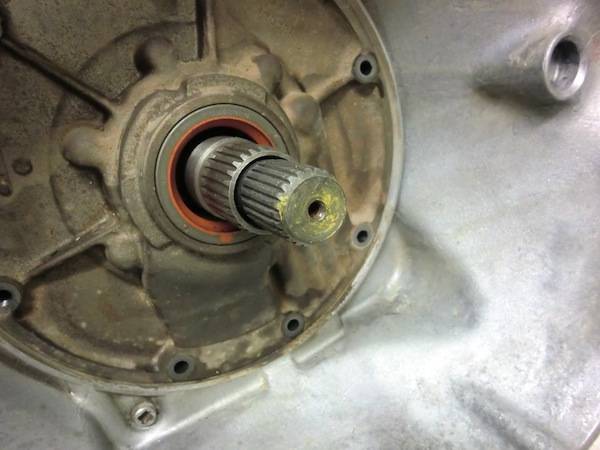

I recieved a 727 torque flight (used) for my challenger, plan on installing it on my engine on the test stand. I am not a tranny guy, so excuse my ignorance. I was told, it will "probably work" but may need new seals. I want to install it, so I can play with the engine on the stand. Anyway, I was looking over things, the output shaft locks into place when in lever is in park, as I expected, I can turn the output shaft (when not in park) and the input shaft by hand, but the reaction shaft will not turn by hand, is this normal? or is something wrong?
The reaction shaft doesn't turn, it's fixed and part of the stator. Pic below is for clarity (the outside "tube" is what you're referring to I'm guessing)
