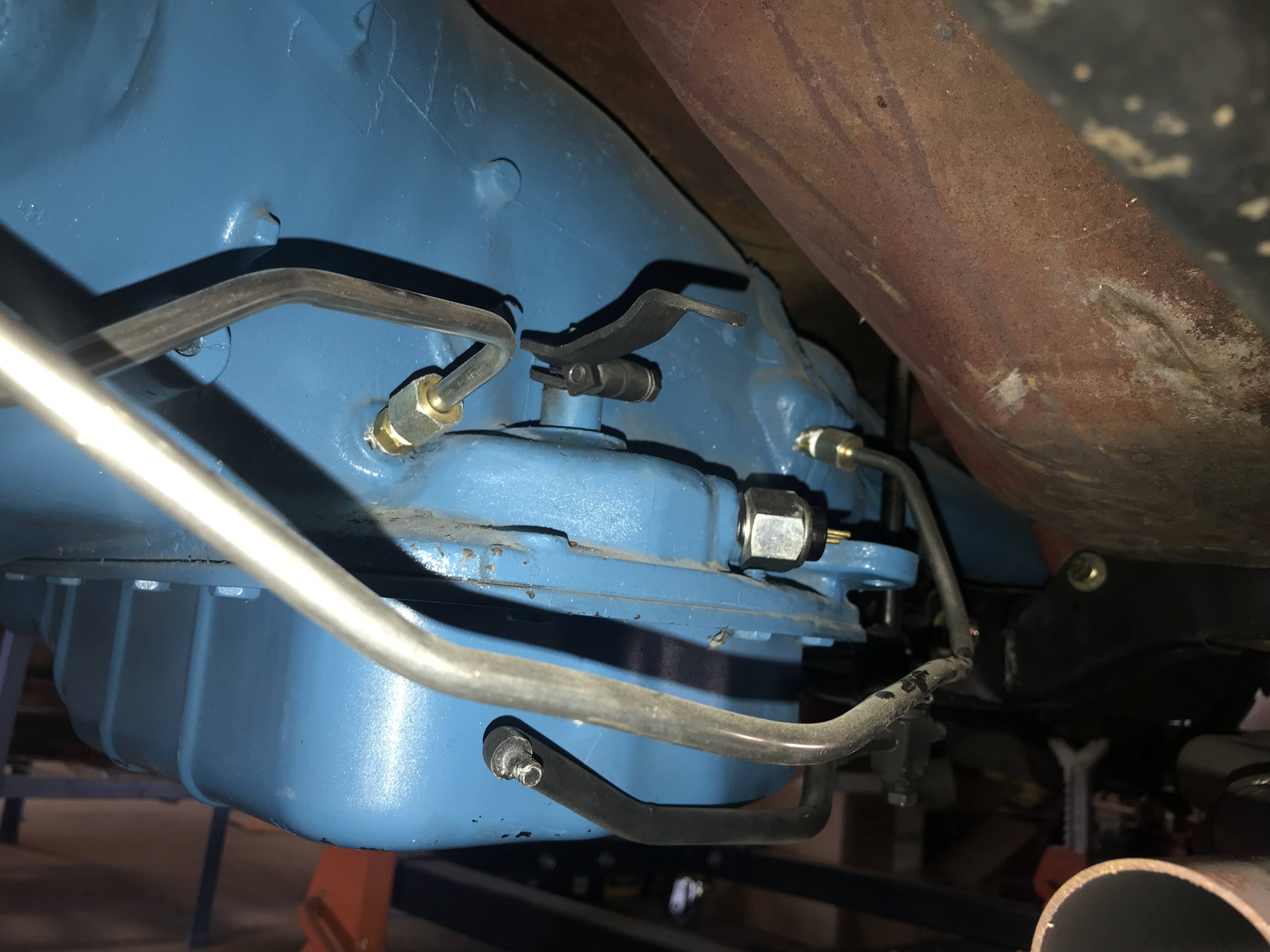

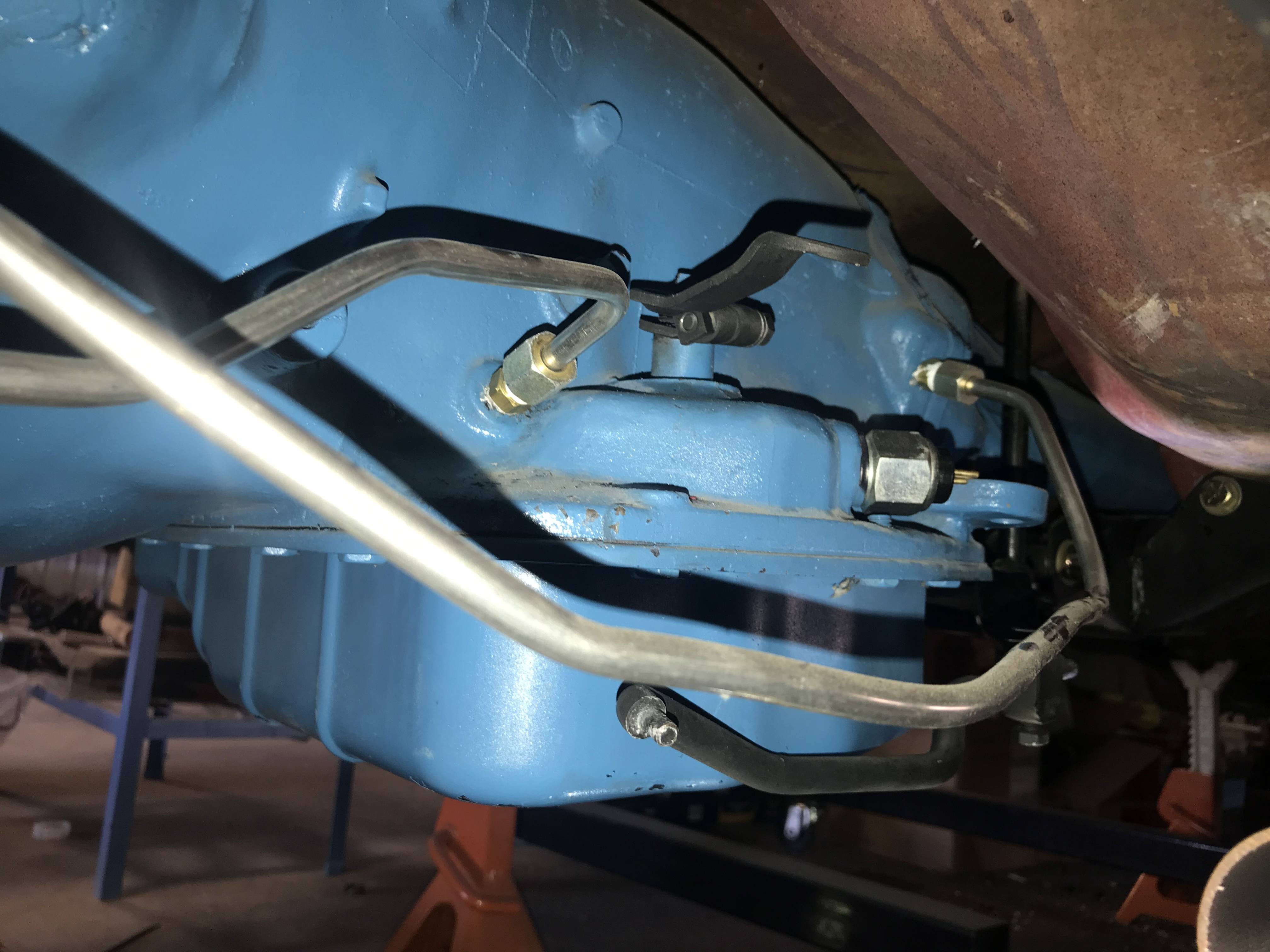

Hi All, it’s been a rough few months, but I am working on the Barracuda again.
- As you may remember, I swapped out the 318 / 904 for a Blue Print Engines 360, and bought the accompanying HP 727 Trans.
- I’m trying to install the gear linkage under the car. But, I don’t believe what I took off the 904 will work on this 727.
- The “adjustable swivel” that attaches to the “gear selector” in the transmission just doesn’t look correct.
- The Lower Rod (from the Torque Shaft Assembly” to the Adjustable Swivel) is several inches too low
- do I need a different linkage setup?
- Please see attached pics

That lever on the trans is upside down. Thats why it wont go on all the way.
