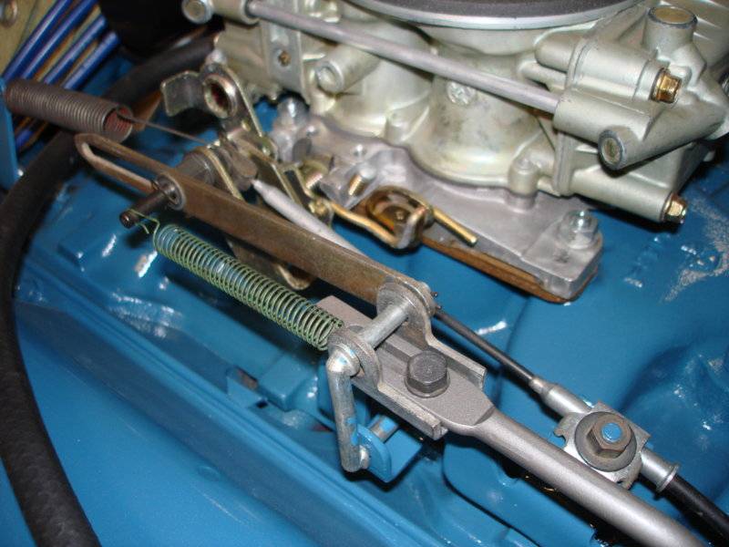

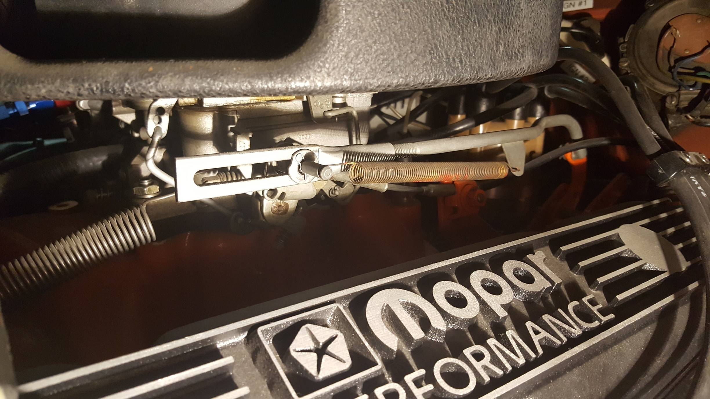

This may be an apples to oranges comparison, since I have a 70 full-throttle kickdown trans, but here goes. In my 70 340 Cuda, with a 727 TF trans, it will not kickdown at full throttle, from cruising speeds, if my WOT shift points are set too low. To fix it, I grabbed a pair of pliers, removed the clip to free up the throttle rod (the slotted one) and twisted it out a few turns at a time, tested it and repeated as necessary, until my WOT shift points were at 5000 to 5500. Remember, don't trust the factory tach for the rpm readings. It can read way too high, if it' like mine. If you don't have an accurate tach, calculate the speed at which you hit the desired rpm on your speedometer. For example, with 3.23 gears and stock diameter tires, 5000 rpm will be at about 50 mph at the top of first gear. For me, once I had the throttle rod out far enough to get the right WOT shift points, the trans would kick down properly, too. And that's it. If I'm right, this is a zero-dollar fix and you don't have to open up the trans. If I'm wrong, you didn't lose anything. BTW - check that you have all the linkage parts, and that they are assembled correctly.

DaveBob, I have a slightly different rod, it has a 7/16" bolt holding a slide bar and the bar is solid, down to the trans pressure lever, no adjustments other than at the carb/slide plate with the 7/16" bolt.

Does the slotted adjustment at the lower center of your picture allow you to change your shift points? It looks like you have the linkage at its shortest position. As you lengthen it, your shift points should get higher. Have you tried that? The other thing that prevents kickdown at full throttle is not having true full throttle. The throttle cable adjustment needs to be checked to make sure that it completely opens the throttle plates on the carburetor when your gas pedal is on the floor. With two people, have one push the pedal all the way to the floor, while the other person checks to see if they can manually open the throttle further at the carb. If they can move the throttle further, then you weren't getting full throttle.
