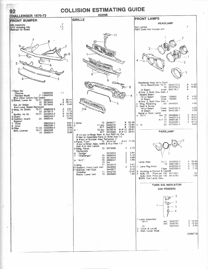

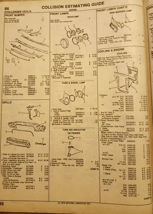

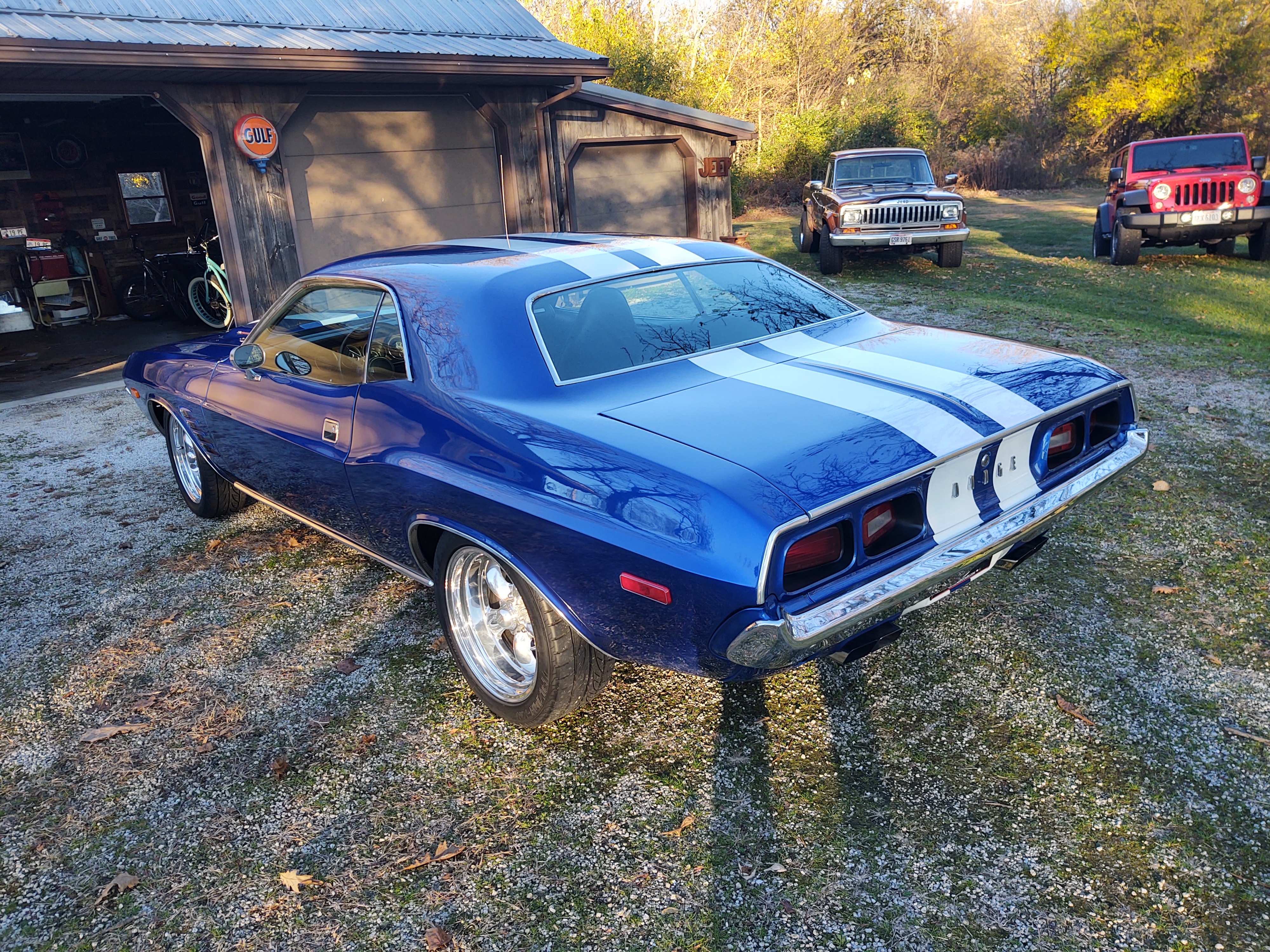

I have a 73 challenger that I want to replace front bumper , remove filler panels and move bumper in. Do I need 72 bumper and brackets?. The rear bumper is good condition just want to move onward. Do I need 72 bumper brackets?
