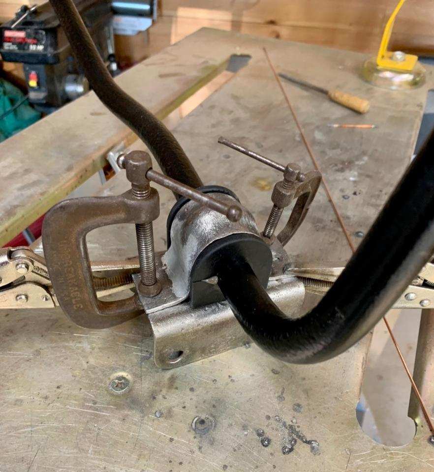

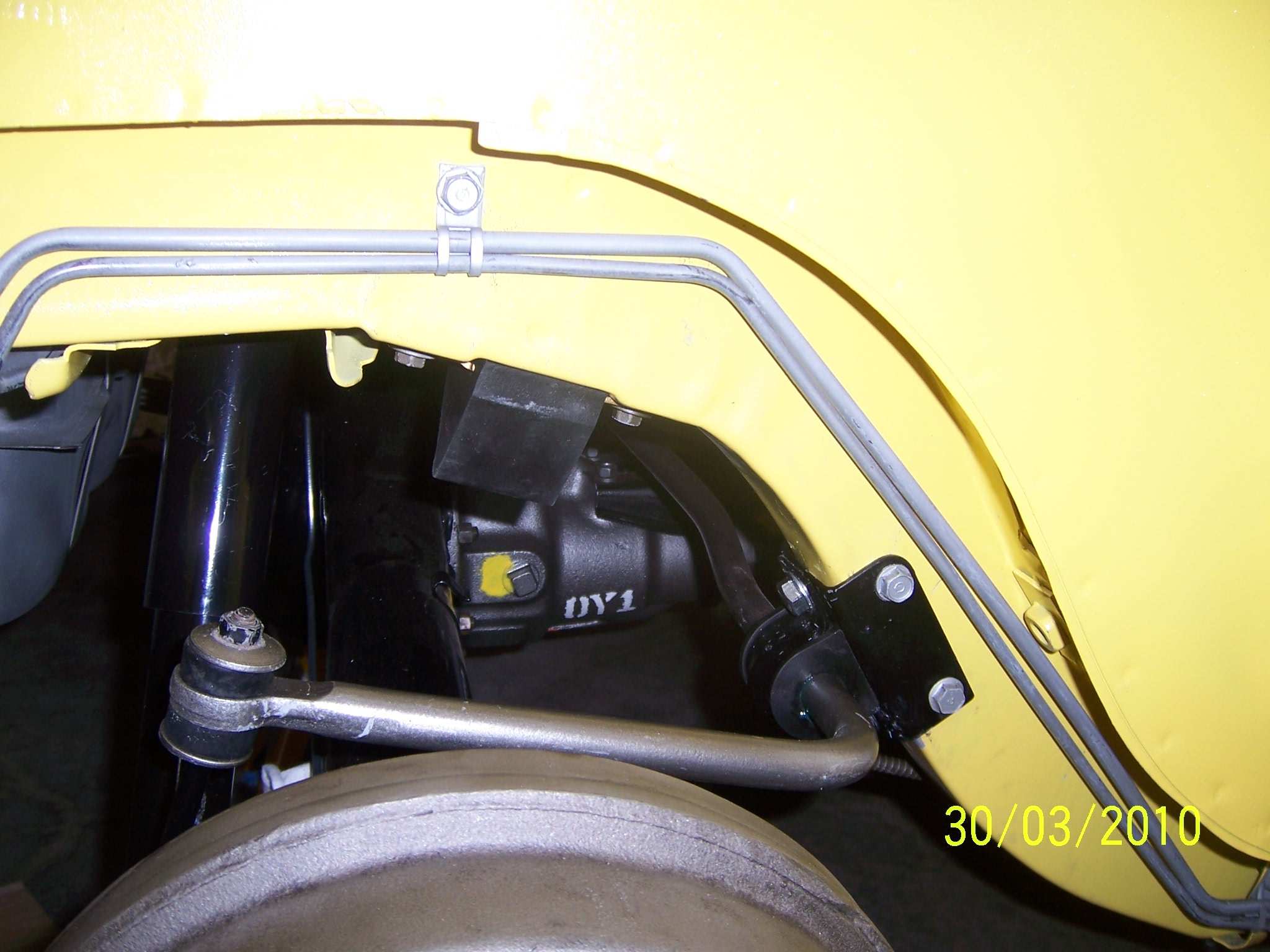

Nov 27, 2024 #3 EV2RTSE Well-Known Member Joined Dec 13, 2013 Messages 298 Reaction score 191 I used these- Energy Suspension 9.5106G 3/4in. SWAY BAR BUSHING SET – Energy Suspension Discarded the brackets that came with them, drilled out the spot welds in the original brackets, put in the new bushings and then we clamped & re-welded them. You could also use bolts like on this yellow car.
Nov 27, 2024 #4 D dennispsalm91 Member Joined Nov 8, 2023 Messages 17 Reaction score 2 Location Palm Coast FL Thats a great idea, im assuming the bushing will need to be split so it fits over bar correct?
Nov 27, 2024 #5 EV2RTSE Well-Known Member Joined Dec 13, 2013 Messages 298 Reaction score 191 They're already split, right out of the package.
