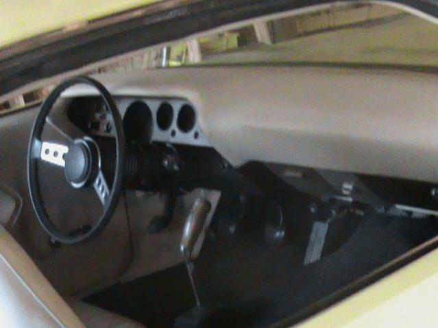

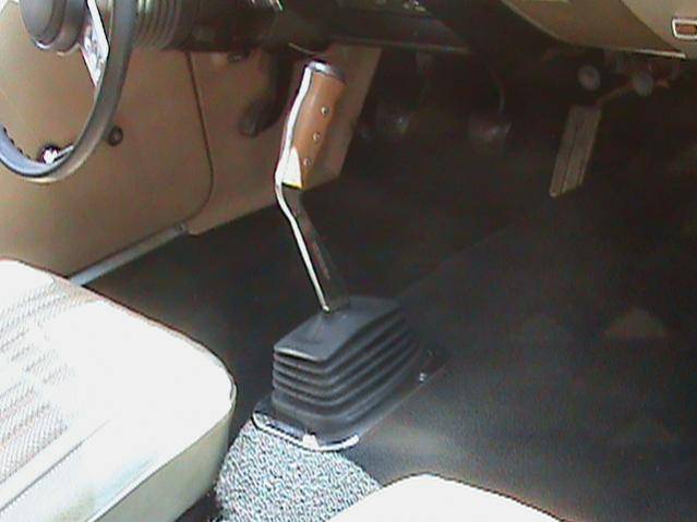

The "4 speed hump" they are referring to covers the hole you cut in the floor pan. It can be welded in or just screwed down in place with screws. I recently did a few 4 speed e car conversions and I just used screws to secure the "4 speed hump". the shifter mounts to the transmission. The shifter comes through a hole in the back of the hump. Your shift boot and boot bezel mounts there to cover that hole. The picture below shows the infamous "4 speed hump"
The hump in this conversion was mounted over the carpeting. Other wise you need to buy 4 speed carpeting as well. Another $160.00 to add to this mod. When I get the new 4 speed carpet, I will mount the hump under the carpet and I might even weld it in at that time...or not :happy7:
edit. in this car, I removed the console and auto shifter brackets. I prefer this setup commando style with no console.
I'm still trying to get enough money for a pistol grip shifter ( the one with the Hurst logo) so the carpet will have to wait!
The shifter stick in there now is a Hurst "Indy" but e body's must have a pistol grip I always say:wave:

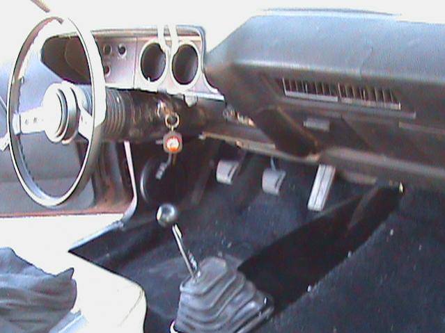

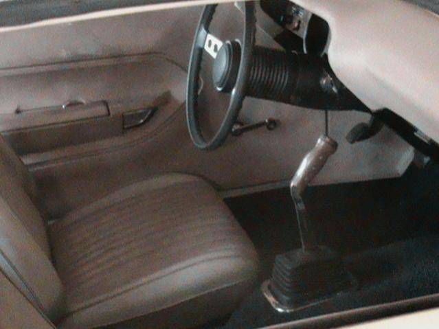

4 speed conversion to a 72 Barracuda..In the pictures below, the "hump" is under the correct 4 speed carpet..The "hump" is secured by screws here as well. Oh but look, this one has the pistol grip shifter...yay!
I'm old school and I firmly believe real muscle cars have 3 pedals:icon_smile:
