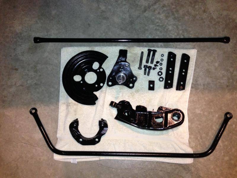

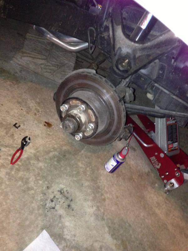

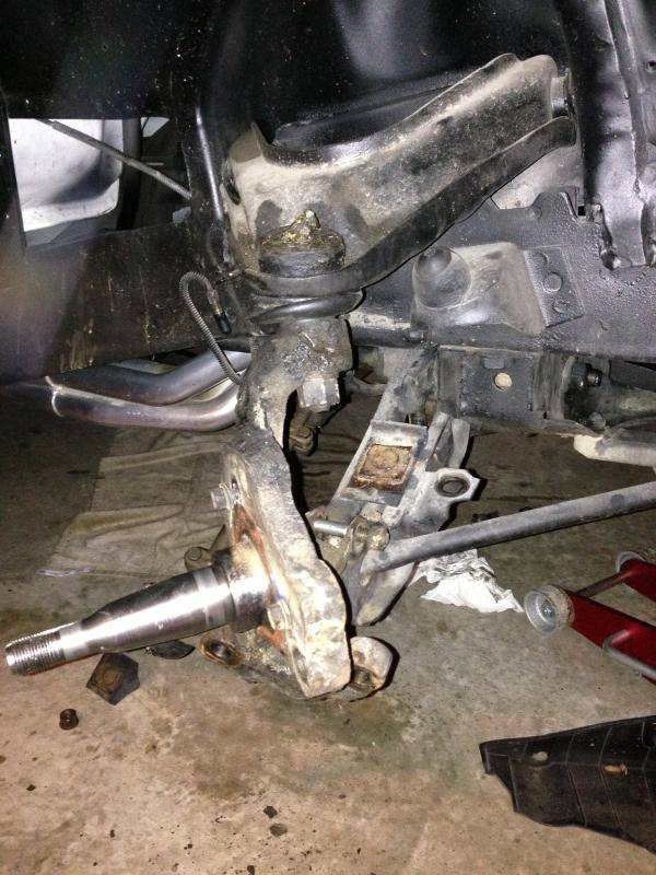

Well fellas, my Cuda’s handling just isn’t cutting it any more. She’s starting to get a tad squirrely. This car has been a part of my life since new and the front end has never been blown apart so I figure its time. Being a little intimidated by the job I’ve been reluctant to start but thanks to all of you who have posted various suspension related threads I’ve jumped in. 1[SUP]st[/SUP] move was purchasing a chassis manual which is fantastic by the way, I’m feeling invincible. Due to limited garage space I’ve torn down the passenger side. I opted for one of the complete frt suspension rebuild tool kits which has made the tear down easy breezy. Because the car hasn’t been in any accidents I was surprised to find a couple things. One, the upper ball joint was floating around in the A-arm. Closer inspection reveals some pretty worn out threads. Two, the strut arm has a bit of wiggle in it (pic below). Three, 40 year old grease and grime is stubborn as hell to get off. Next step is some sandblasting and paint. Anyway, thanks to many of you for getting me started.
The plan, as of this hour, is to go with poly bushing, replace the upper control arm along with the lower control arm strut rod. I’m thinking about replacing the pivot while I’m at it.
Thanks again for being a great reference. More to come.....

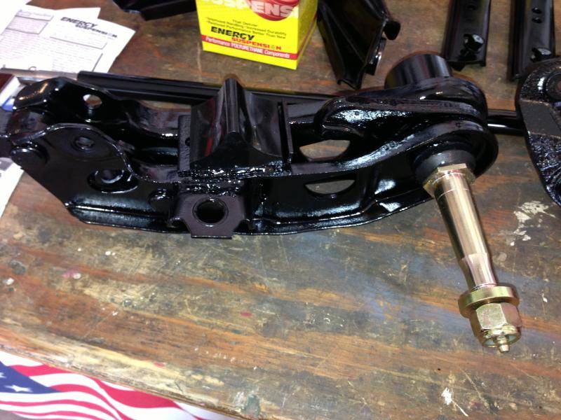

Blasted, cleaned and painted, these parts made the cut to be re-used. They actually turned out really good. I should have time to order up some parts this week or weekend. I'm tentatively leaning towards Energy Suspension Poly kit, Stock upper control arm for now (Hotchkis has a great piece but DAMN expensive), PST pivot shafts and adjustable control arm strut. This may change once I dive into pricing and availability but this is what I'm looking at anyway.
4,695
2,341
I have yet to be sold on replacement upper arms , the stock are one piece , no welds to break & with some offset bushings can get you a lot of caster adjustment . the second choice would be the Hotchkiss double adjustable arms to make the spindle move straight up & down , you lose the anti dive but gain on bump steer arc . but Ihave seen problems with the heim joints in street use .

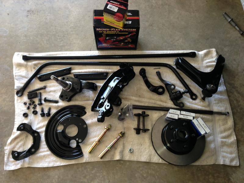

Well reality caught up with me as I was shopping for parts. I had to come back around to the original goal which was to freshen up the front end to improve handling. The cost exceeded my initial estimates due to replacing the upper control arm, strut rod, brake rotor, and bearings. Little stuff like paint, brake clean, chassis manual, and tools really added up fast too. Good, bad, or indifferent this is what I came up.
$119.95 Energy Suspension Hyperflex kit ENS-5-18105G
$10.69 Energy Suspension Stabilizer Bushing set ENS-5-5113G
$110.00 Firm Feel strut rods (originals were bent)
$100.00 Firm Feel greasable lower control arm pins (nice piece)
$129.99 Classic Industries upper control arm (ME1617)
$9.99 Poly upper control arm bump stop
$36.78 Car Quest Lower Ball Joint PCH 505-1003 (K781)
$14.38 Car Quest Qty 2 eccentric cam bolts
$26.78 Car Quest Brake rotor BDR
$6.92 Car Quest Bearing A17
$8.18 Car Quest Bearing A2
$2.32 Car Quest Oil Seal 5314
A few other items I need to pick up are:
Torsion bar dust boot
Wheel Bearing cap
Splash shield gasket
Prothane grease 19-1751
Shocks
I’m sure I’ll have more incidentals but this is where it’s at today. I’m hoping to start the assembly soon. Good news is once this side is done I get to do the other…..;-)

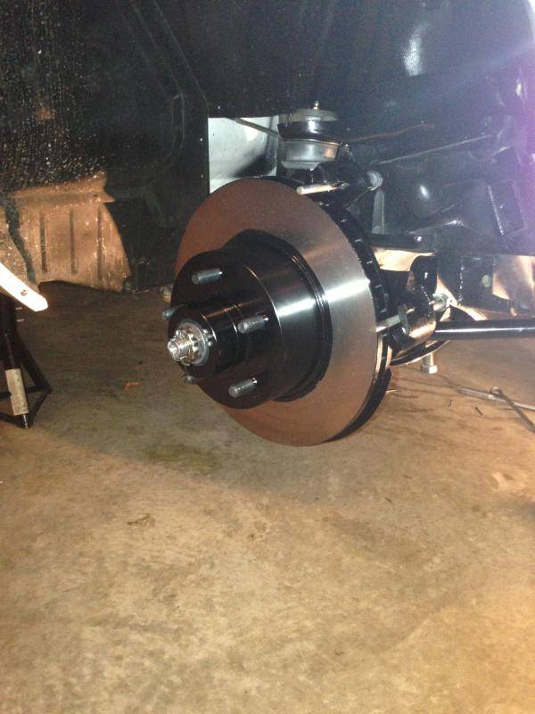

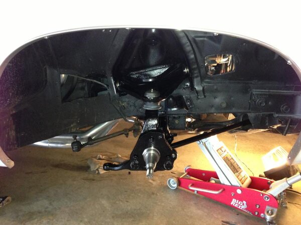

tpietzsch
Jun 29, 2011
24

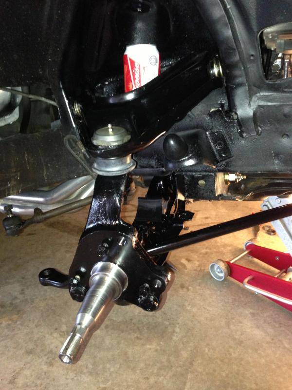

It's going back together lickity split. I just need to order those other parts and I can call it "done son"!

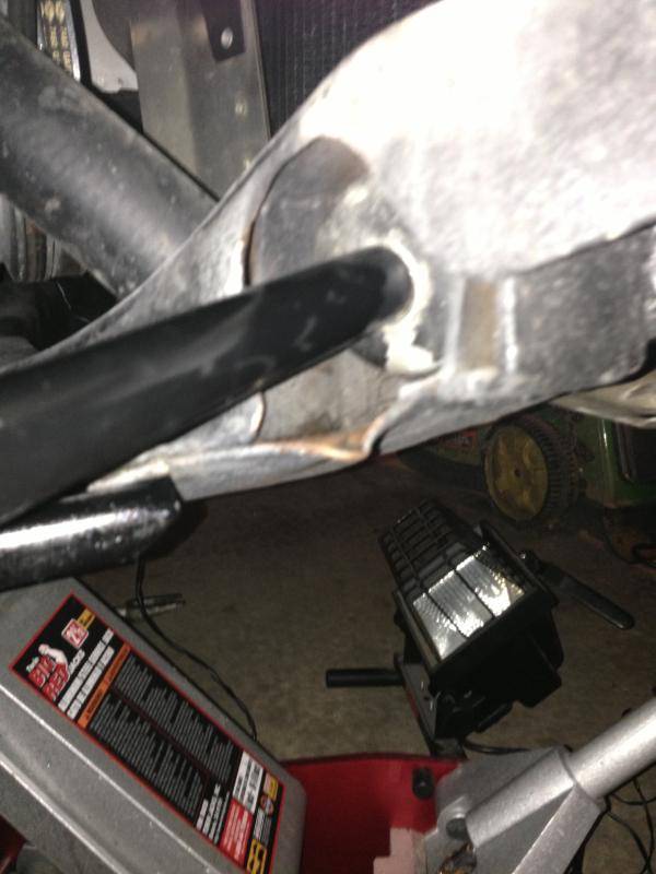

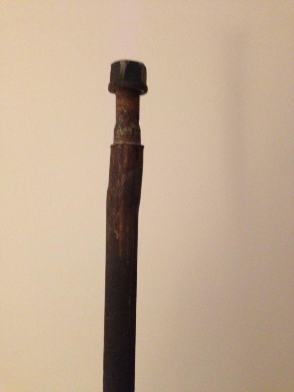

tpietzsch
Jun 29, 2011
24

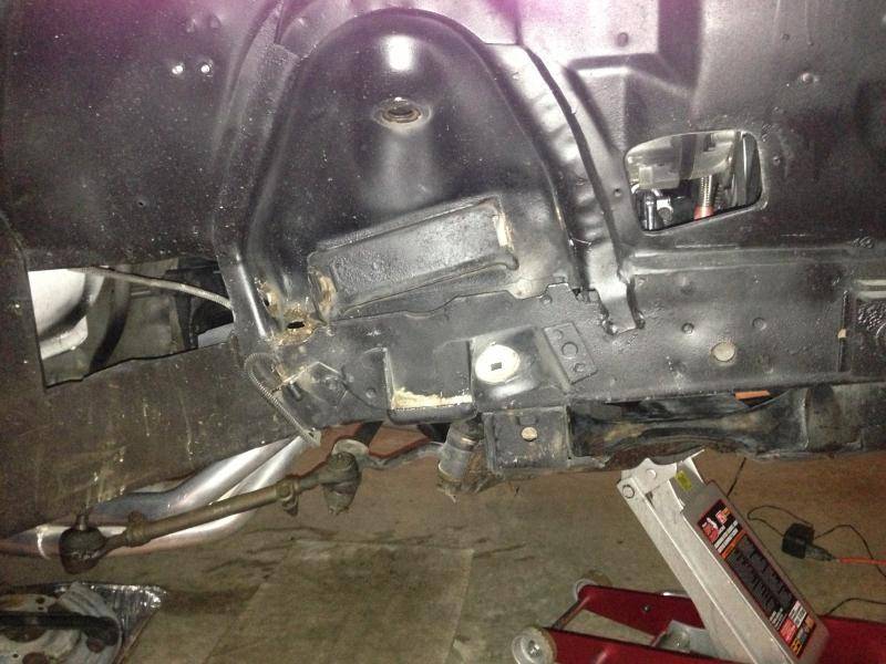

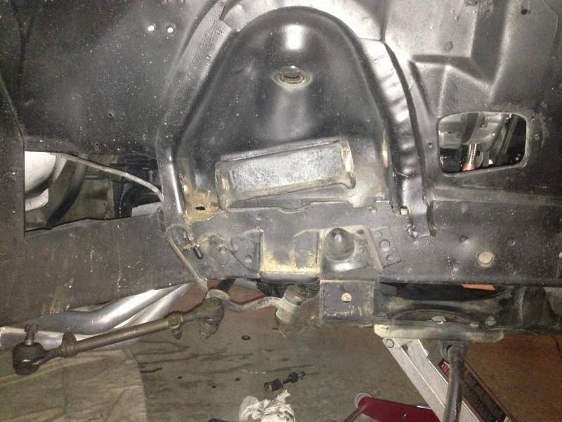

I didn't notice this nice divot in the K member on tear down below the strut rod but this explains why the rod was bent. Also hoping I didn't get into to much of a hurry with assembly as i still need to slide the torsion bar in. Wondering with the upper control attached if there will be enough droop to allow the bar to be inserted into the lower arm. Crossing my fingers. Awaiting the dust boots.
