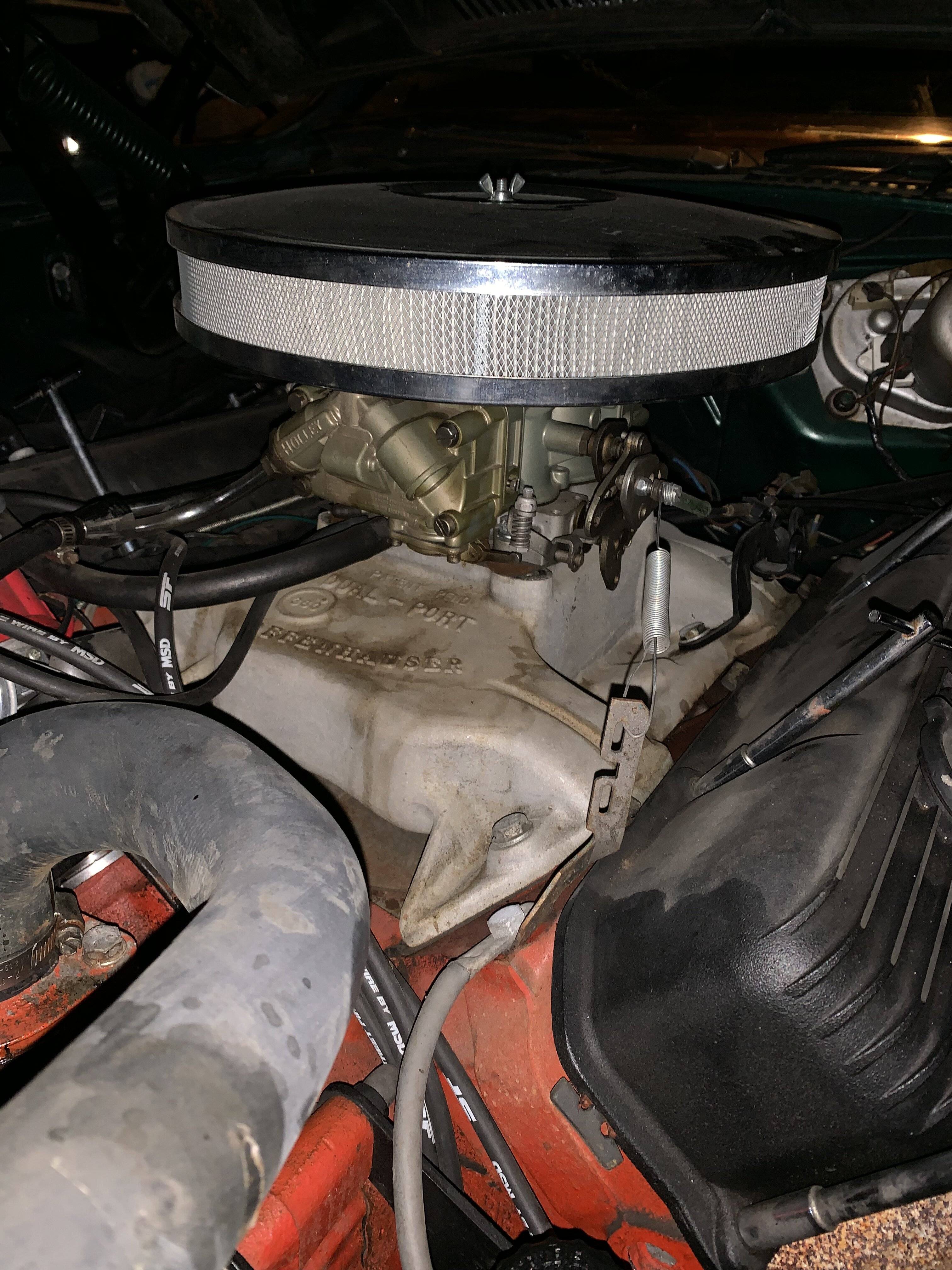

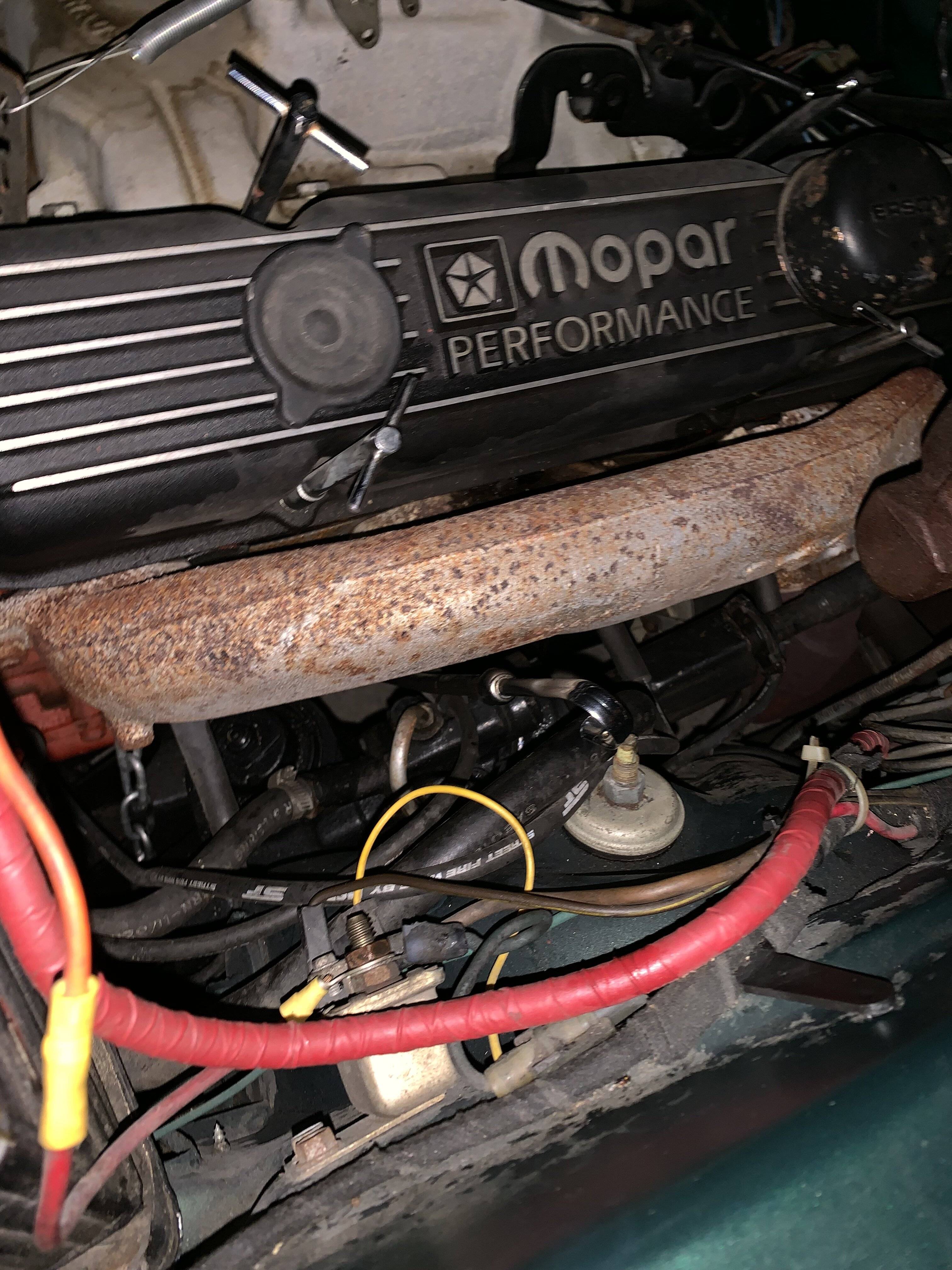

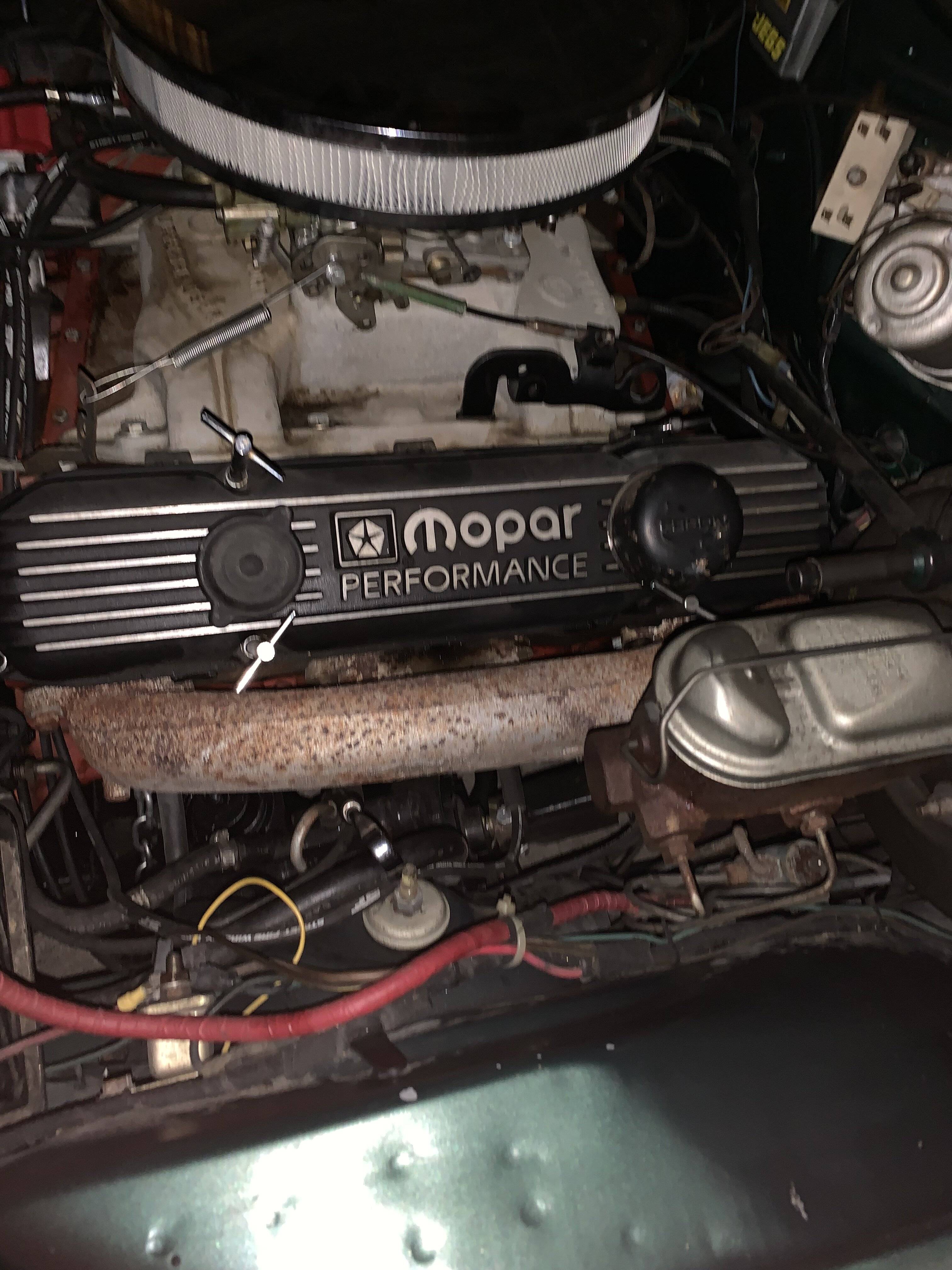

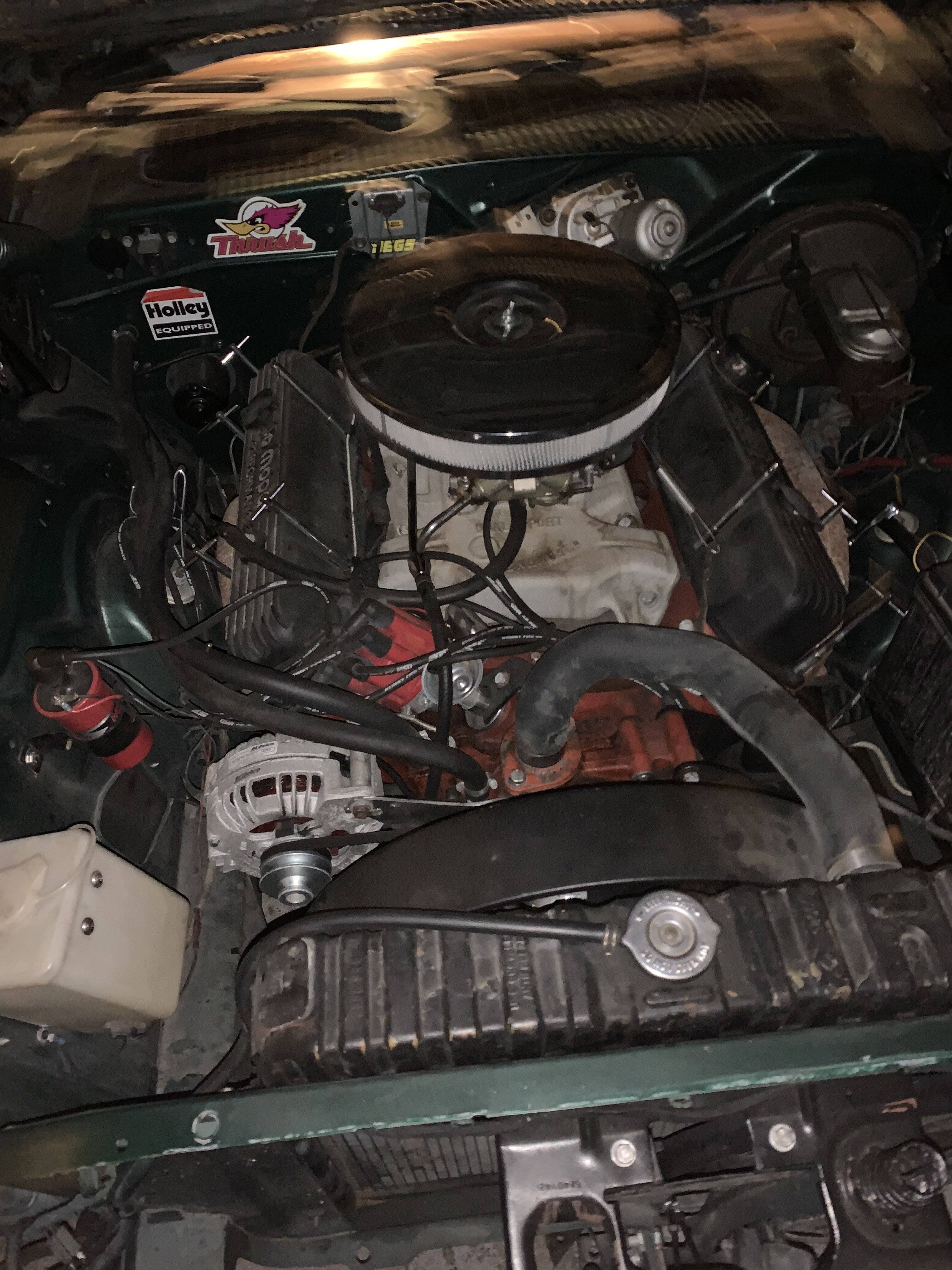

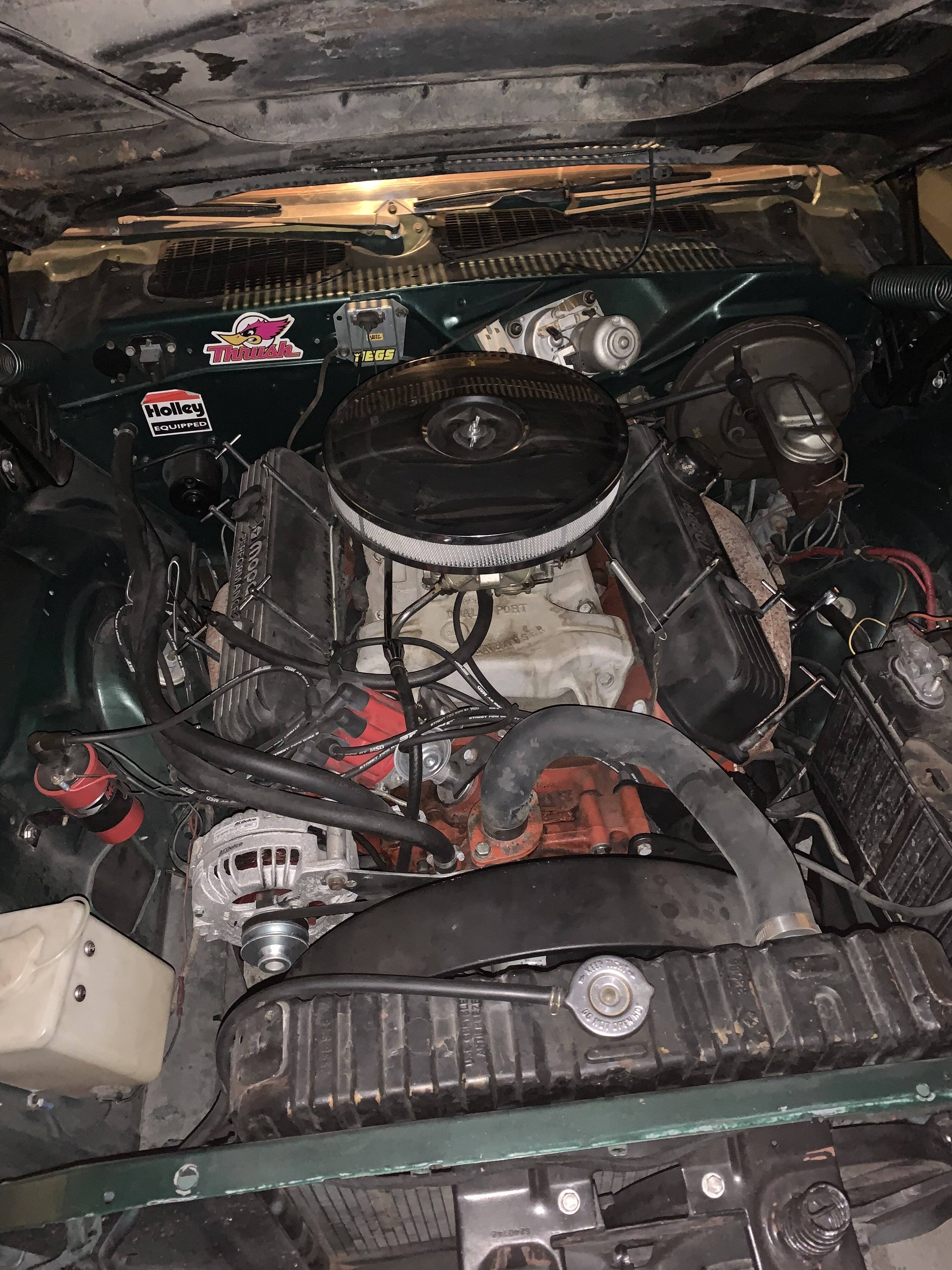

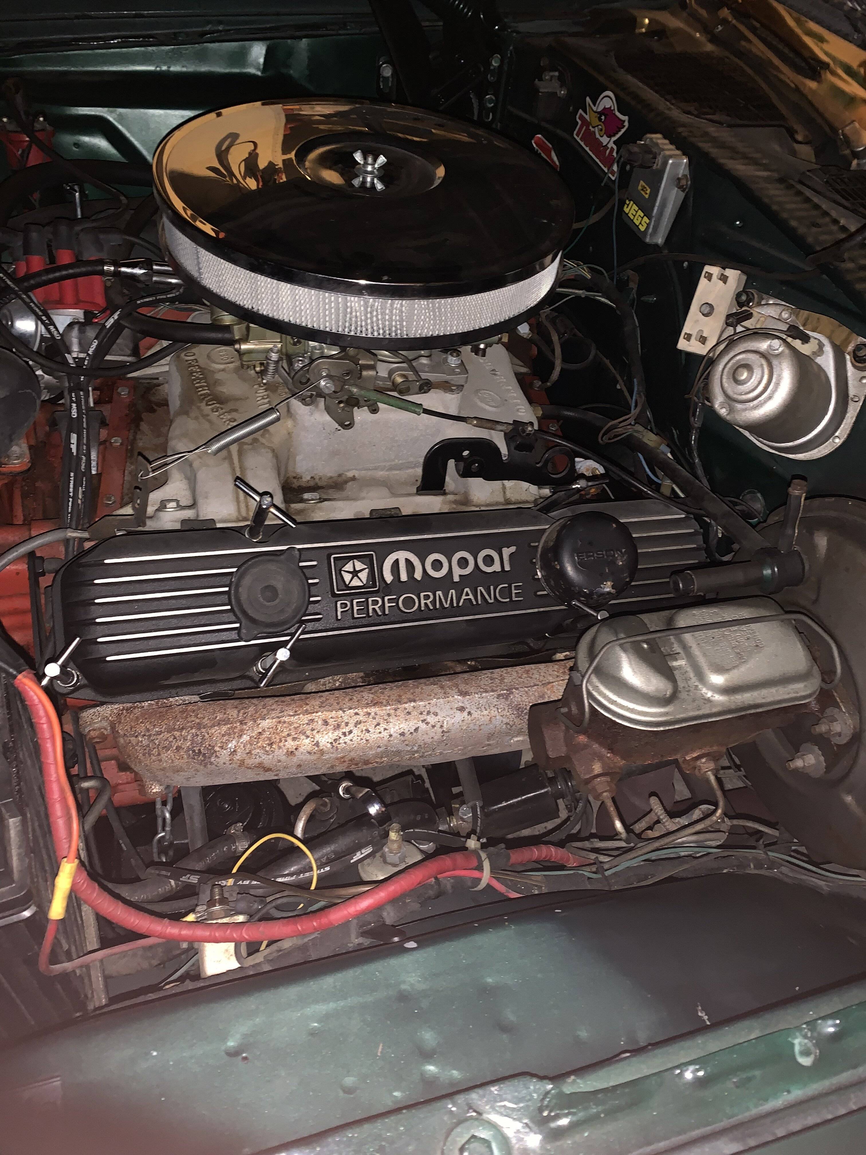

Hello everyone, I would just like to share some engine bay pics of my 73 dodge challenger with a 440 big block & 4 speed transmission out of a 1970 roadrunner. I am a younger gentleman and would love to learn more about these wonderful machines. Any names of main important parts or any others that you recognize would be appreciated. Thank you. IMG_2893.JPG
Chryco Psycho
4,721
2,371
Panama
Rare Offy Dual port intake , a Holley Street Dominator 300-14 is far better .
Aftermarket Holley Carb , probably a good choice , the air filter is restrictive , too small .
Looks like an MSD ign system .
Chain for a torque strap on the left side which is helpful if a mount fails .
You need to connect a PCV system , just a breather on the left side is not enough .

Thank you for the info. If I end up looking into doing that stuff this coming season I will for sure keep in touch. Thanks again!

Incorrect intake manifold throttle cable bracket( need one for a high rise manifold) and carb attachment bracket , spring and spring mount.
Geometry is all wrong. Every thing should be pretty much parallel.
Also Check all the mounts.
