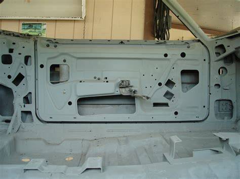

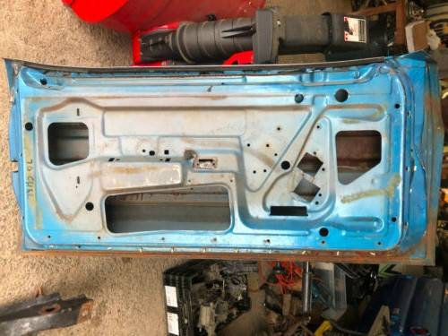

Yes I know I was pointing out the difference That I knew for sure. the accrual inner structure is different,mounting locations? But having less teeth it may work . Or it having less teeth may not have complete travel. If you find one to try you have only time to lose. Blue door is a 10 69 build date not sure of the primer one. 3rd is a 71 with a 11 71 build date. study and compare you might see a difference? Difference might be in the track and regulator.

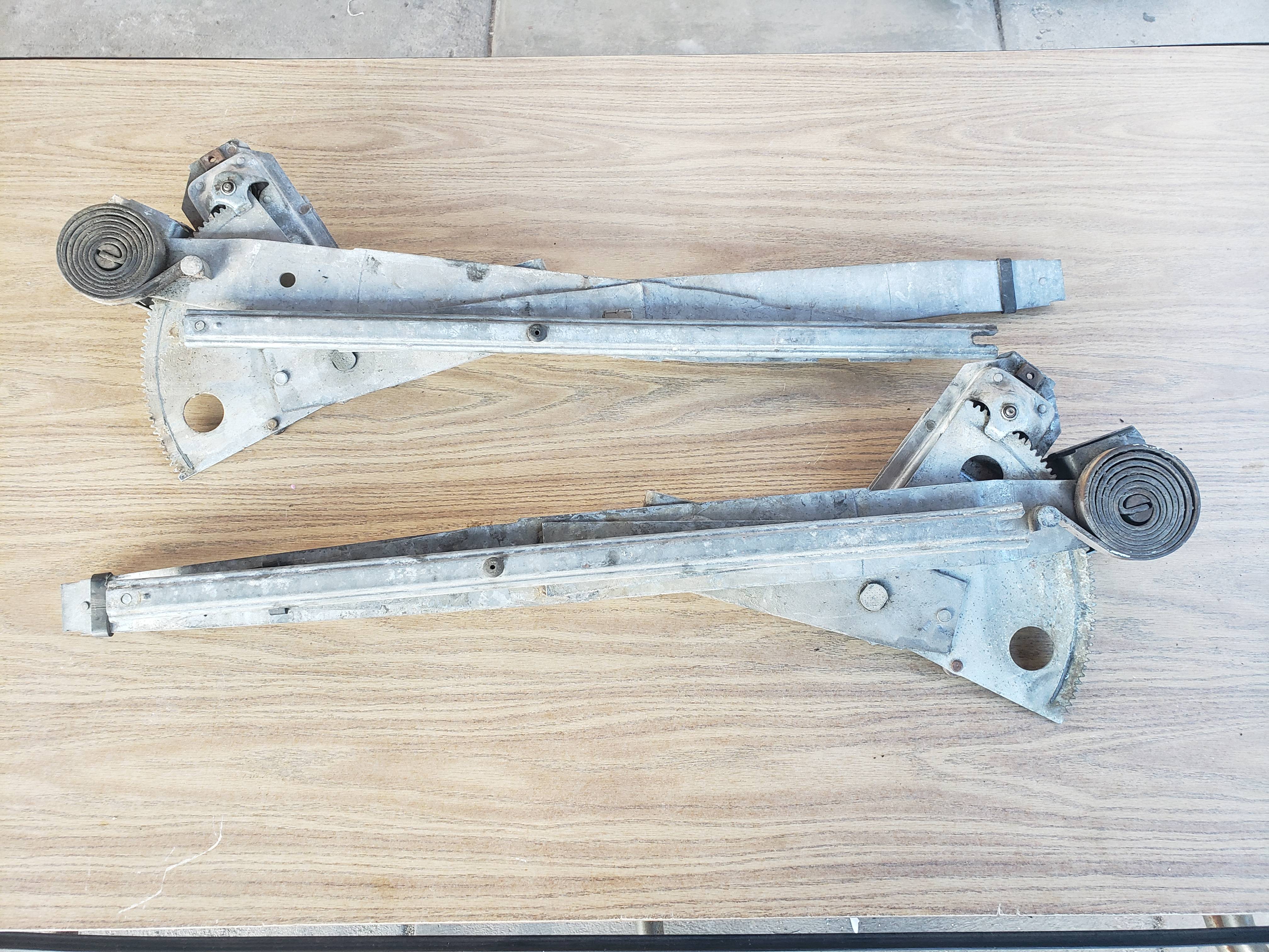

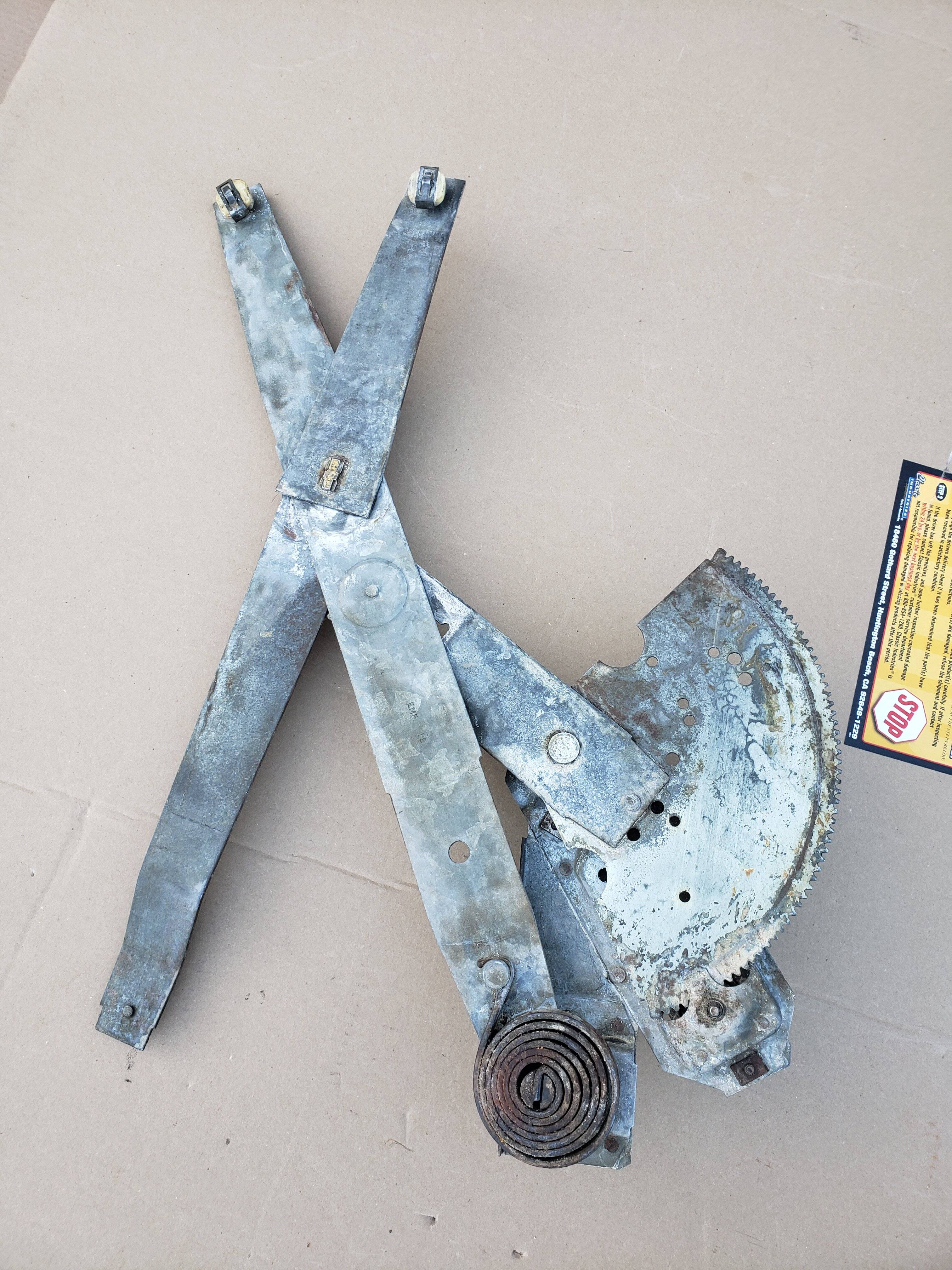

I have this regulators that I removed from 73 1st pic
But also I have this other 2nd segulator with only one cut out that I am not sure if is for 70 because what I seen 70 have 2 cut outs.
