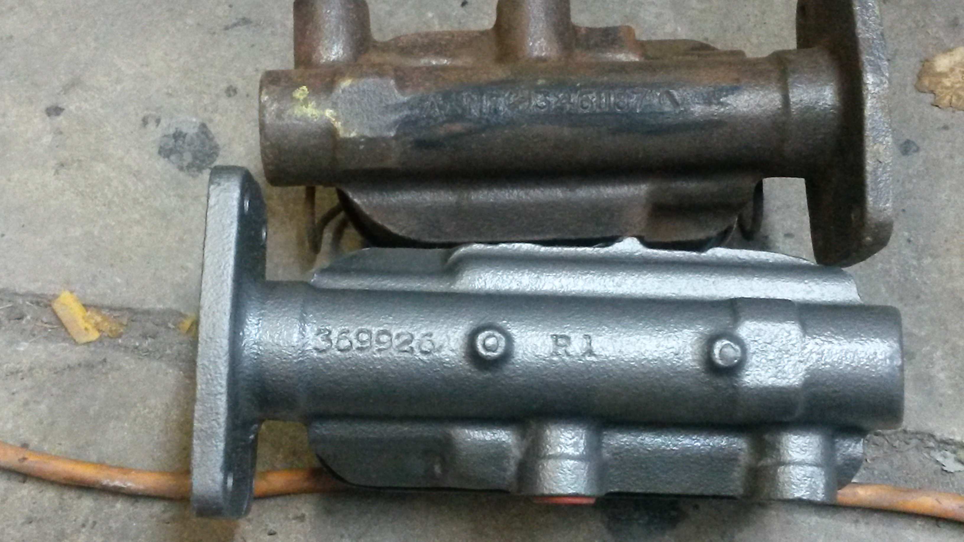

It's more so the larger bore is for the Front disc brakes. The disc brakes require more fluid. The residual valves in the master cylinder from drum and disc retain a different pressure. Top is 71 bottom I think is from a 73. Both disc drum.
