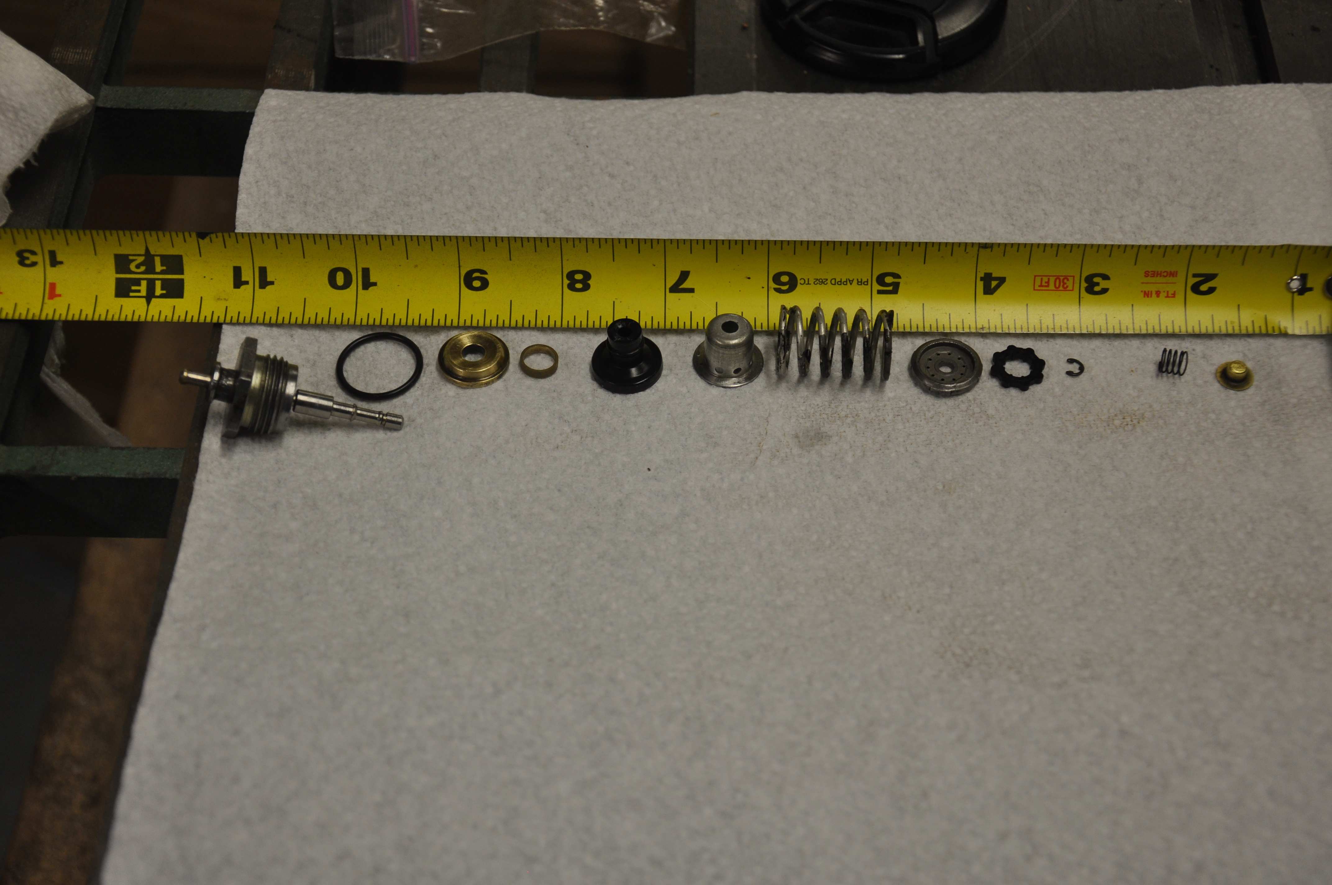

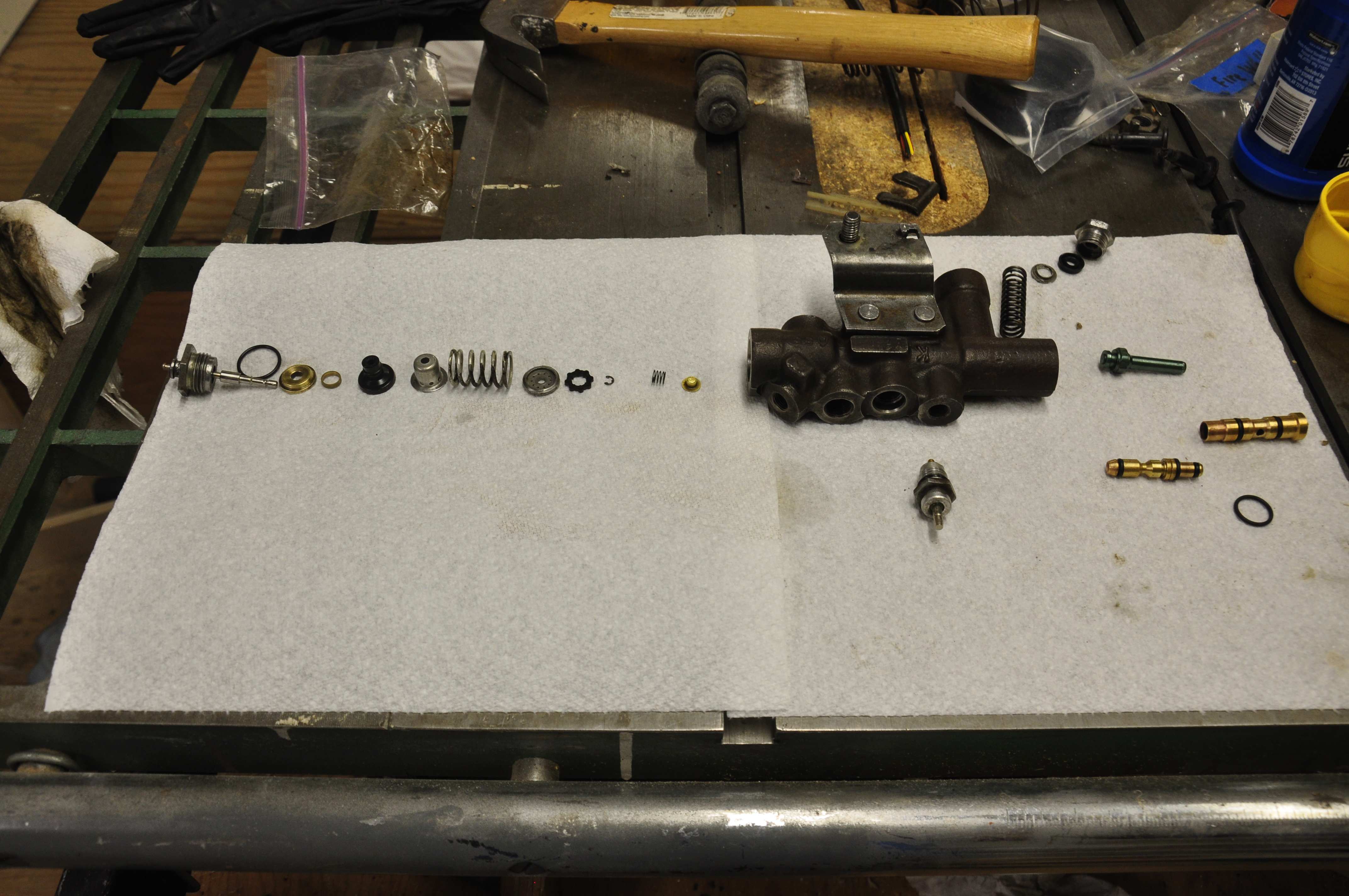

I had a hard time finding one that was usable. My original from my 73 was impossible to disassemble. Pulled one from a junk yard, also impossible to disassemble. Got one from a club member that I believe was from a 73 but not sure. That one I was able to disassemble. Could not find any one line or remanufactured, In my case I was upgrading my break lines to Stainless Steel so I wanted the cast iron or steel version of the housing. Did not want to strip out compression nuts in the brass housing trying to get the steel lines to seat properly. Whatever you find, I would disassemble it and fully clean it. Attached some pics of the internal parts. I have more pics if that will help.

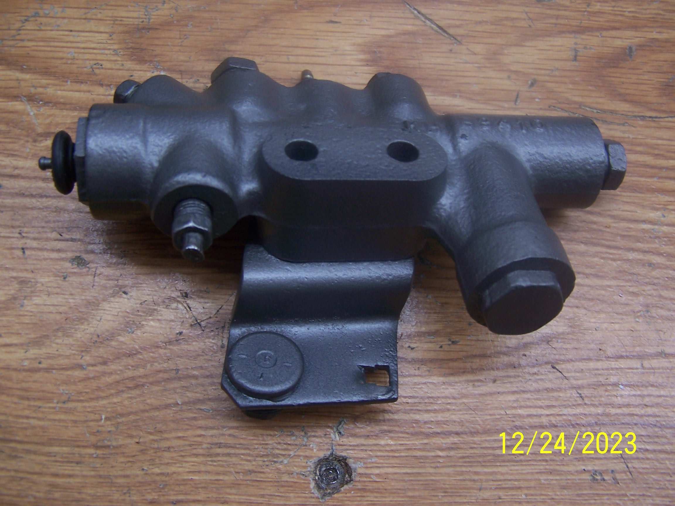

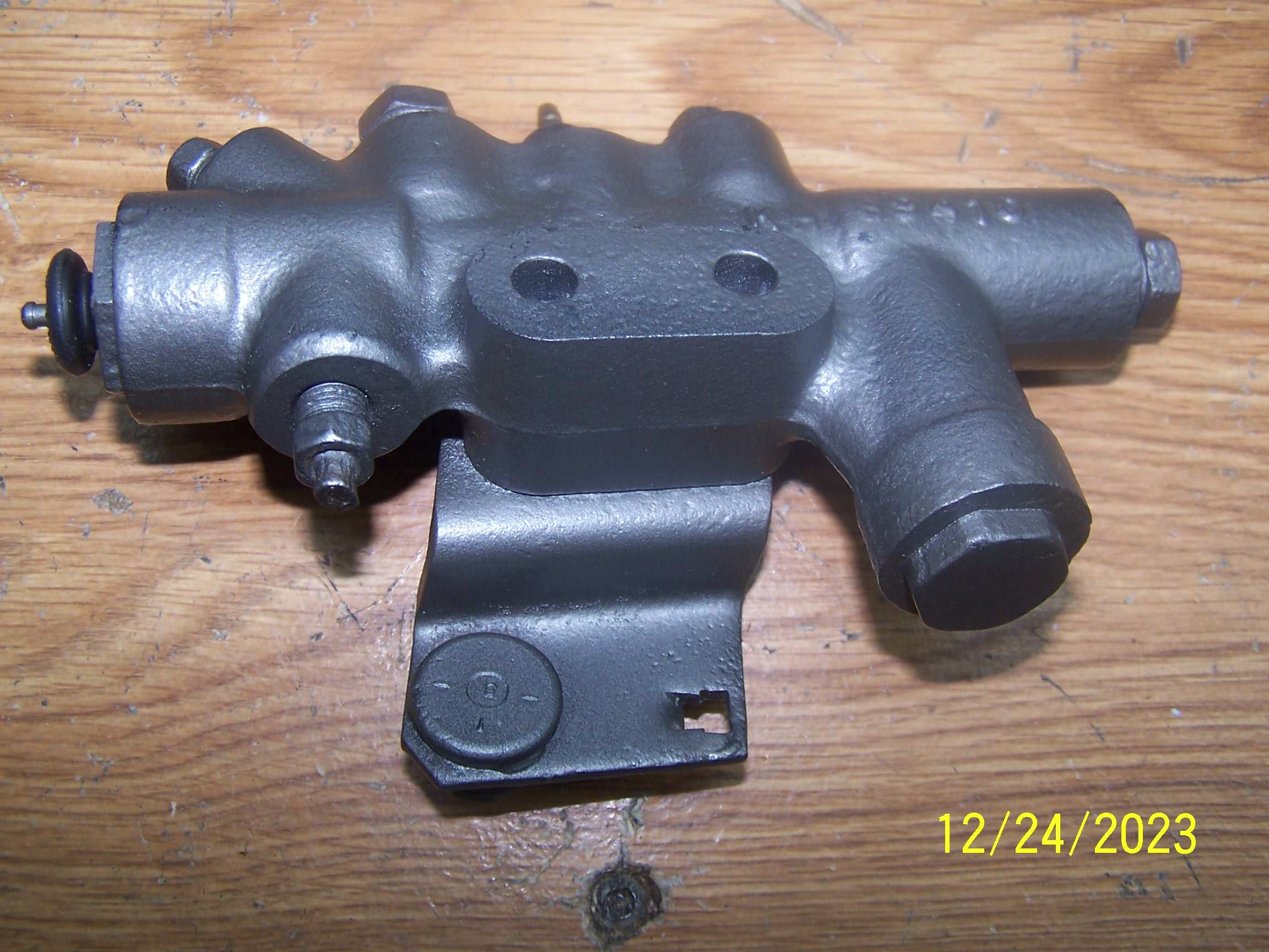

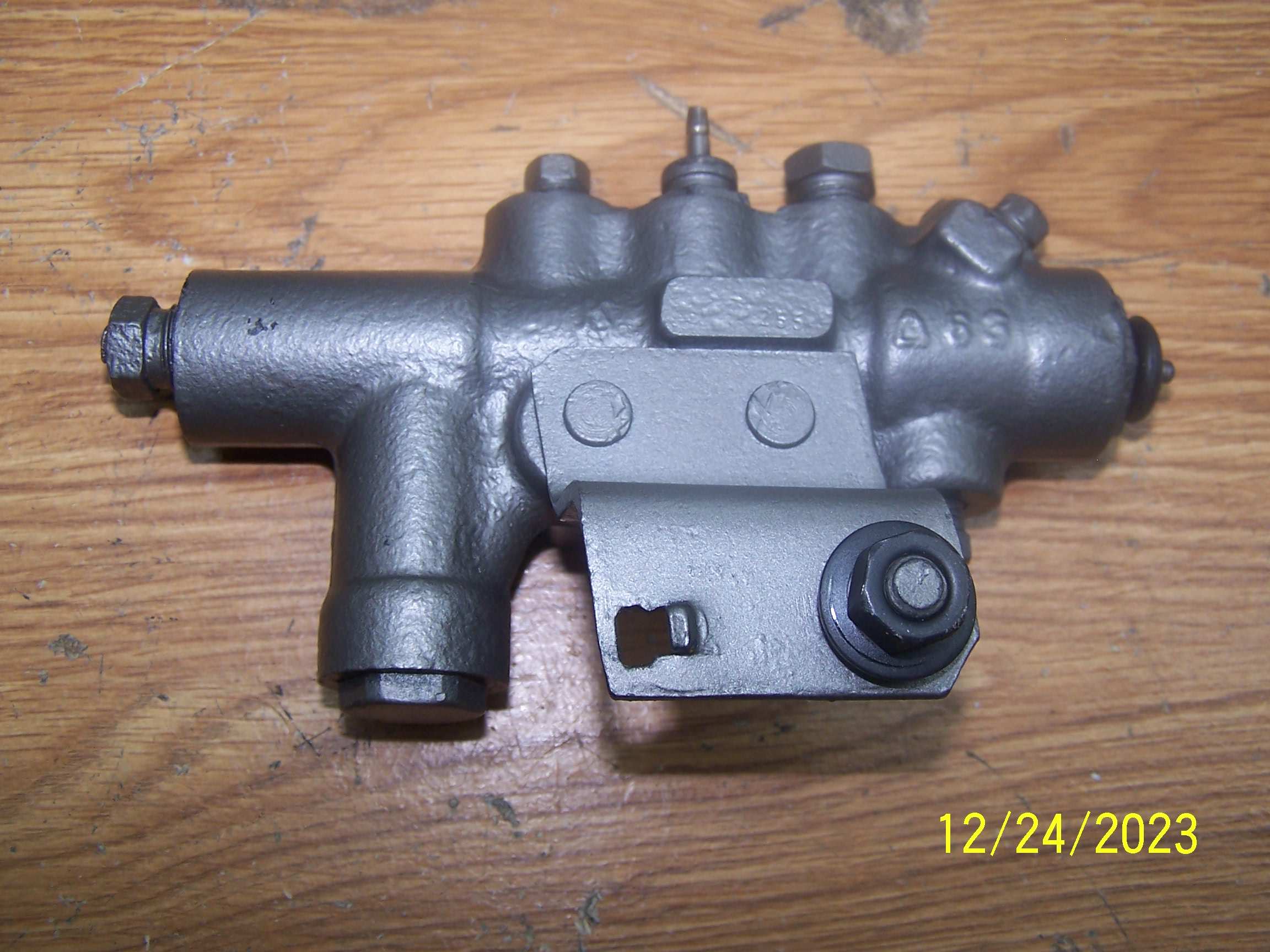

Mine was not bad. Rust outside but not in. I rebuilt it with a kit I forms on line - vendor escapes me at the moment - but I could not get the one plug to seal so I replaced it with a unit off Amazon. Similar to the one classic industries sells but in brass. Same port positions but needed to make a couple short adaptors for fittings. Since then came across Old Auto LLC who advertised a service to rebuild them
