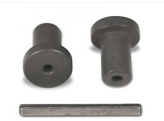

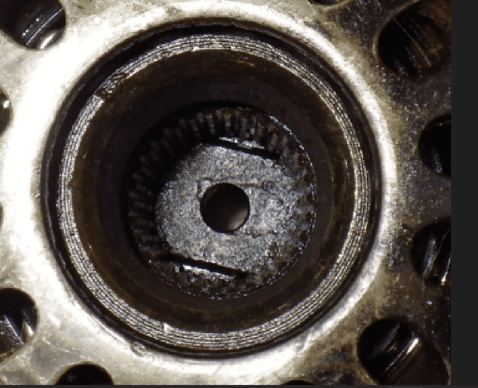

the earlier sure grips had 2 button that go through the center pin to set the end play for the axle brgs , both of these buttons need to be in place , I use a bit of heavy grease to hold them in place during assy , possibly one or both fell out into the spider gears , you would have to remove the center housing again to check

Correct with both axles in , will not turn at all. Are you able to install buttons without taking apart the unit ?

Update , yes i greased everything, buttons are both there. The passenger side axle wasnt turning because whoever had car before had adjuster all the way out so bearing was frozen. I loosened the adjuster . Put center section on bench
put both axles in, they will only turn one way only on either side. When no axles are in center section i can turn yoke either way Im getting closer, thanks for any input
