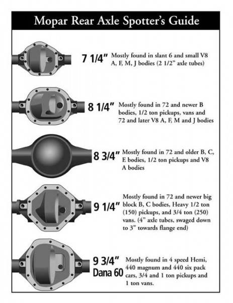

8 3/4" or 8 1/4" rear end
Avalanche
Sep 1, 2011
589
81
Massachusetts
Can someone tell me how to tell the difference between a 8 3/4" to a 8 1/4" rear. Is there any way to tell if its a sure grip without opening it up?
