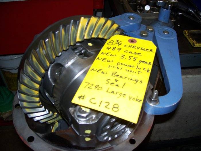

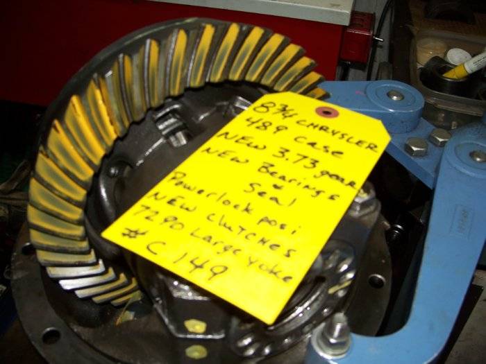

the shop did the gear set up - did you do the install of the rebuilt center section into your car or did the shop do that as well -- if you did the install -- did you notice if the shop did a pattern check with gear marking compound to make sure the gears were meshing properly . if not then for sure the gears were not set up correctly.
the pattern check is the final say on the correct gear set up -- once the correct pattern is achieved , now you do the final assembly which will be pinion bearing preload and backlash . this goes for all differentials Ford , Gm , Chrysler etc.
here are a couple pics of 8-3/4 I've done showing the patterns
if all after market gears were noisy --no one would buy them
