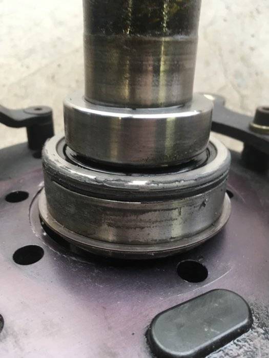

I have a 73 Challenger with a 8 3/4 rear end 3.23 posity.
The right grease seal is leaking so I ordered a grease seal for the standard 8 3/4 seal.
upon removal of the axle I discover the existing bearing to be different. I think it may be a Dana. See picture of existing set up below. Can someone confirm what I have?

That is correct mine has a grove for a clip to hold the holding plate and a o-ring for a seal on the other side of the bearing face.
The first set of bearings I picked up did not have the grove for the clip and resulted in me wasting $100. My recommendation is to pull the axle first them you will know which bearing you will need.
There two types One has the holding plate pressed onto the bearing. the second has a snap ring and bearing grove to hold the plate.
