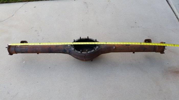

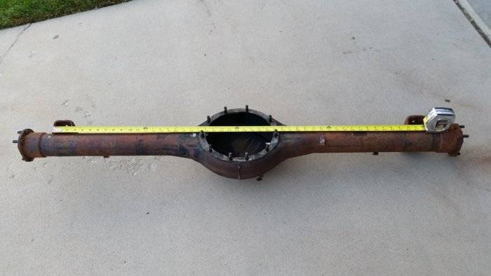

Took some photos.

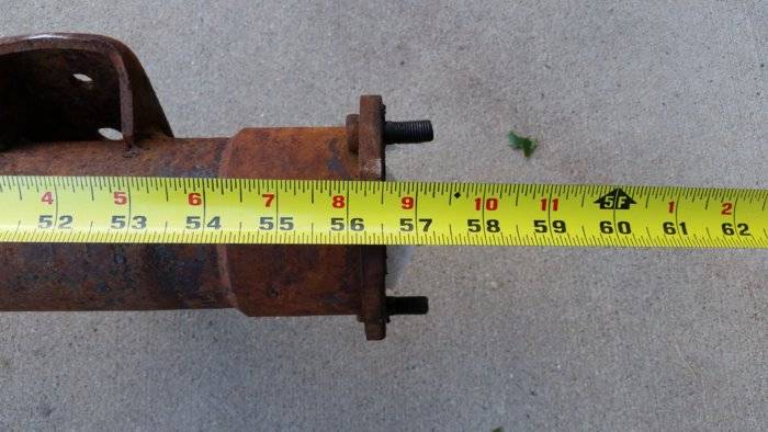

56 1/2 flange to flange (Assuming Moparts' dimensions are correct it can't be any thing but 70-74 E-Body)

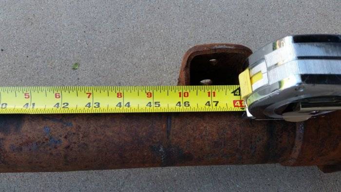

46 CL perch to CL perch (yes the photo is left side to left side but that's the same as Cl to CL, 65-73 B-Body or 70-74 E-Body)

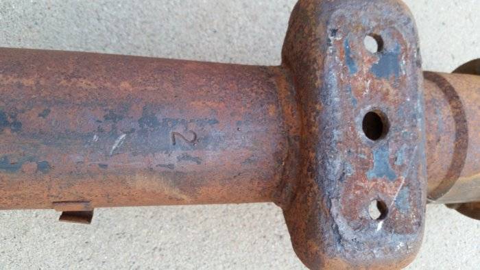

Any thoughts on the "2" stamped next to the perch?
