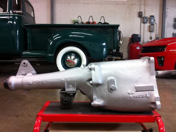

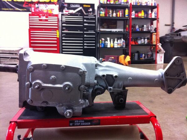

could anyone tell me recommended fluid for my 833 trans. Gear oil or ATF.
Thanks
Steve
