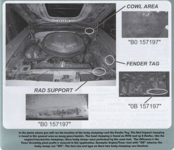

See if it has numbers on the body to compare to the title.
First number should be a "B" the last 6 should be your car number.It should be something like BS23H3B000000.where is the extra number?
Thanks for the help.
I went out to where i have the car in storage and checked under the hood. Found it still has the fender tag on it as well as the rad support #s.
The issue with the vin # looks like someone used a 13 where the second B should have been. Rad support # matches that of the fender tag as well. Called my insurance company and had them make the changes so i have no issues if i have a claim.
