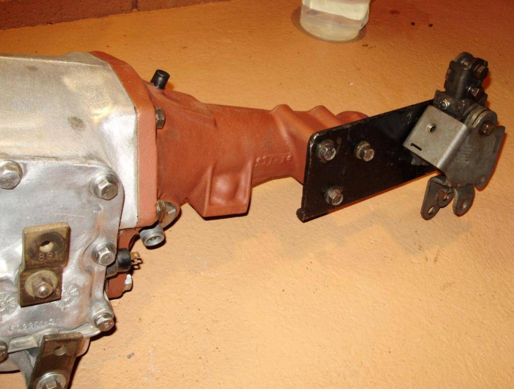

The T/A should have the same number of splines (23) as an A body A833. Only the 440 and 6 Pack/Hemi got the bigger 18 spline. But the extension housing on the gearbox is shorter and the shifter mounts are up closer to the firewall so it will not bolt straight in. Unless you have what i have (see pic) which is an adapter made of 6.3mm steel and locates the shifter into the correct position for E body. However you would still need a longer tail shaft (drive shaft) to fit.
