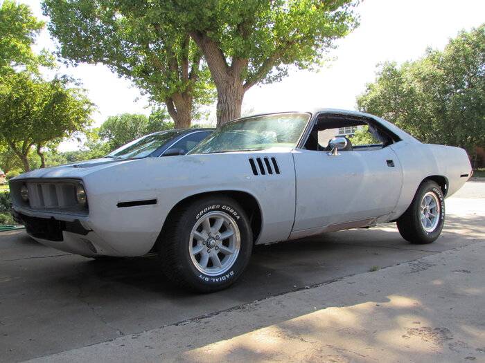

PS. I converted my 71 Barracuda from a 904 to a four speed, so feel free to PM me if you have any questions. Rod
