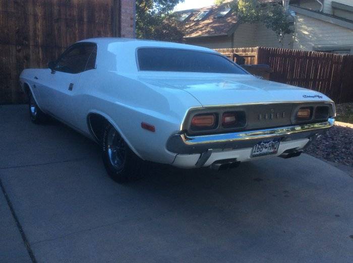

Do you have any pics of how the car looks with the magnums on it? Where do you feel the vibration the most? Is it different on deceleration?

Posted some photos on the garage photo section of this forum - under Frank's garage.

They are tucked way under there, aren't they? Great looking Challenger though. Are you going to replace the housing eventually?

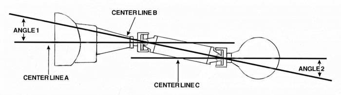

You stated "I have set the pinion level." What do you mean by that?
I have set rear ends up so the pinion shaft centerline is parallel with the transmission output shaft centerline, when the weight of the car is on the suspension. Use an ANGLE FINDER to determine the driveline angles. I set them up at a 2 degree angle. I have set up 4-link suspension and leaf spring suspension this way and they are vibration-free.
A friend of mine chased a slight rear end vibration for years. Turned out the rear end had a bent passenger side rear axle flange.

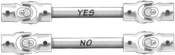

Also, study the diagram below, then look at your Challenger's drive shaft to see how the u-joints are aligned/positioned/welded. The yokes at opposite ends on the drive shaft should have their bores aligned parallel. If the yokes are more than 40 degrees out of phase there will be a noticeable wobble when torque is applied. I built a pro-touring Camaro and installed a 200R4 and 1974 Nova SS 8.5" posi. The drive shaft ended up 3/4" too long. I had read in a racing journal some builders clock the universal joints 15 degrees too preload the driveshaft. I asked Driveline Specialties to do this when shortening the driveshaft. The owner at DS scratched his head and said okay. Worked fine and no vibration. I was curious and it didn't cost anymore.
