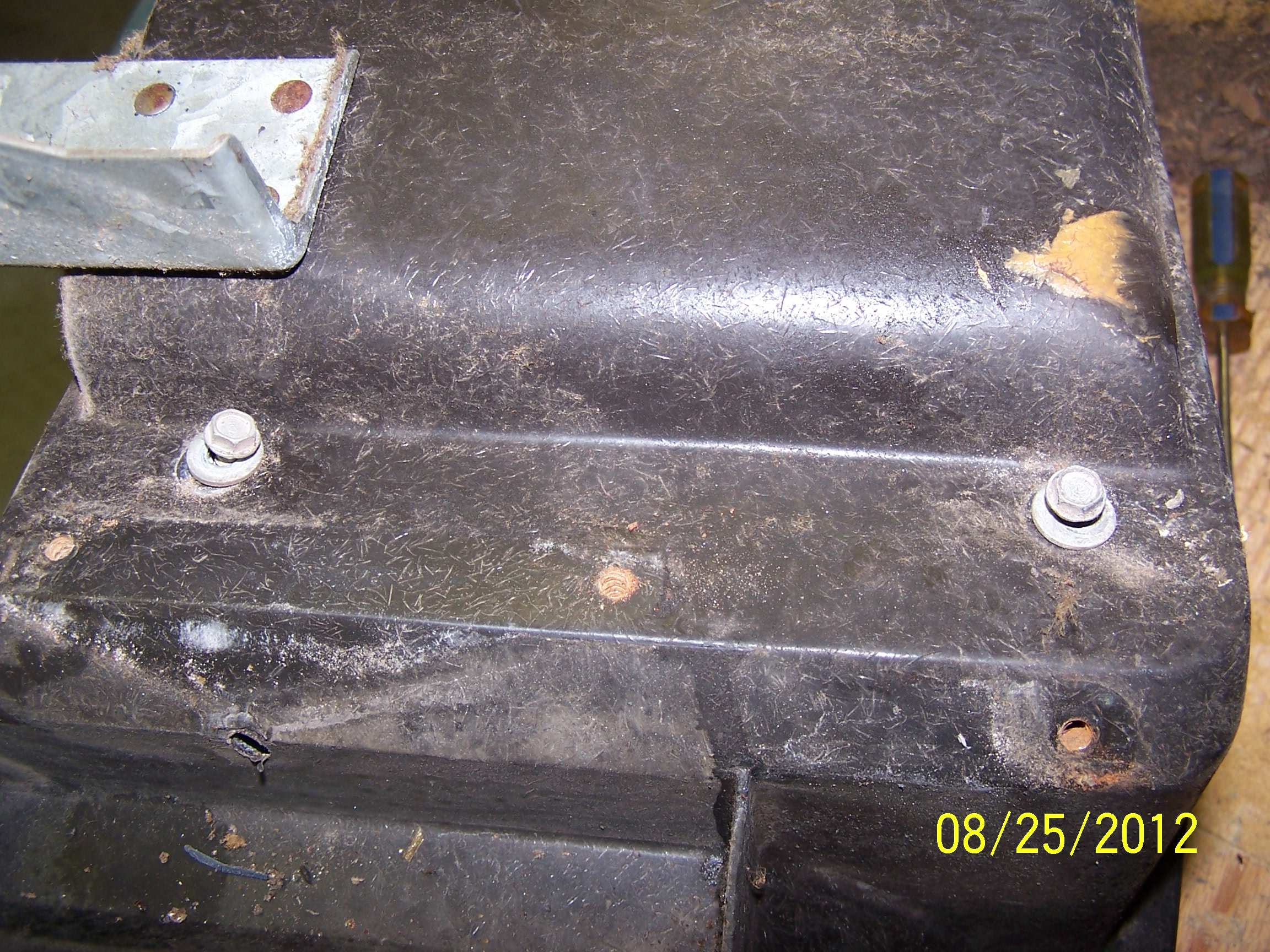

It sounds like your evaporator pan has developed a leak or need some sort of attention. It is not good news but not the end of the world either.

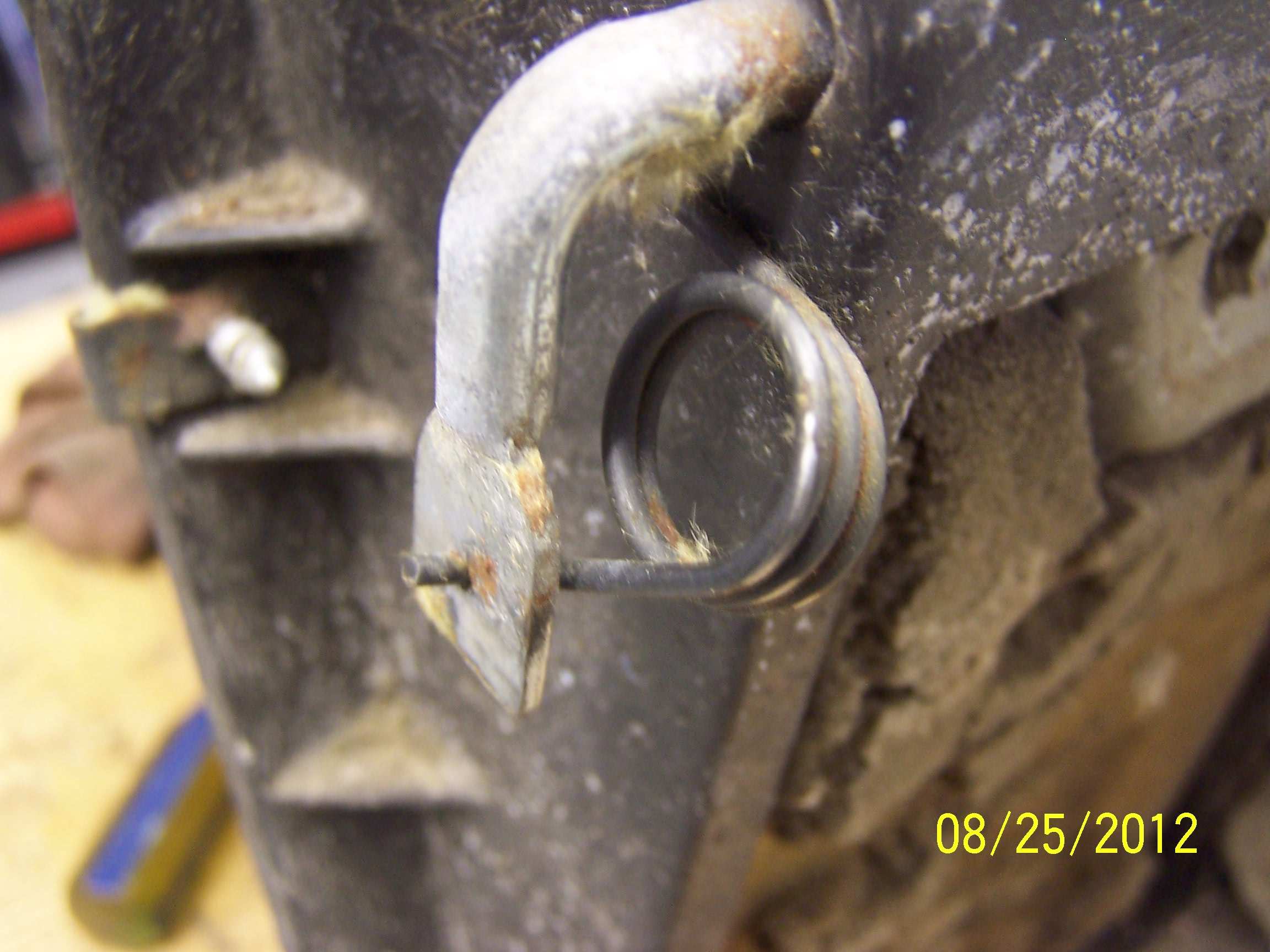

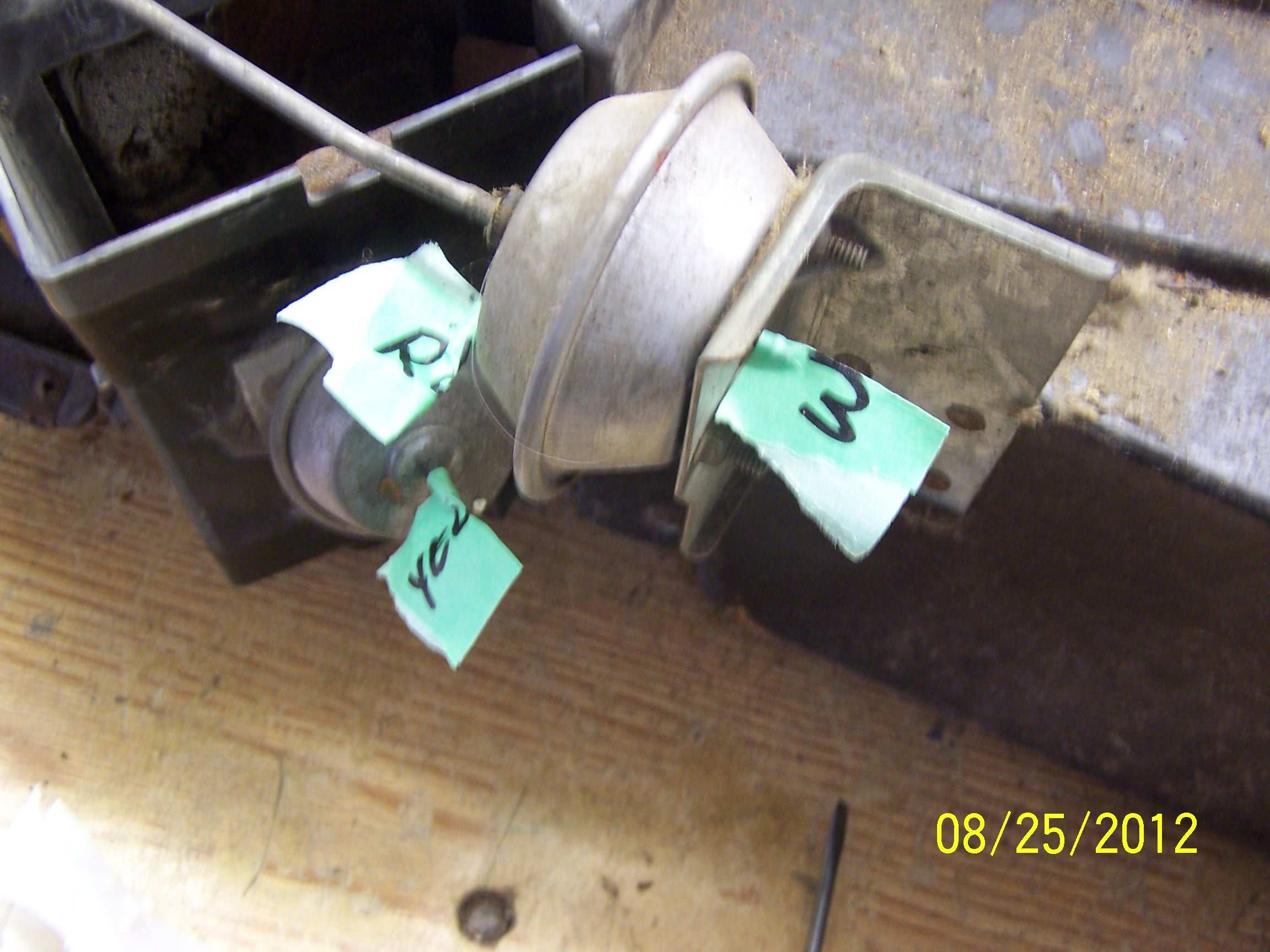

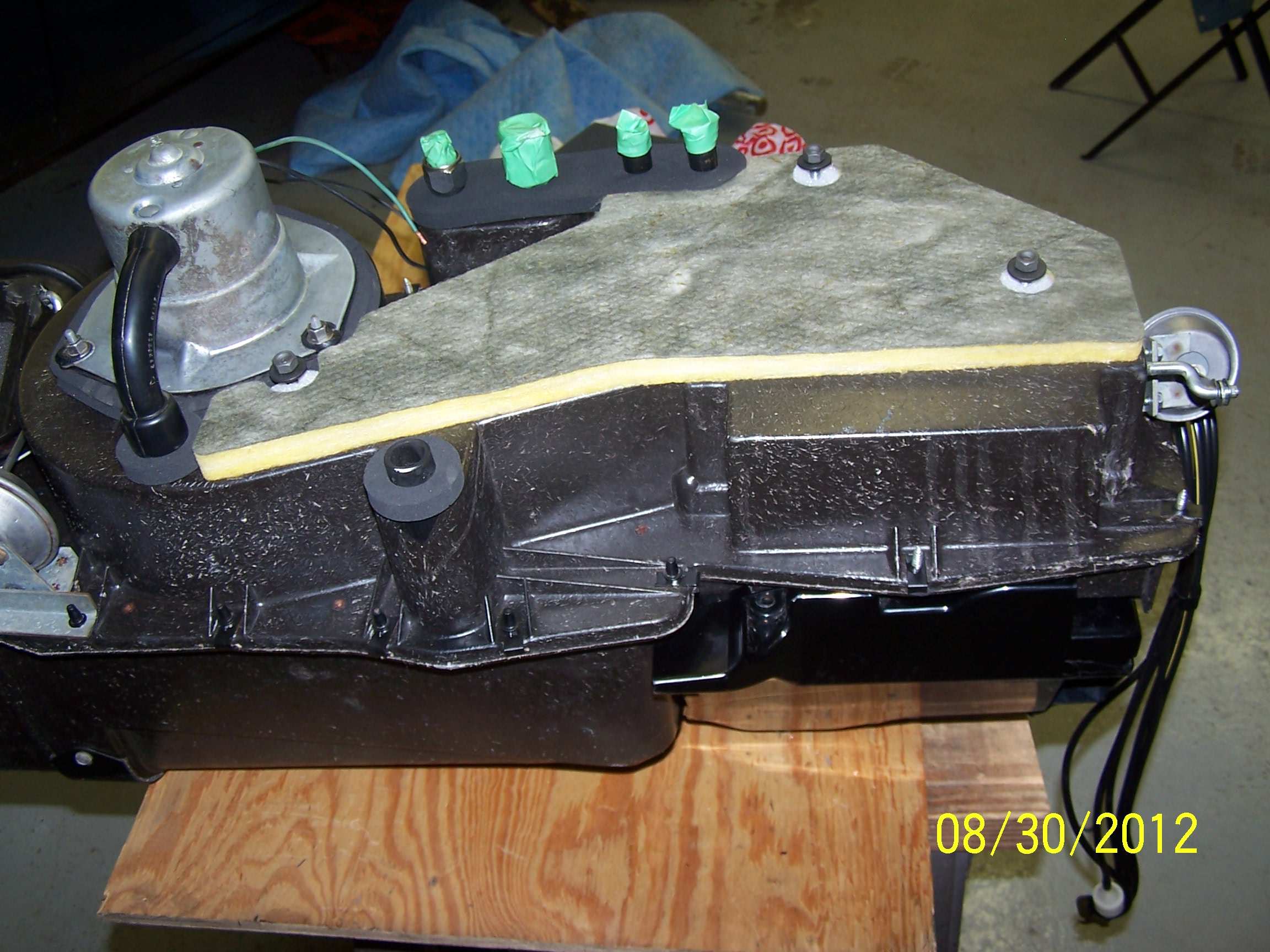

You will have to evacuate or have the freon sucked down first. Then you can begin the task of removing the heater box. It is tedious work but once you unhook the plumbing under the hood for the coolant and AC, you can then remove the heater box nuts from the firewall. The rest of the work is under the dash, removing the duct work and cables. The heater box will come out as a complete unit and will then have to be taken apart to expose the evaporator. If the unit has never been rebuilt, you will want to do it at this time. You can get a rebuild Kit for it on Ebay. Loretta Fillmore at Detroit Muscle tech for around $40.00.

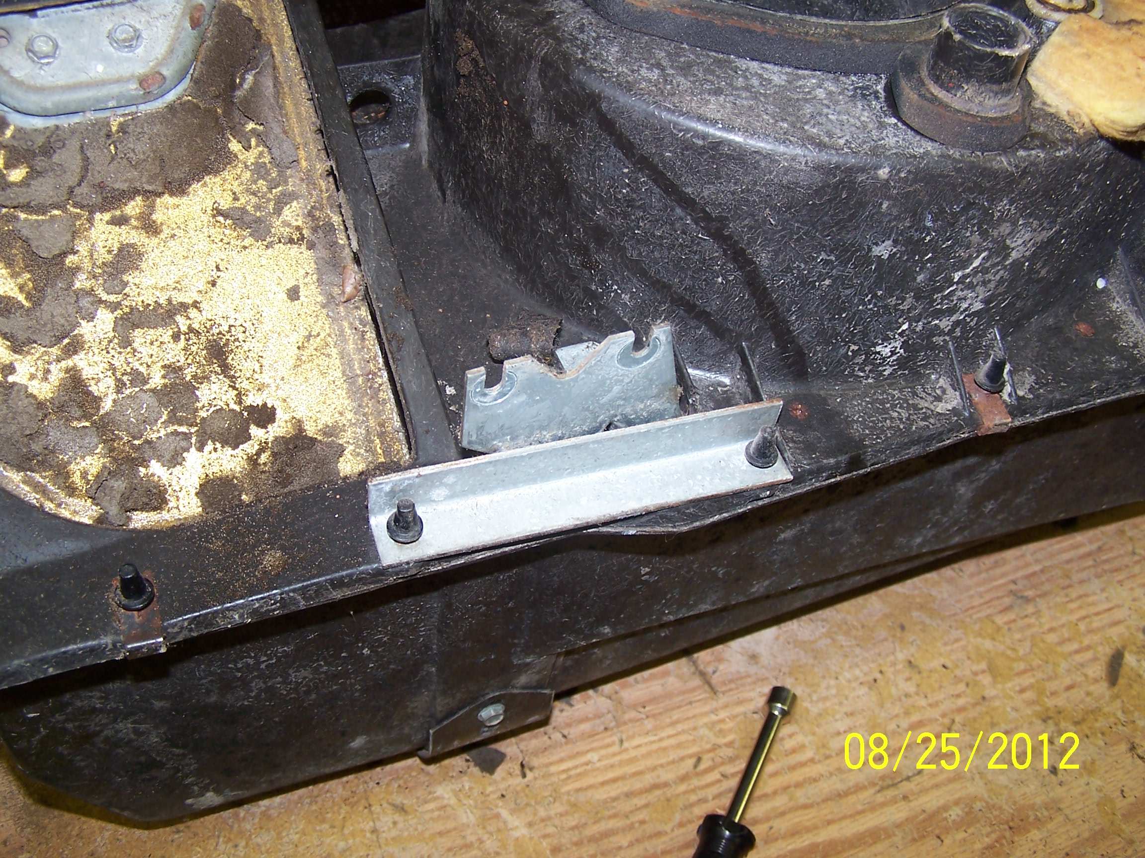

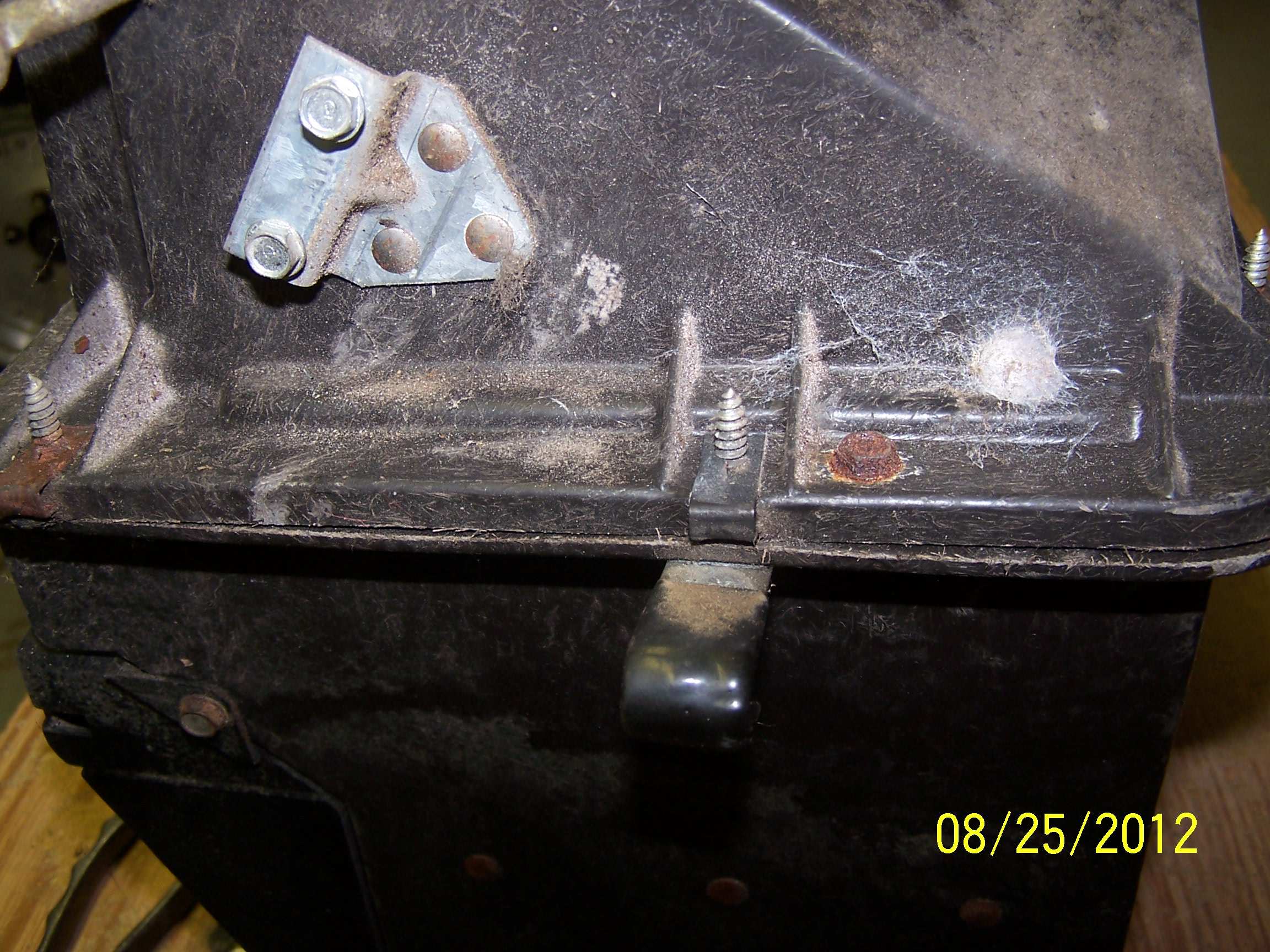

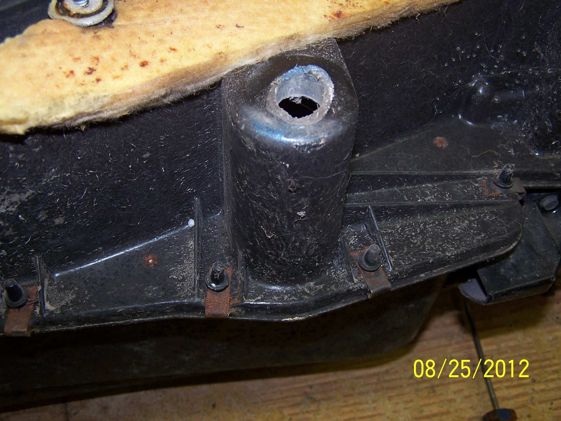

Here are some pics I have from rebuilding my Niece's 70 Challenger.

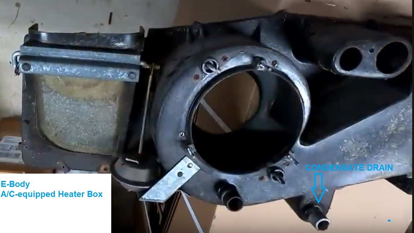

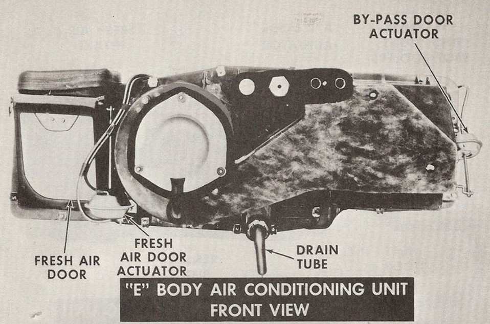

Ray,
I second the shop vac to attempt to clear the condensate drain tube at the firewall in the engine compartment. Hopefully it will clear and allow the condensate to flow down the firewall on the engine side.
--Jeff

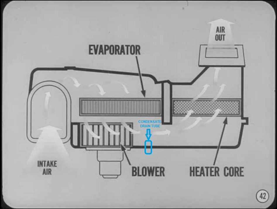

It is possible that leaves or other debris has entered the Fresh Air inlet (intake air) and ended up accumulating inside the evaporator area's floor. This debris can also clog the condensate drain tube. The aftermarket A/C systems from Vintage Air and Classic Auto Air block off the Fresh Air inlet opening to prevent accumulation of debris inside the box. Below is the factory A/C airflow showing how this can happen and block your drain tube.

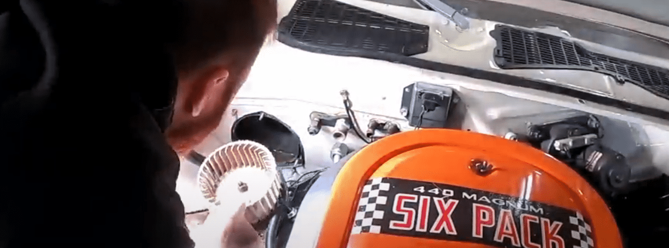

Ray,
Click this VIDEO LINK of a guy taking the A/C blower motor out. He is doing a heater core replacement but at least he shows the A/C blower motor removal portion at 8:36 into the video. He had to remove the A/C lines to get the blower motor out. Hopefully, you will not have to do that on a 340 Cuda.
It looks like you can reach in and clean out any debris at the bottom near the drain hole without removing the entire box.
