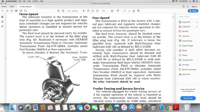

When I used gear oil in Idaho, in the winter, the car would actually move slightly in neutral....crazy. Mopar recommends ATF by the way.
70sixpkrt
Sep 8, 2009
61
S.F. Ca
Depends on the temperature.
