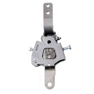

With the shifter in Neutral & all the levers in the shifter centered there is a U shaped notch in the bottom of the shifter , you can as above use a small allen wrench & slide it through the U shaped notch & all of the levers & then adjust all of the rods to the levers on the side of the trans so everything is sitting centered , you can see the small hole at the bottom , it is a brighter white .

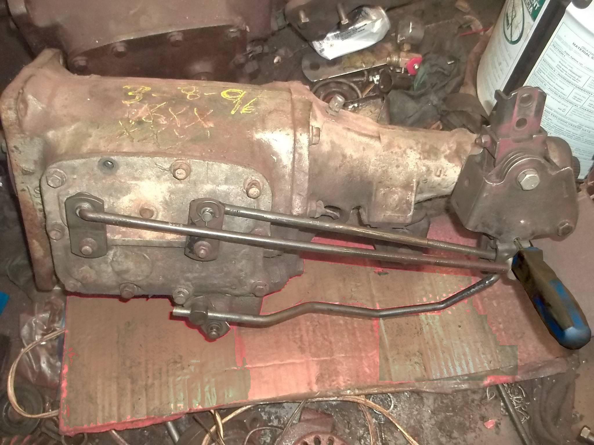

When aligning the shifter arms, make sure whatever tool you use is all the way through and fully seated in the "saddles" on either side of the shifter housing.
Last year while setting up the shifter in my Valiant, I found out that an M6x60 bolt is literally the perfect Hurst shifter alignment tool. It's far better than any allen wrench and even better than the Hurst one you should've received with your new shifter. It's a flawless fit in both diameter and length.
This photo shows a screwdriver being used as an alignment tool on my garage floor (there's no room for this under the car). You can see the "saddle" in the shifter frame where the screwdriver's shaft vanishes. I "highlighted" the screwdriver a bit in PhotoShop.
