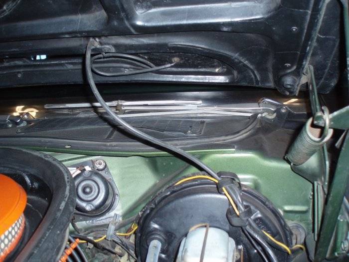

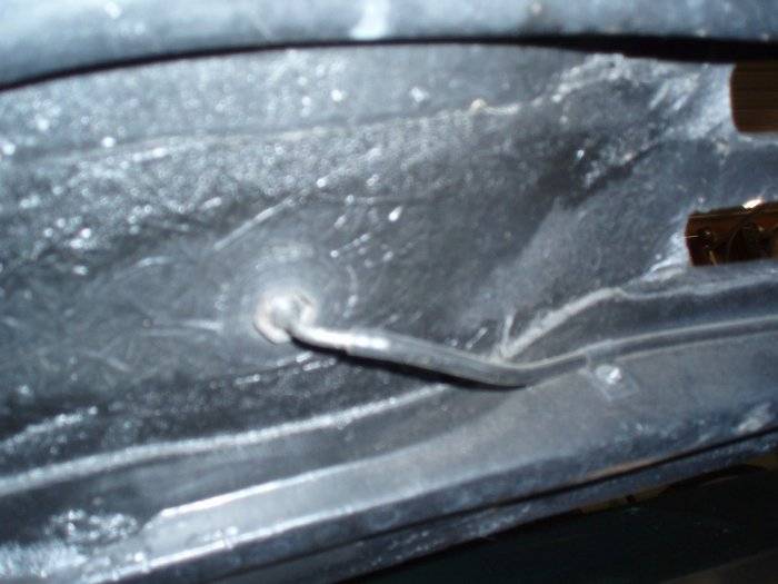

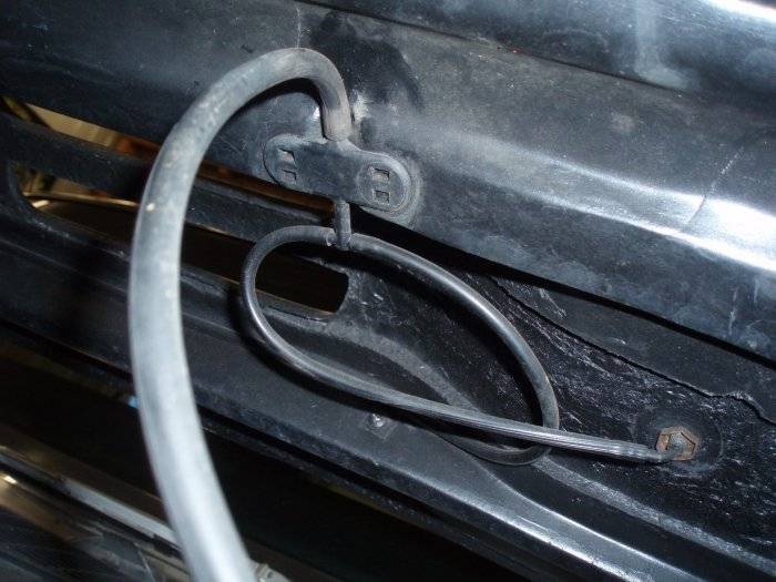

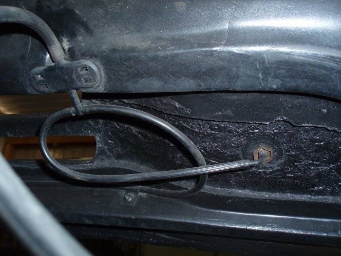

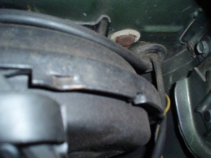

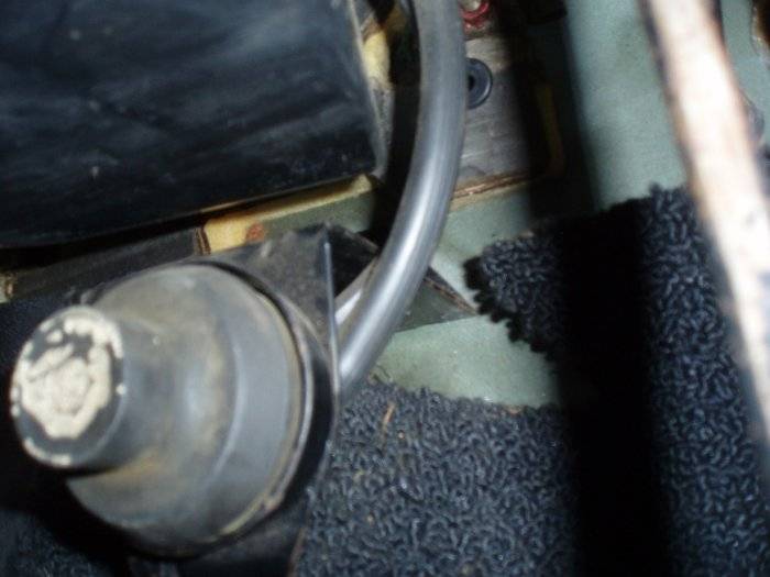

Can someone show me some photos of underside of hood were and how the hose system is for my windshield squirters and were it all goes on the hood or a diagram thanks in advance

Hope these photos i just took are a help. This is my survivor AAR manual washer hood hosing. All hoses and fixtures are 100% original and never taken apart since new in 1970. I have a very good friend that lives in Dunedin, N.Z. , Cheers, Slade.

Here you go, if you need any other photos let me know. I had to replace the original washer bottle last fall as it finally got so brittle it cracked from age. FYI; The AARs used the 1971 style washer bottle with the round top corner.
