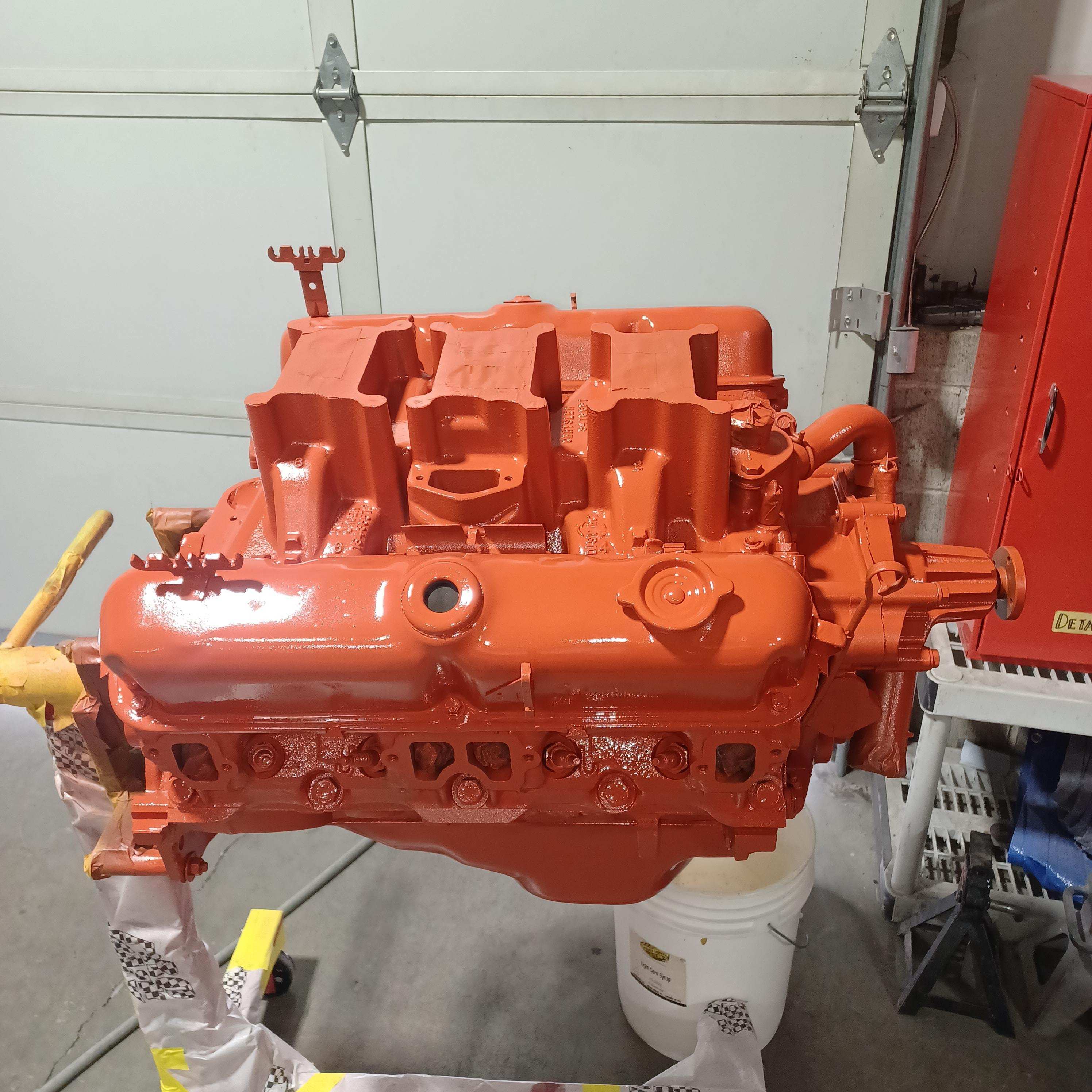

I purchased an AAR that was missing the original engine. A T/A block is a bit out of my price range. I have the original carbs but no intake.
I was hoping to get a good 340 block and some J or O heads and sit the 6 pack setup on it. Is there anything special that I need to know? Are the ports different?
Thanks in advance.
