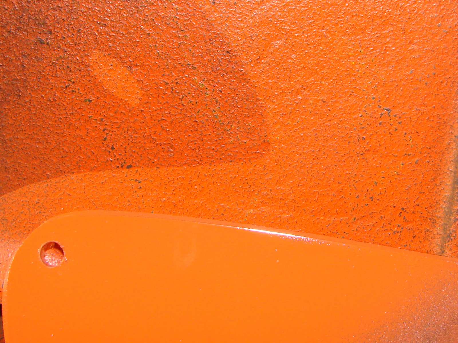

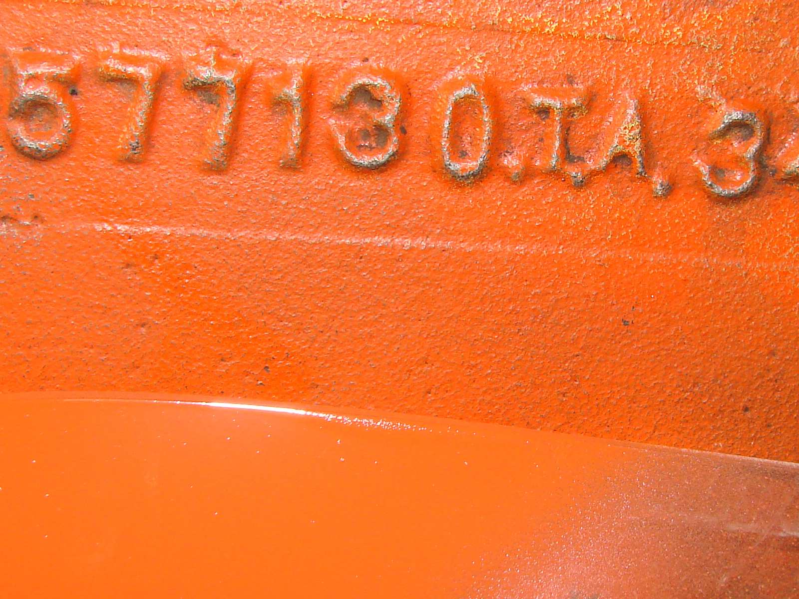

Every TA block I've seen were painted orange. The AAR Cudas and T/A Challengers used a special TA block part number 3577130-TA-340. Webbing around the crankshaft is thicker than the other 340 blocks. It wasn't until late 71 that the 340 blocks were painted blue.

All T/A engines are Street Hemi Orange. The early Hemi race engines had a lighter color "Hemi Orange" called Race Hemi Orange.
