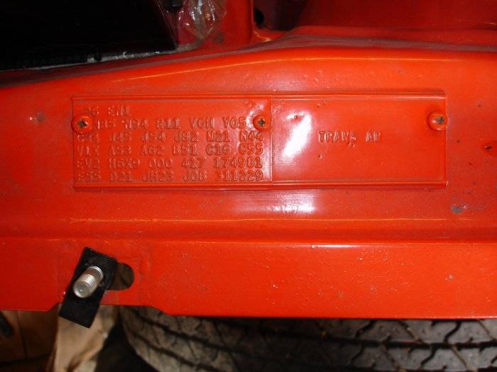

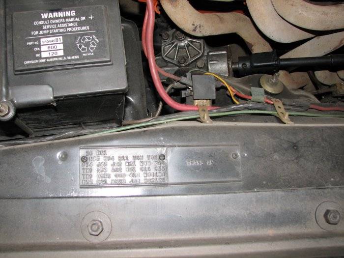

Additionally, on the fender tag there should the Code A53 for the Trans Am package
and a tag to right of the code tag that says "Trans Am".

You are correct but:
A53 was the Trans Am option code
E55 was the 340-6 engine code
A53 70-71 Trans Am Package
E55 70-71 340 cid 3x2 barrel V8 290hp and for the 340-4 barrel engine
Both would have been listed on the code plates
**Plate picture again courtesy of Barry Washington
