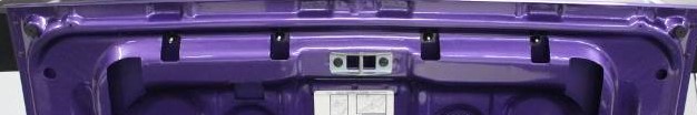

Hey Guys,
I have an original deck lid that I want to mount an AAR spoiler to. The trouble is that I need to cut out the holes for the brackets.
Can you guys post up some pictures of the underside of the decklid with some mounting pictures?

This thread and picture may help.
AAR Rear Spoiler Location

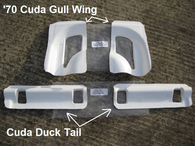

There's templates to locate the underside cutouts.
