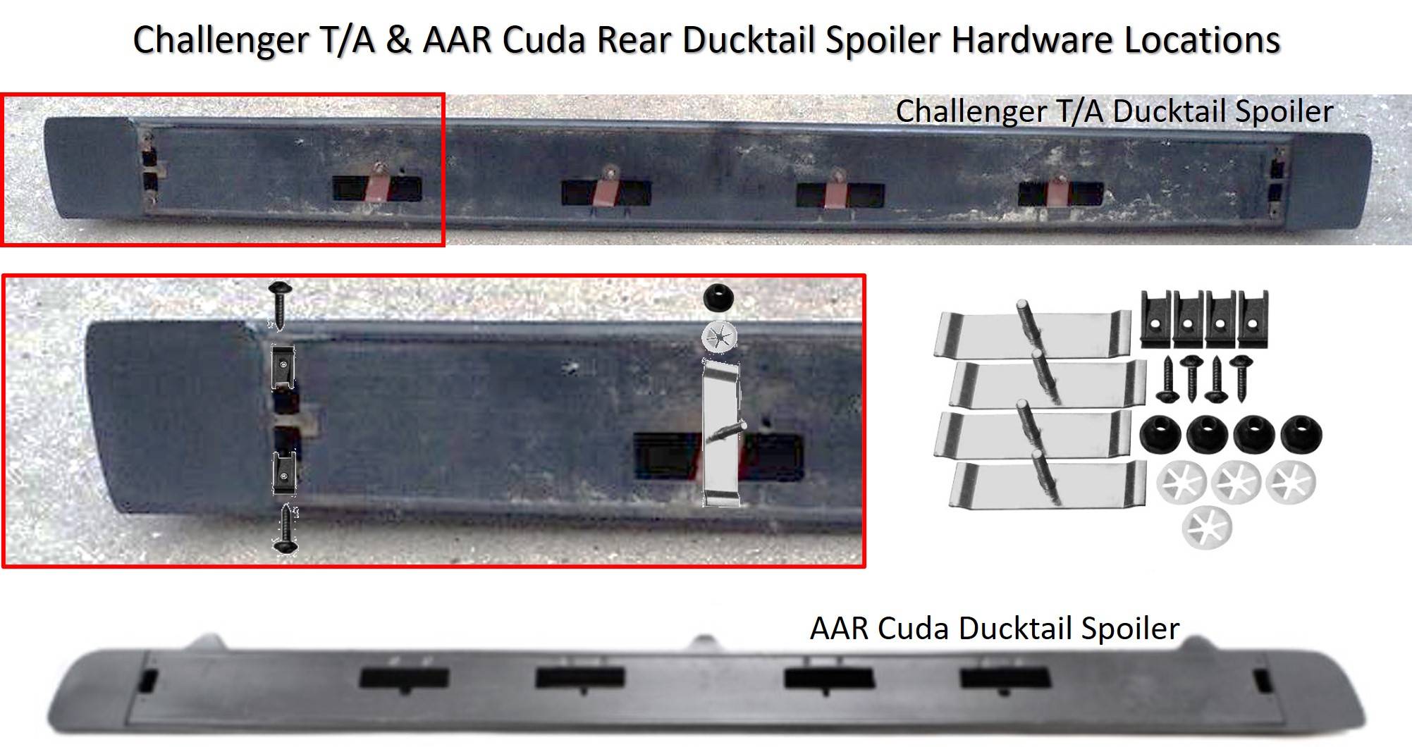

Anyone have a diagram or instructions for the mounting of an AAR Spoiler? I have all the hardware but want to make sure it's mounted correctly.

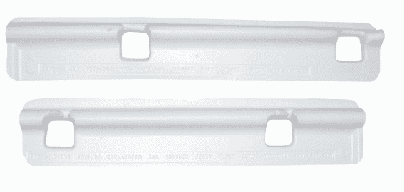

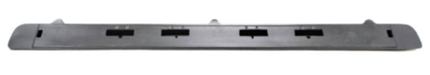

Try these posts.
AAR Rear Spoiler Instructions
Hardware mounting locations for rear ducktail spoilers
Templates for duplicating Cuda decklid square cutouts to mount AAR ducktail spoiler. The below are images for the T/A-version templates. Cuda templates are similar.

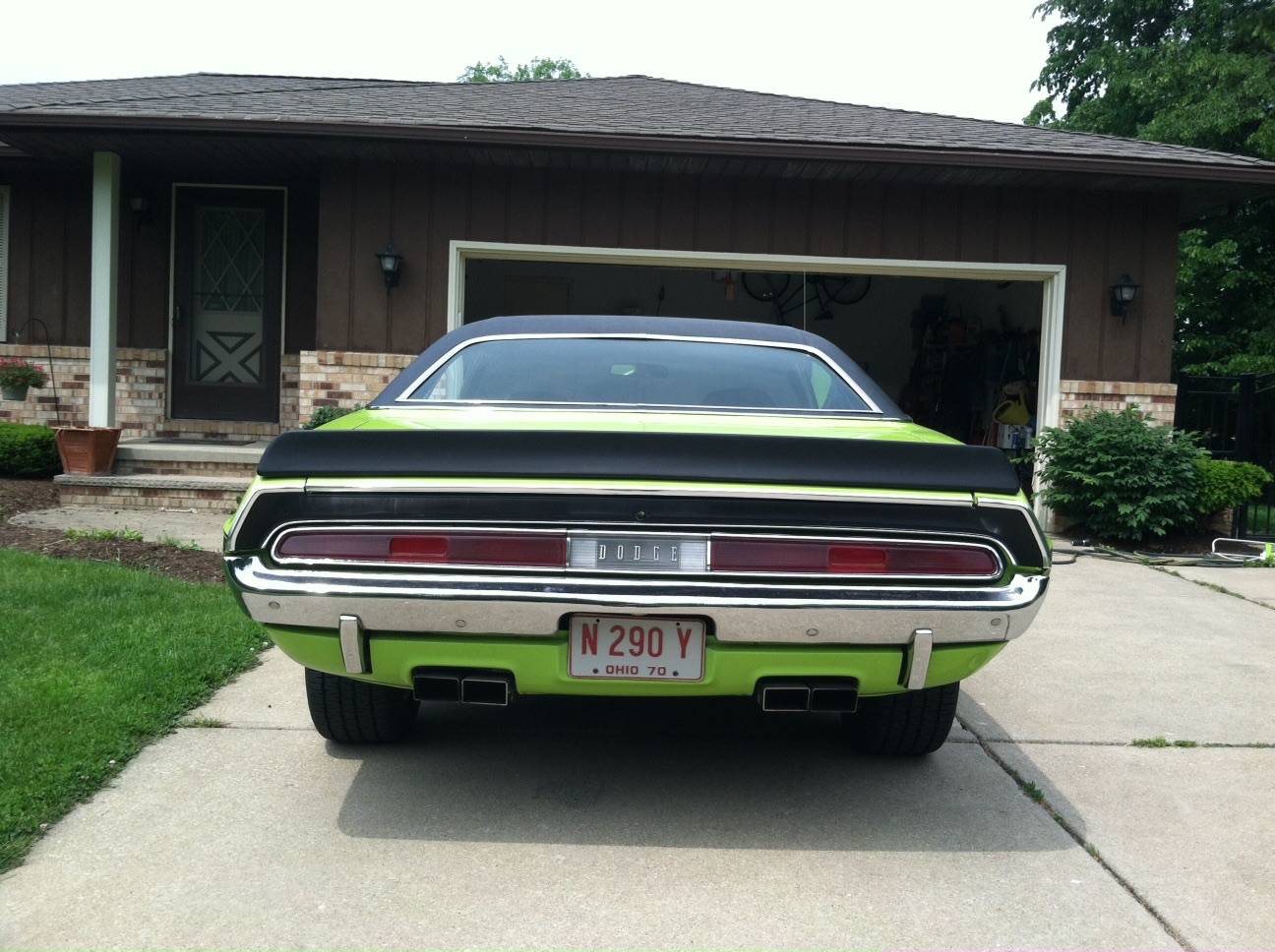

I don’t know if this will be of any help. When I had my T/A spoiler installed as to physical position on the trunk, when looking down from the top about 1/4” of the trunk is visible. When looking straight from the rear of the car about 1/2” of the trunk is visible. Both the body shop and myself found this location independently of each other. Very happy with that position on the trunk. Naturally, I don’t remember where I found it. It’s been installed 10 years ago. For the TA from the factory the trunk has a 1 1/2” strip painted black. Don’t know about the AAR.
