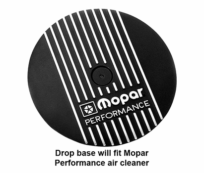

My rebuilt 360 is in the engine bay, and the rebuilt Thermoquad is on. Aftermarket intake manifold but it’s not really that tall. Issue is the hood needs about another inch to close completely, with either the Mopar Performance black air cleaner or the stock Chrysler air cleaner. Suggestions for a really low rise cleaner?

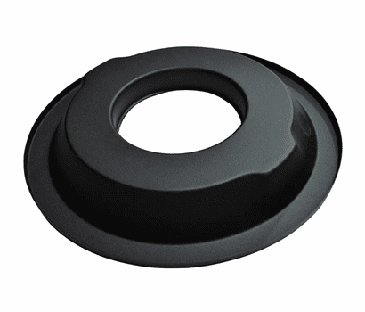

Mancini Racing sells a drop base for the Mopar performance air cleaner.

Yeah, it’s the manifold. I bought a drop base and all is good now!
