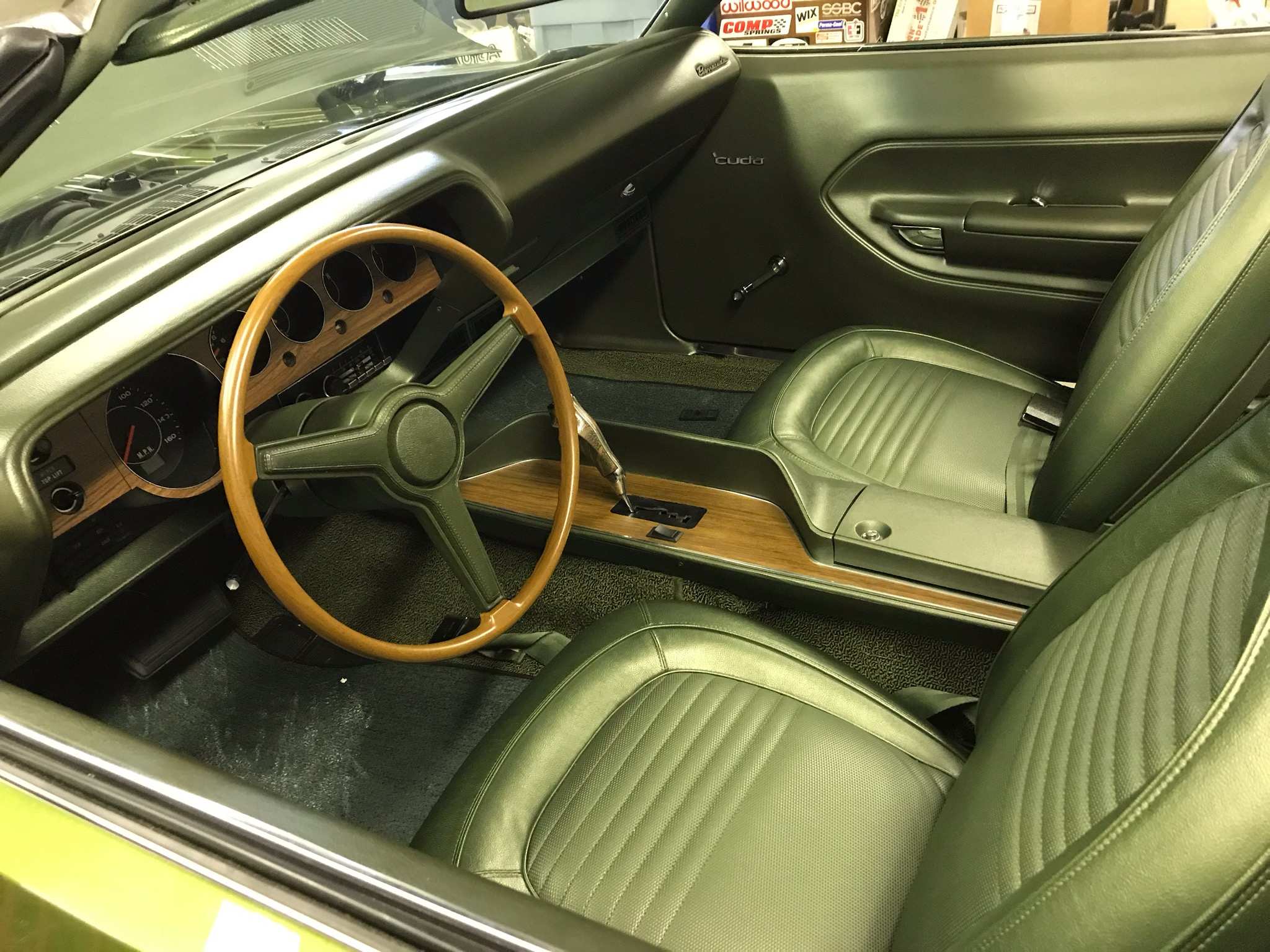

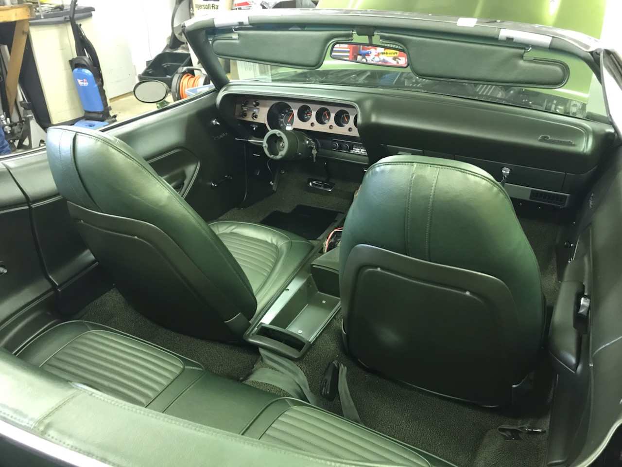

Vinyl coated dash, door panels, seat backs and kick-panels......
mmissile
Dec 26, 2013
1,137
354
Macomb County Michigan
Just Dashes. Apply a large CC payment or check. I had this stuff done over 20 years ago [sat in storage]. I can't imagine the cost today.
Virtually nobody notices why my interior looks so much more finished.
