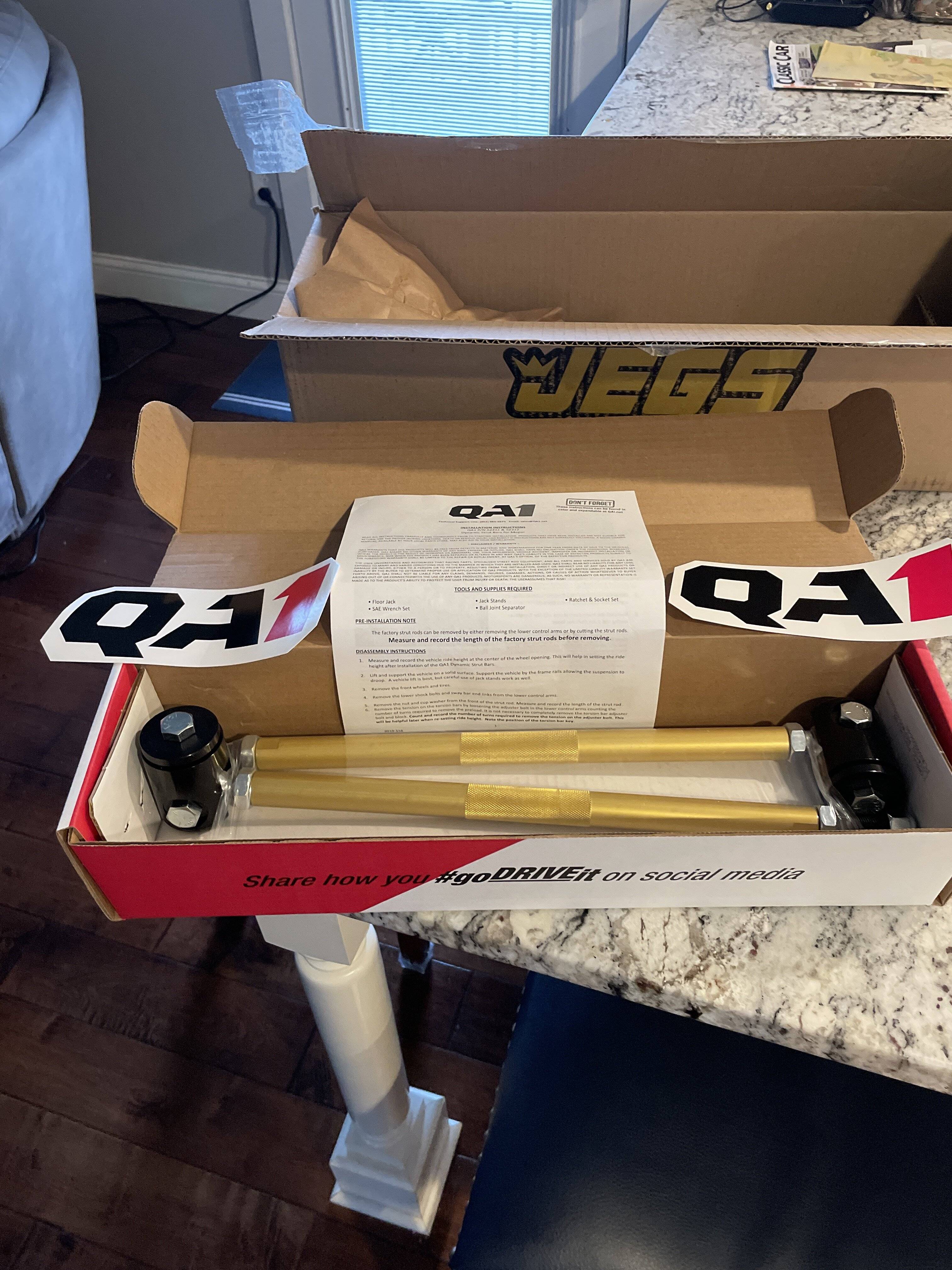

Today my second foray into QA1 front end improvement arrived. Strut Rods. I was so impressed with the UCAs, I wanted to go further. I am looking for advice from the group. Since I’ll have the torsion bars loosened, should I replace those too? Will it make that much of a noticeable difference for street driving? Any suggestions? Trying to decide whether to rebuild steering box or install new torsion bars.
