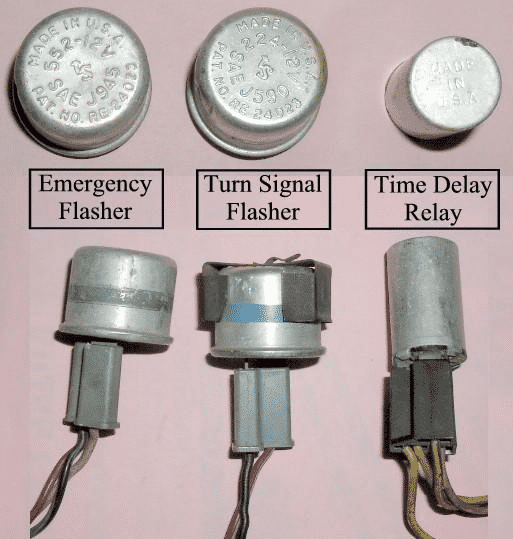

If you haven't altered the wiring, and if it was working fine for a length of time, prior to failure, my guess is the flasher relay. They ARE a mechanical relay 50 years old, or so. The turn signal switch in the steering column, would not typically fail in both directions.

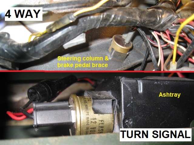

If I put my head on the passenger floor, and look up, I can see the turn signal flasher relay on the side of the ash tray. It's very light weight, and only held there by the clamp with friction. Just give it a tug, maybe a firm one. Or, lift it out along with the bracket. Note in the image, the bracket as a little tab behind it.
