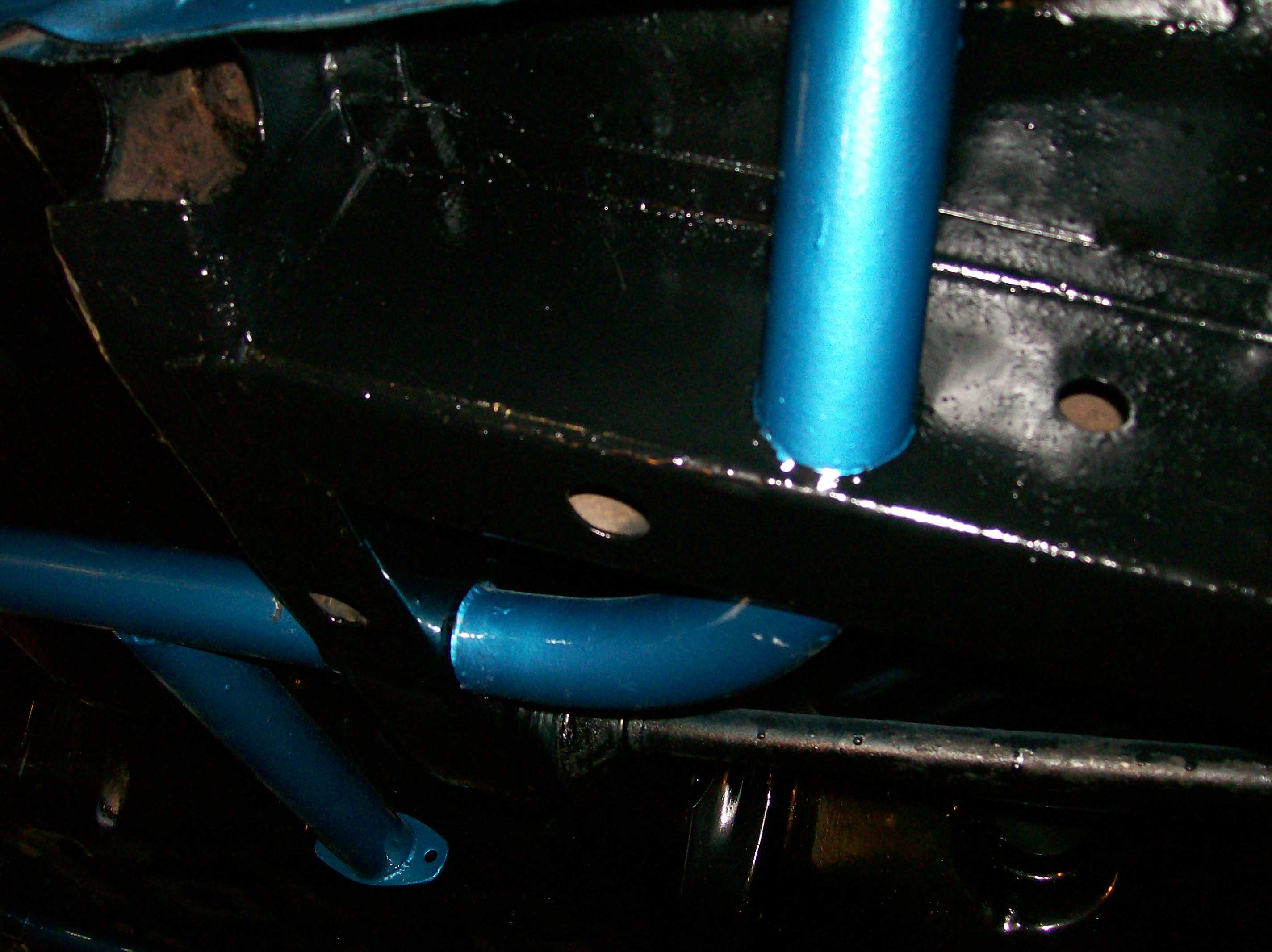

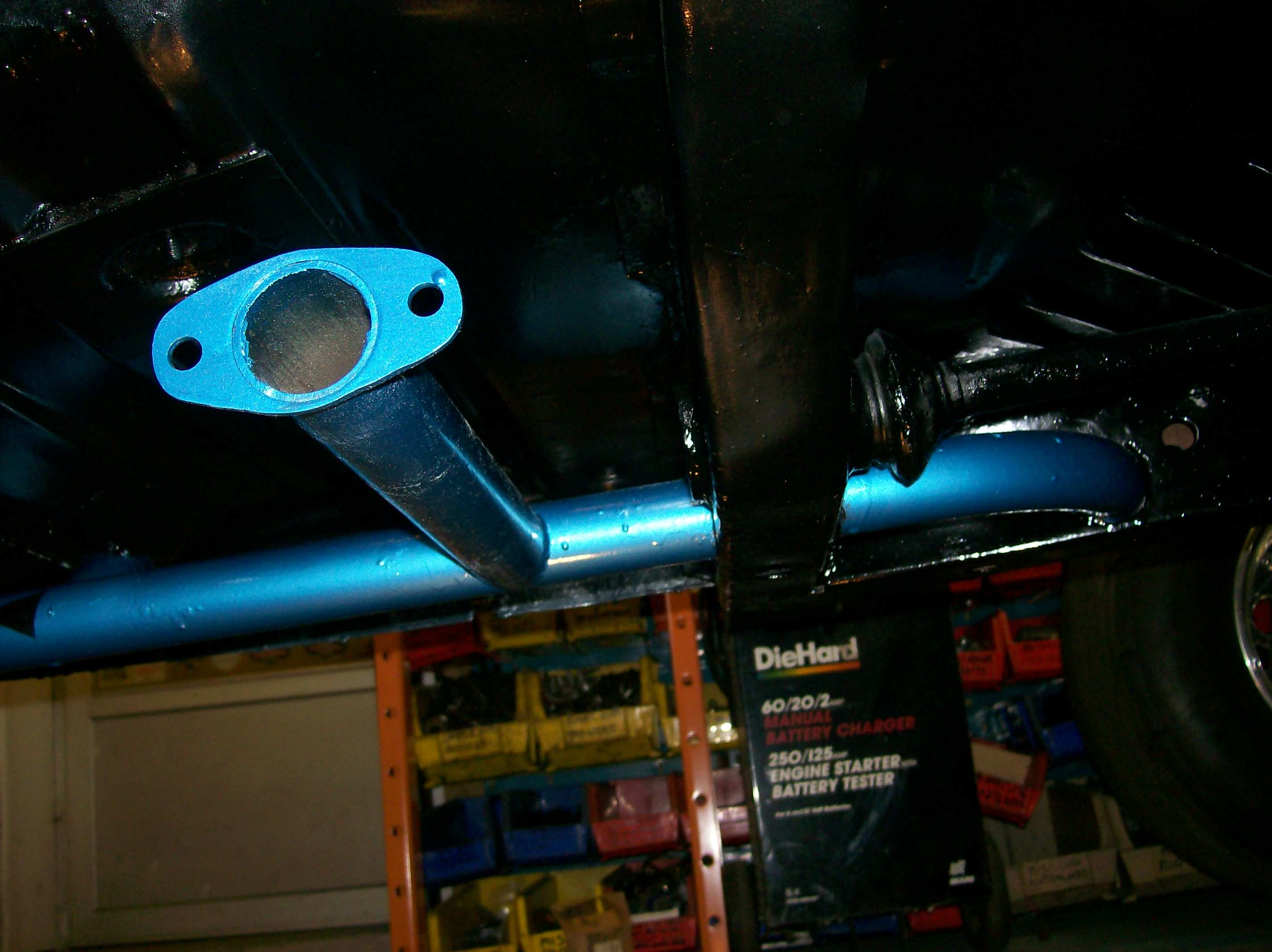

Many years ago I purchased a set of "Bolt-In" frame connectors from Mancini racing,
Had tabs added to bolt them at torque boxes and put steel sleeves inside the frame rails
so as not to crush.
Mine are chromoly tubular and go through the torsion bar cross mount and tie into the front frame rails. However, I also have a full cage as well.
