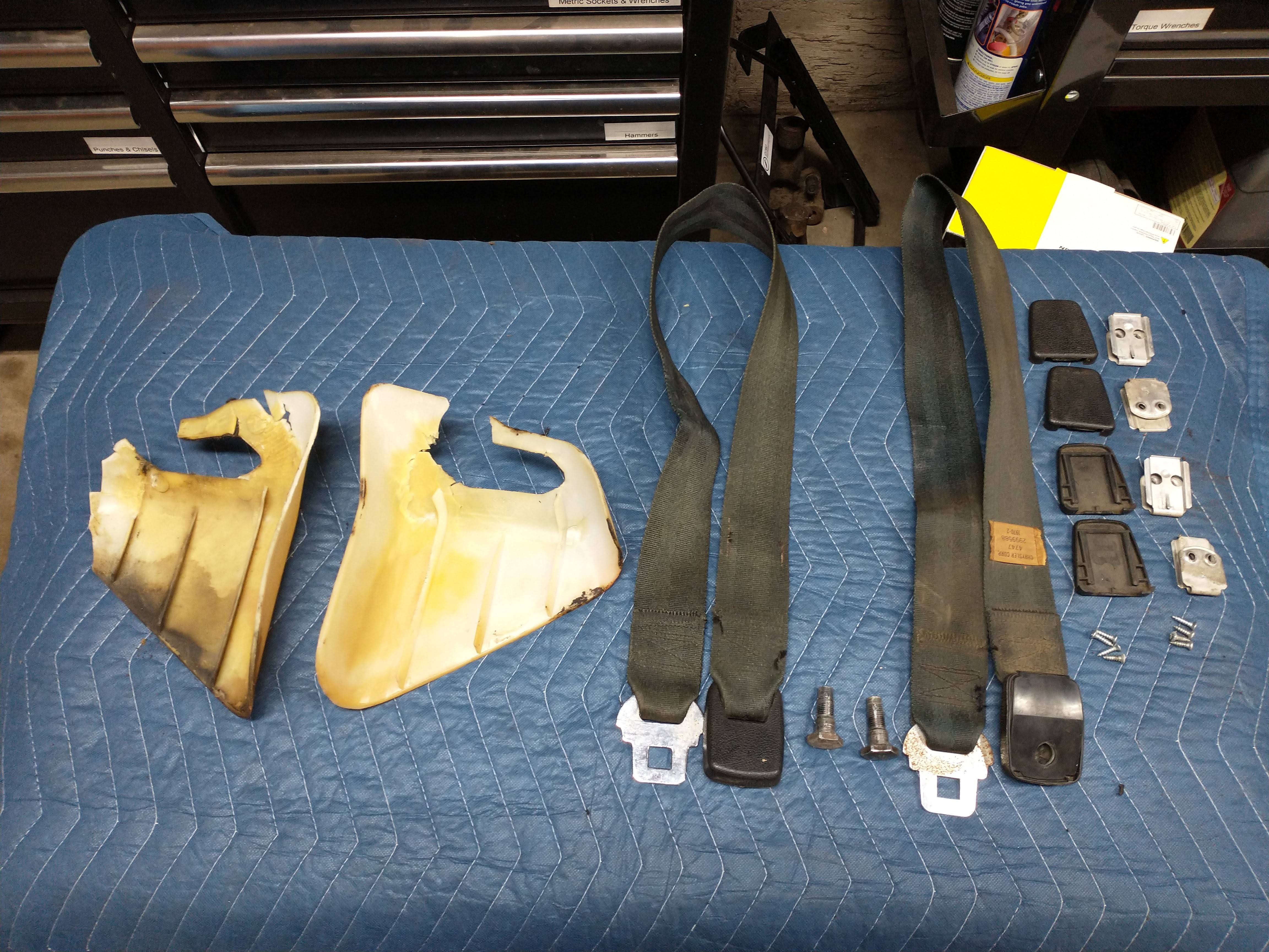

I put ACC carpet in my 70 Cuda years ago and it fit fine. I just recently replaced it with a new ACC carpet and it also was a good fit. Since you're dealing with a 70 Cuda, do you have the factory seatbelt anchors that are under the carpet? 70 was the only year they did that. The 70 carpet has a bulge molded in to go over the factory plastic seatbelt retractor covers. I have aftermarket retractable seatbelts so I used the 71-74 carpet in my car both times.
I removed the factory seat belt anchors and plastic covers and ordered aftermarket 3 point shoulder belts for the front bucket seats.
Here's what the factory belts look like.
Stock Interiors list 3 different part numbers for 70, 72-73, and 74. You can see the difference between them in the photos on their website.
The carpet goes over the seatbelt retractors in the 1970 Cuda. For 71-74 the retractors bolt on iver the carpet.
So, if you are restoring a 70 Cuda order carpet for the 70. If you don't plan to us the factory seatbelts then order carpet for 71-73.
