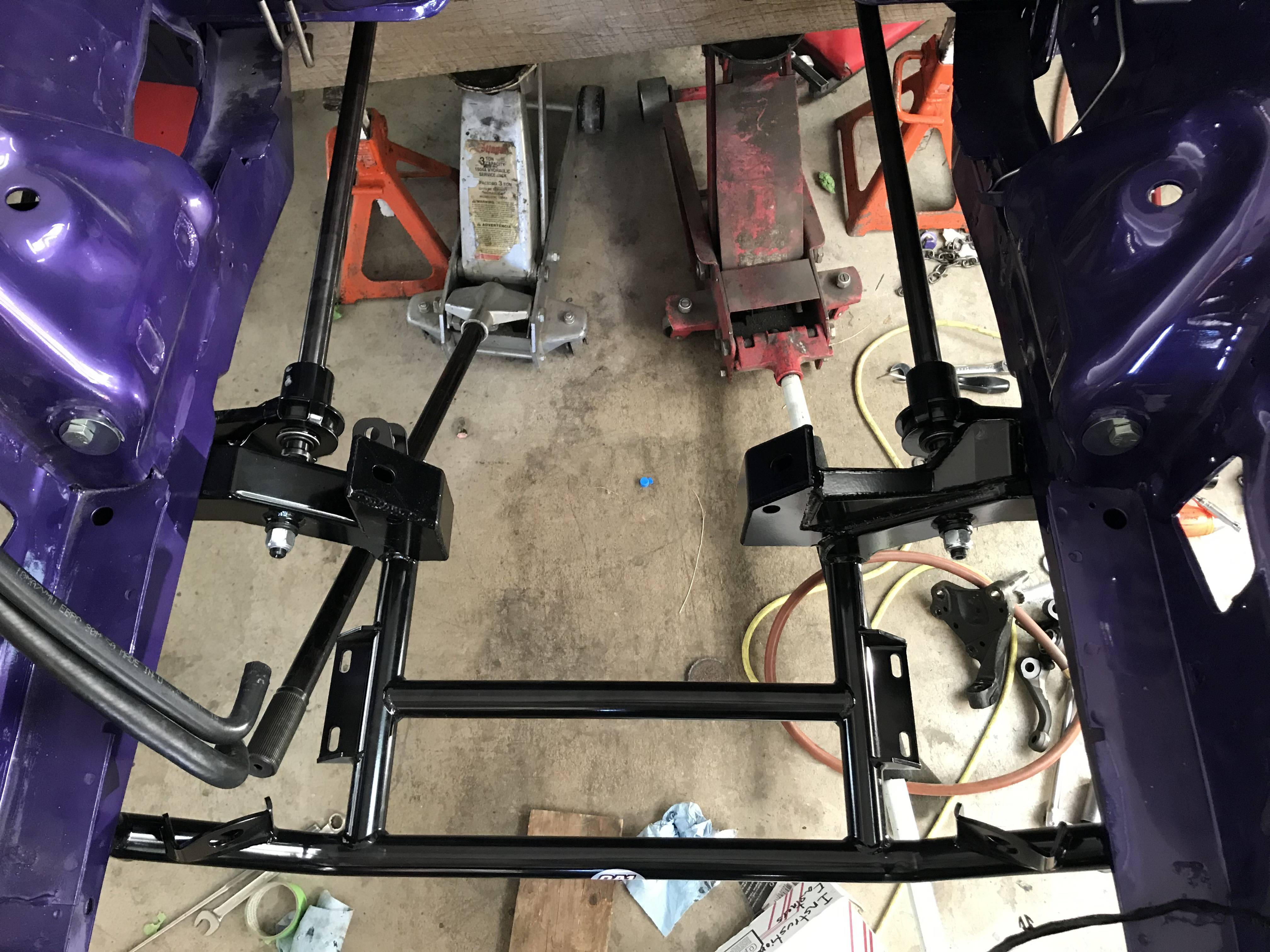

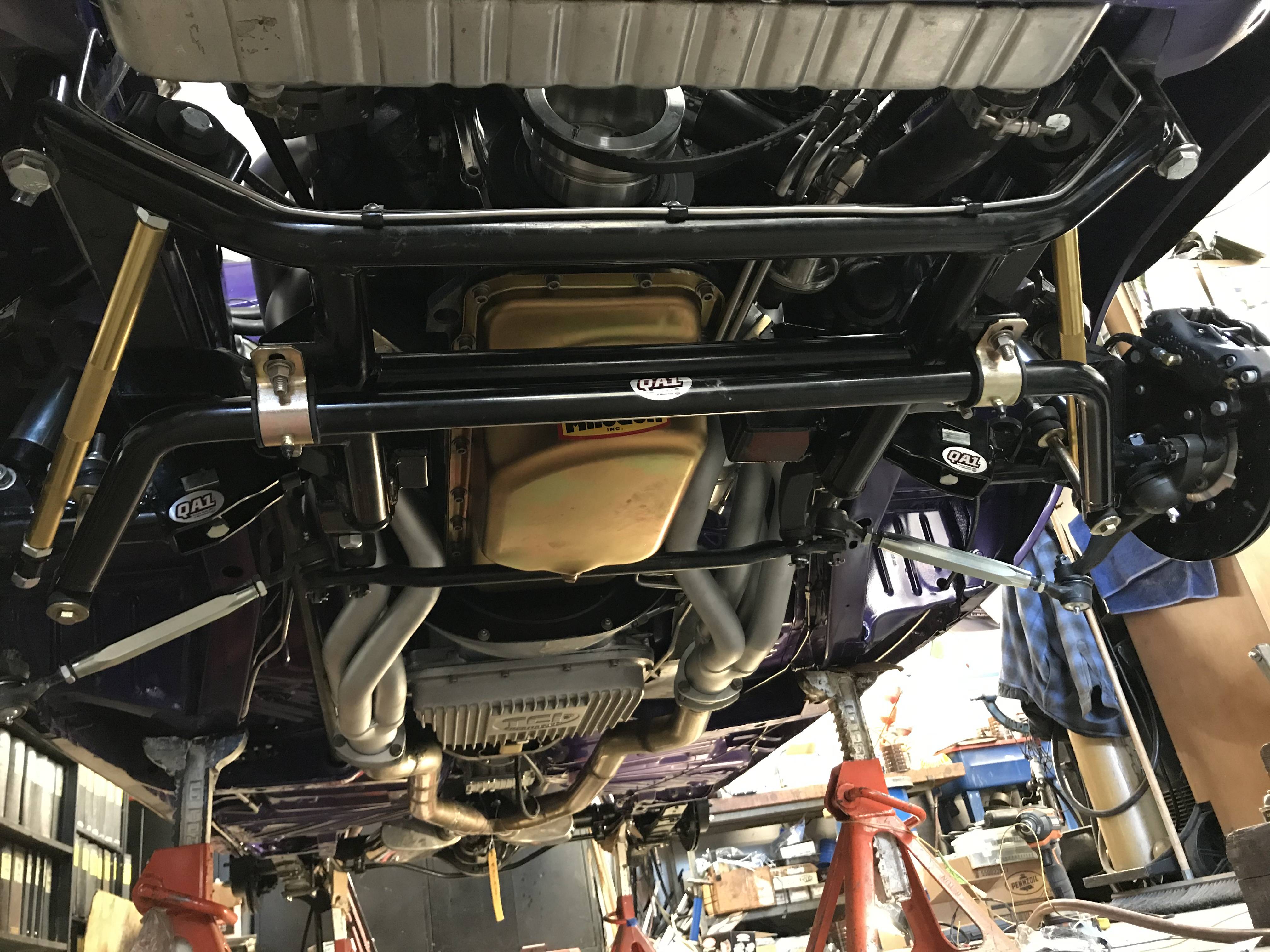

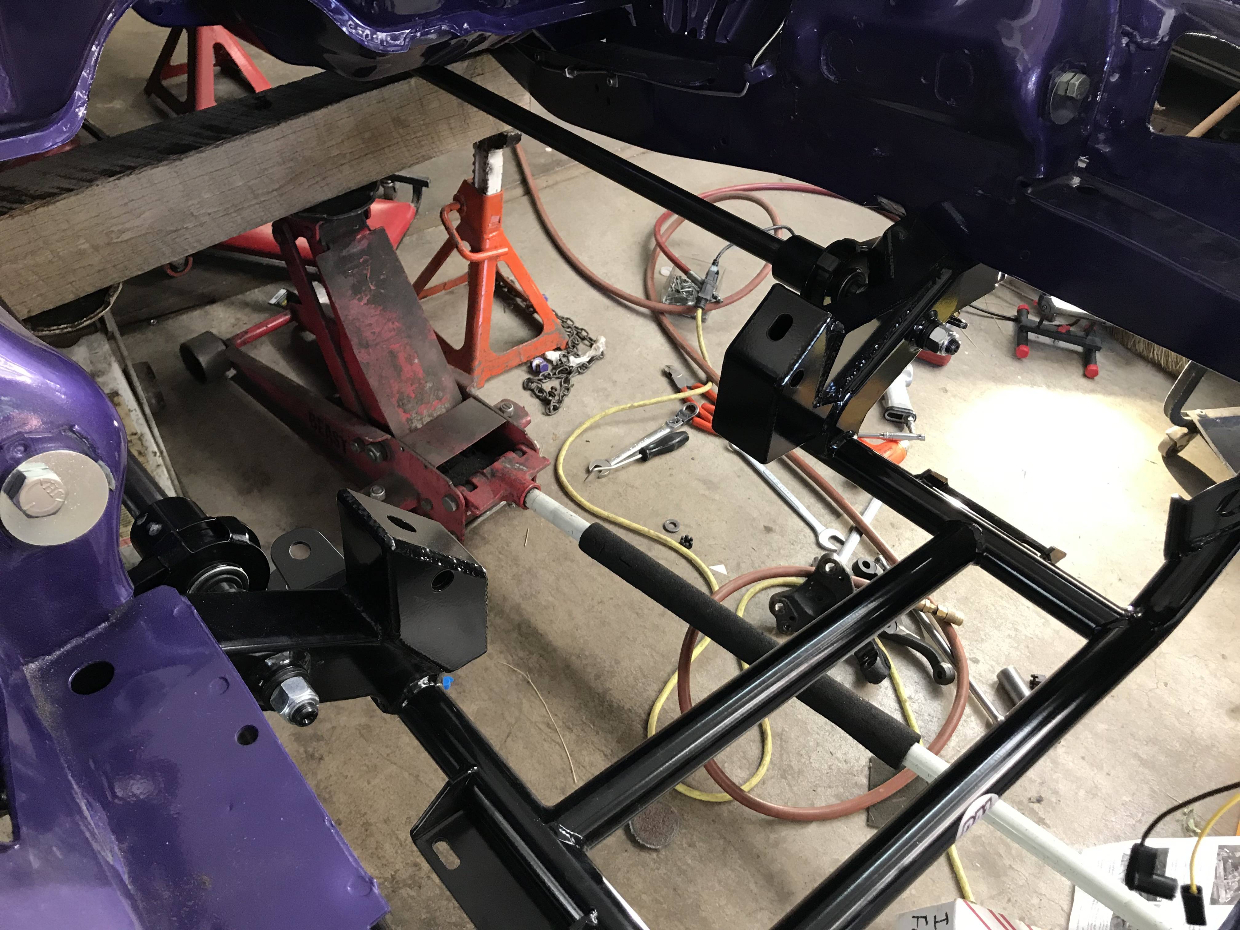

Templates of any type will be tough to come by. The best you hope for is accurate dimensions from one that hasn’t been butchered.
Here’s a few clean photos of a Qa1 in my Cuda. Best of luck with your installation.
