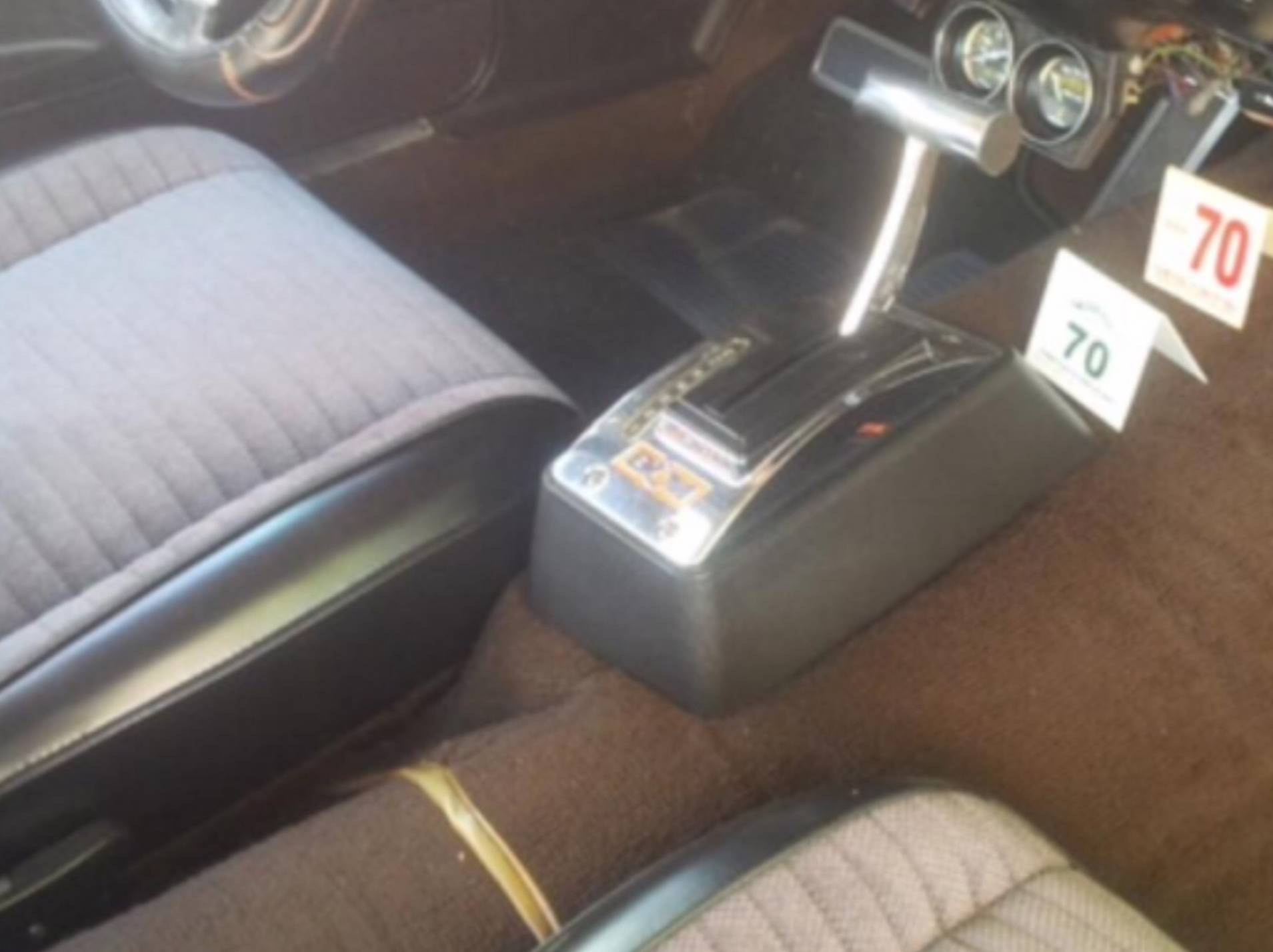

I used the B&M QuickSilver in shifter in my ‘70 Challenger. It works great for a ratchet style shifter and is easy to operate. Thanks, Al
