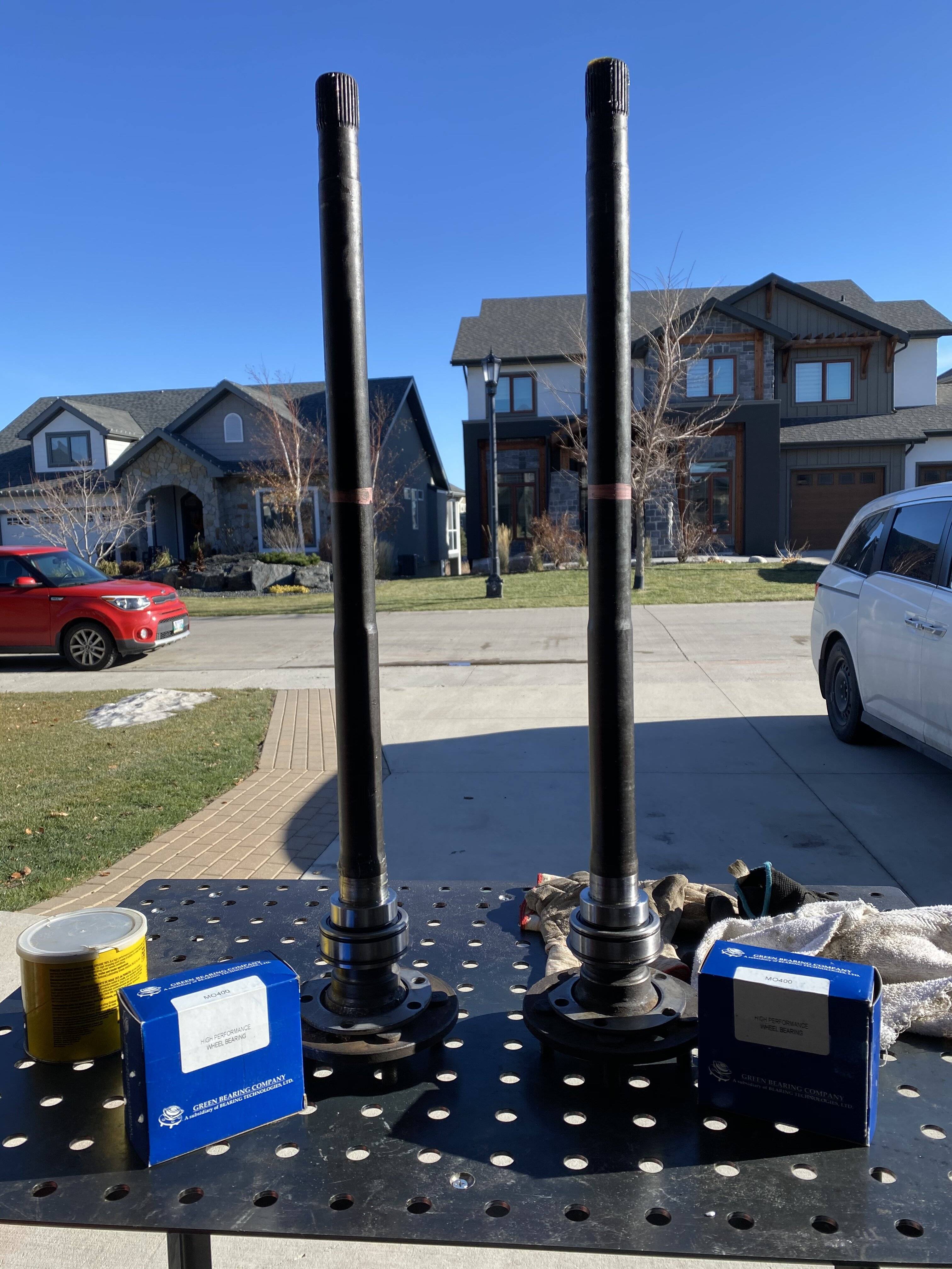

I bought a 8 3/4 rear end housing and axles. I'm going to replace the bearings with the sealed Green bearings. Since these bearings are sealed, do I still need the outer seal? Or, do I just need the seal that is installed in the housing? Thanks.

I agree completely , don't waste $$ downgrading the Cheap green brgs , the tapered roller are a far superior design .

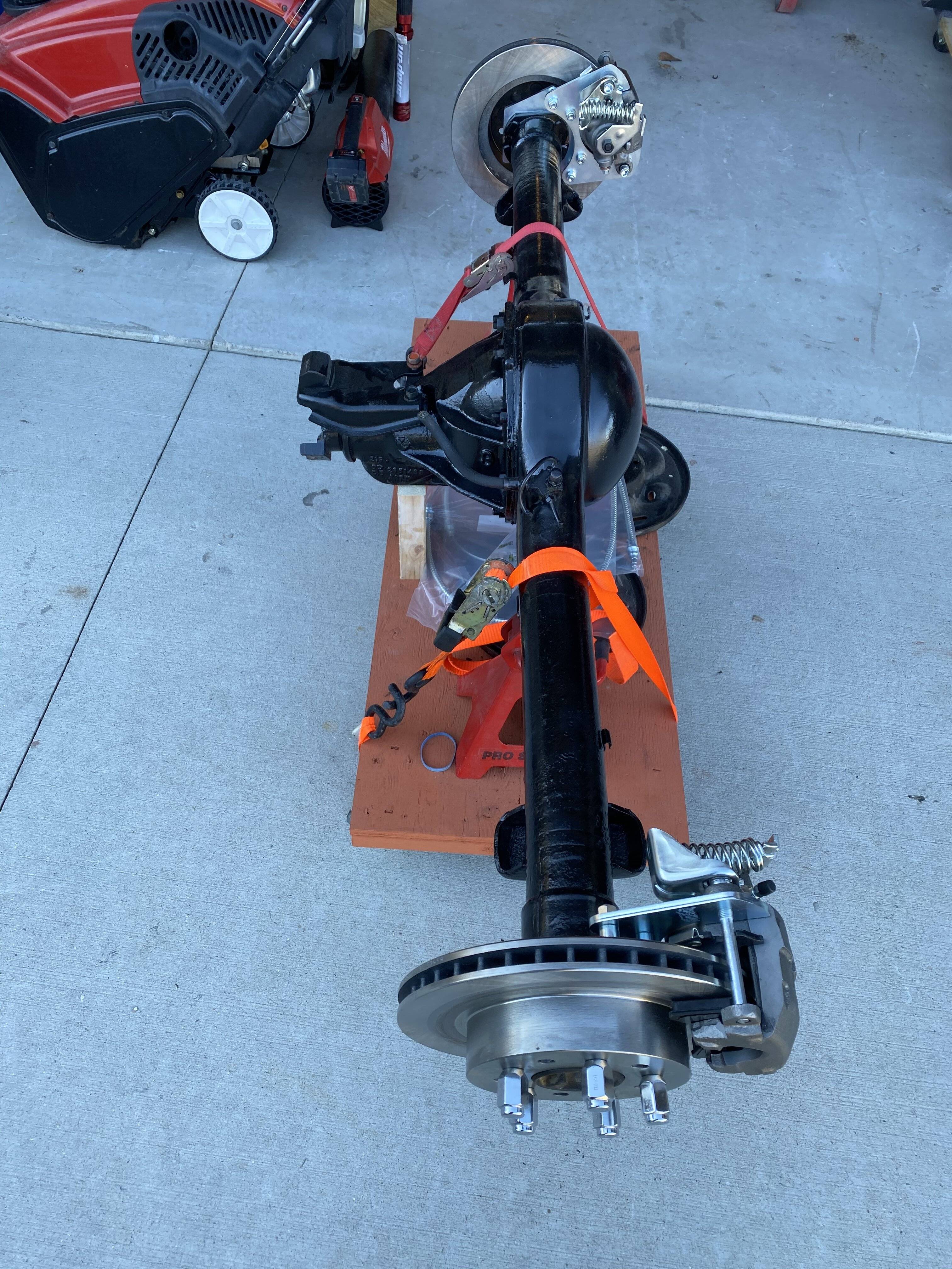

71rag
Sep 5, 2020
I recently refreshing the rear differential with 3:91 posi, new housing seals, green bearings pressed in, disc brake from Classic Industries

The use of "Green bearing" on the disc conversion is because the adapter blocks access to be able to adjust end play with the tapered bearing. The sealed bearing is a convenience, not an upgrade.
