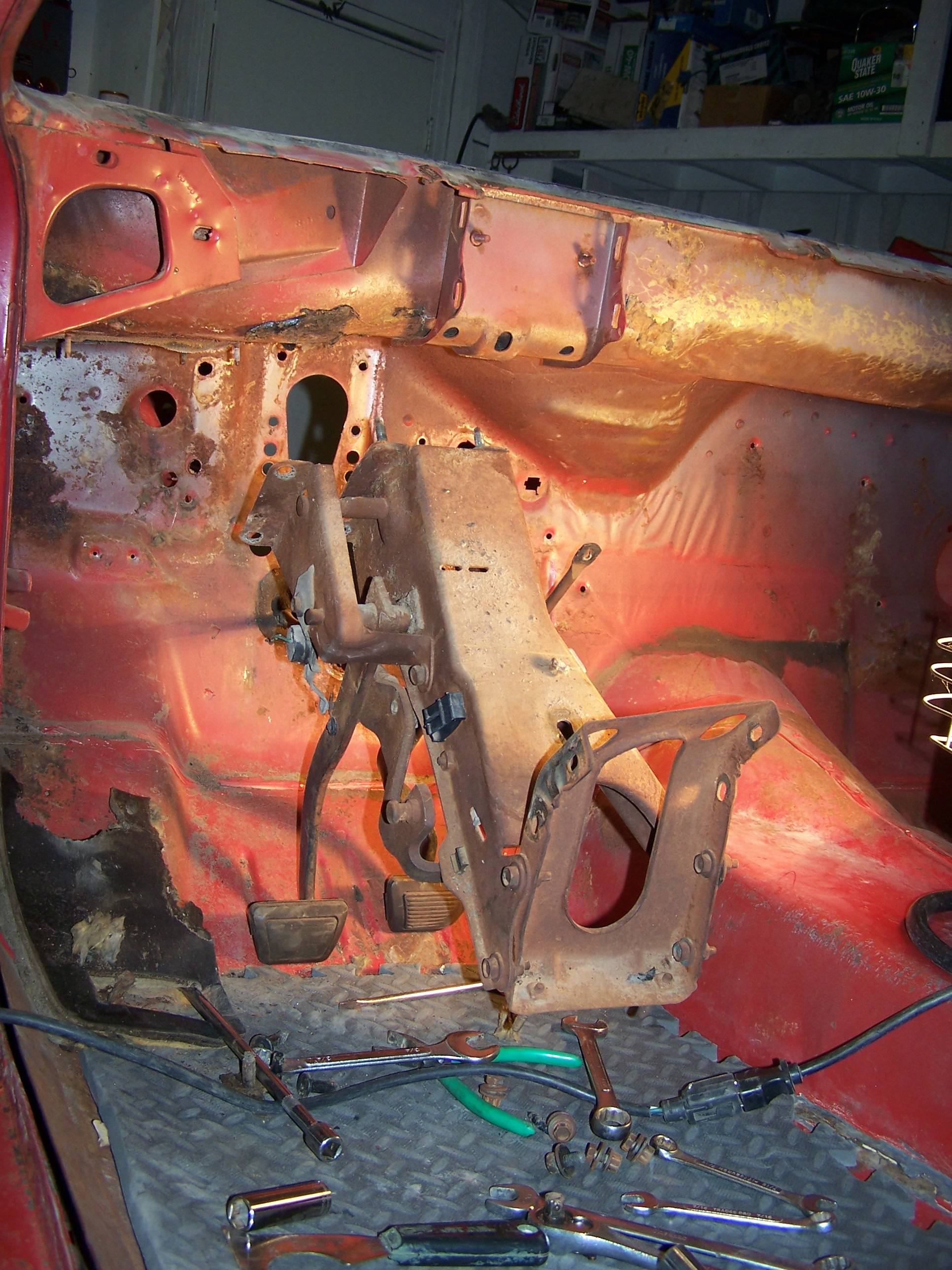

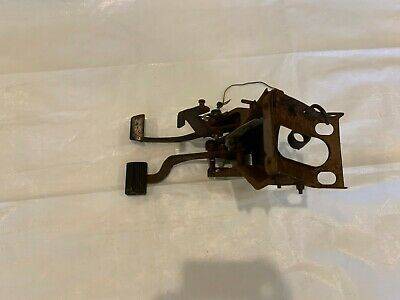

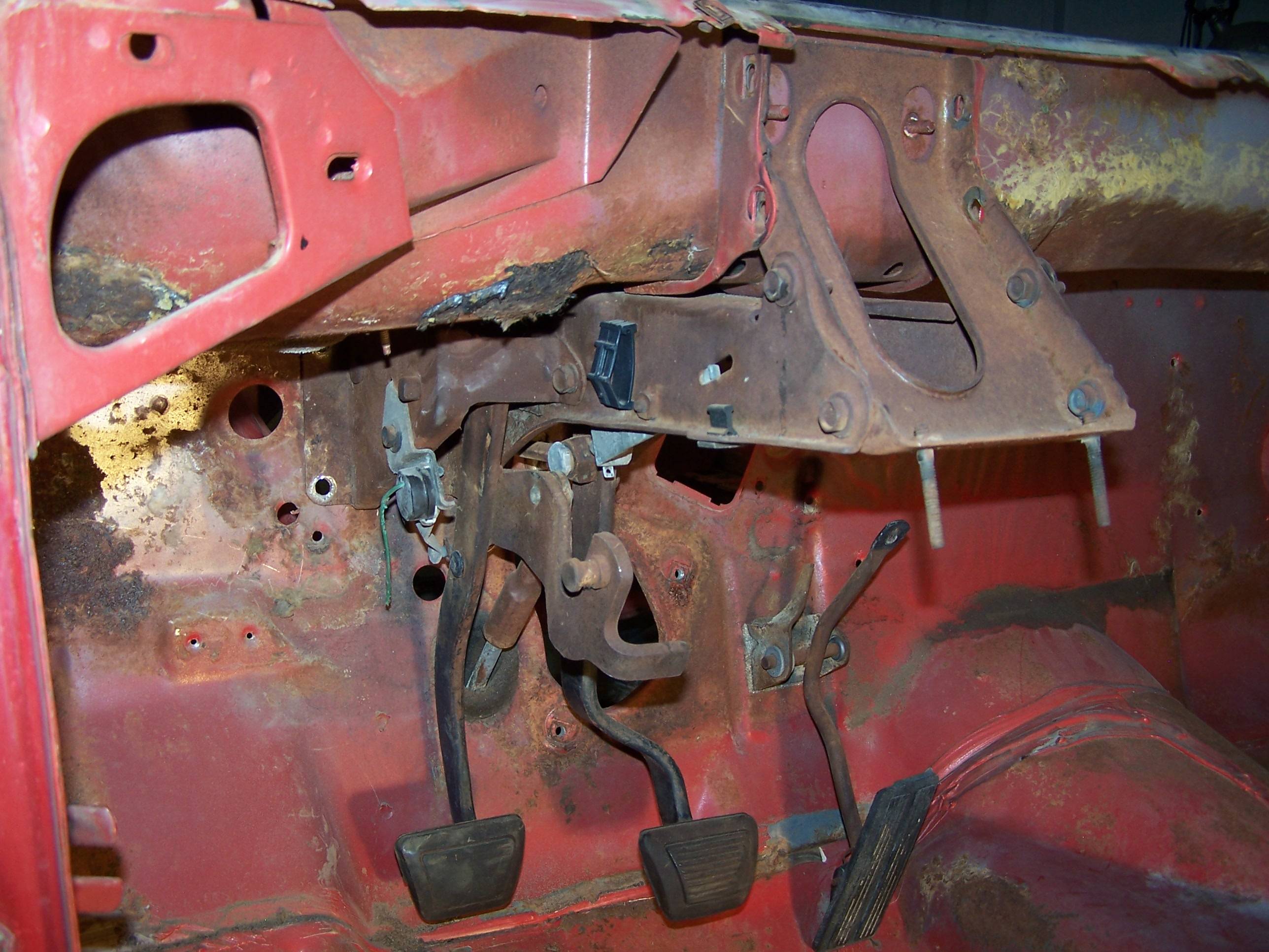

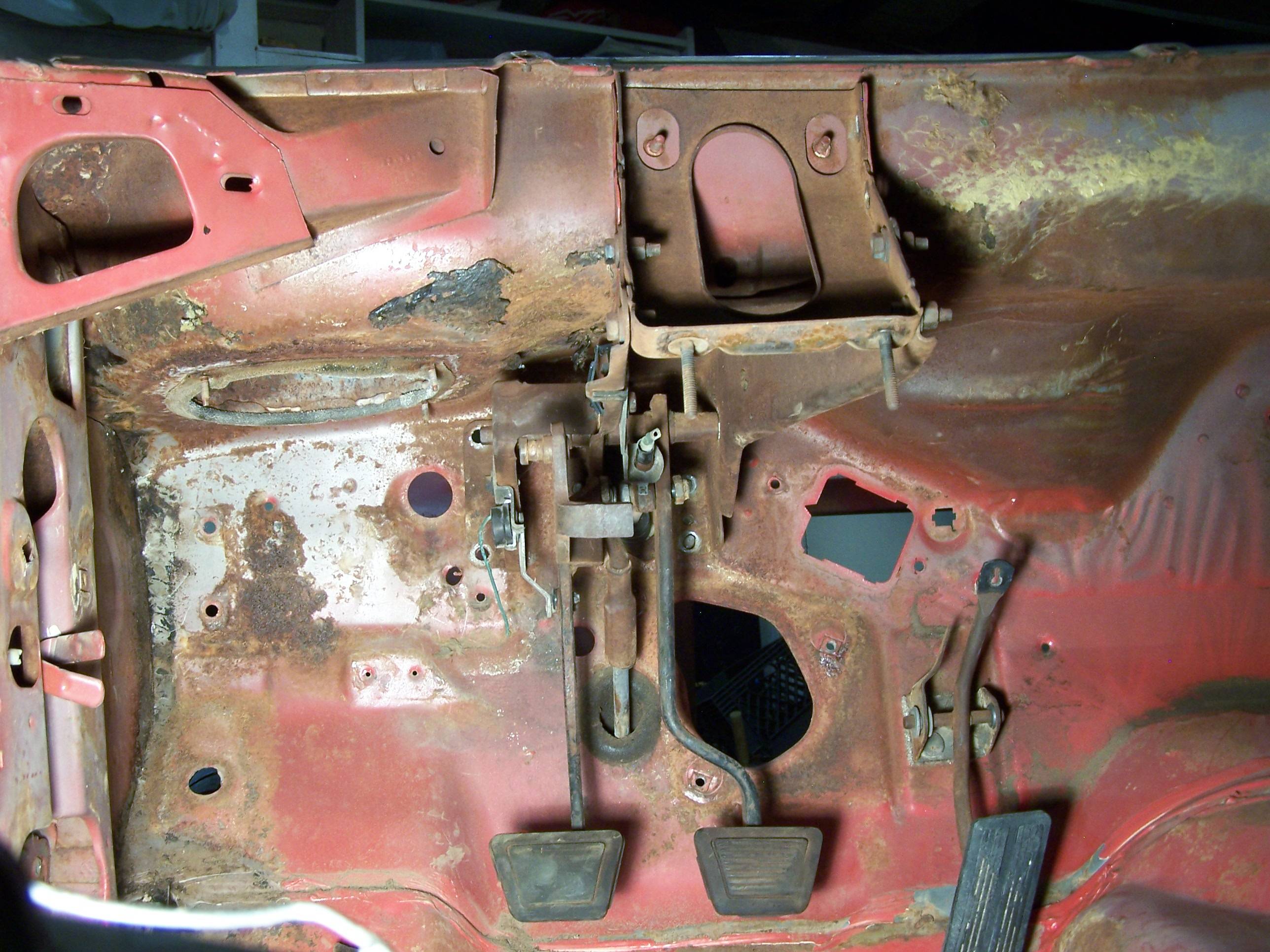

A few pics of a 71 set of pedals.

71 through 74 B body will interchange. That is the pedals only; not the bracket that holds them under the dash.
