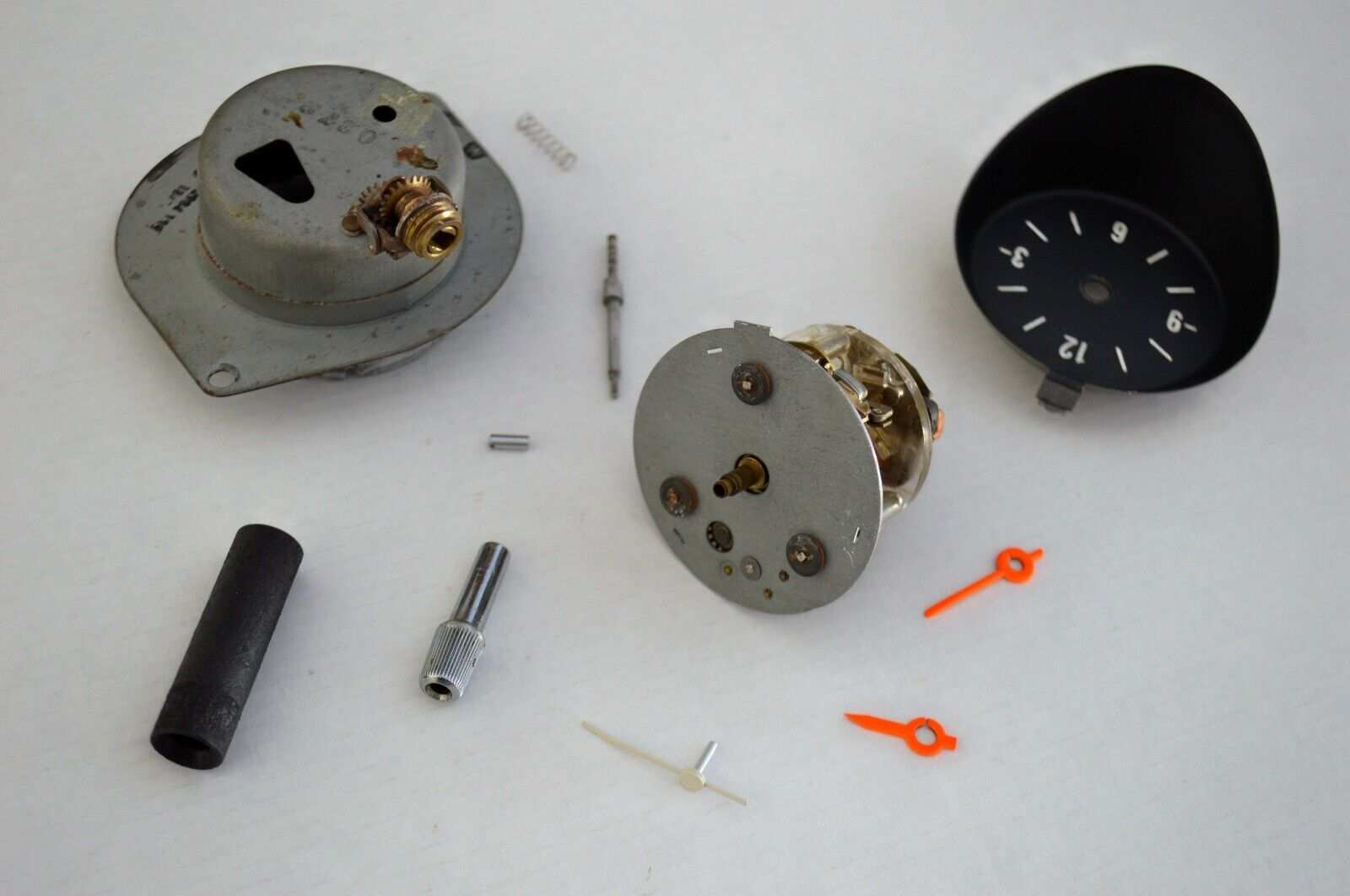

Here is a picture from another site. There should also be a small spring I believe.

Excellent. this is exactly what I needed and a lot more. So only thing missing is the correct adjuster knob, I see them on a few sites for sale but only in pck. of 2. Have the clock cleaned with (Murphy oil soap) for wood. soaked it over night, every thing is clean and shiny . Clock is sitting here running and keeping time. SO FAR. TKS 68Bee.

There are 5 parts in the knob assembly. Refer to the image.

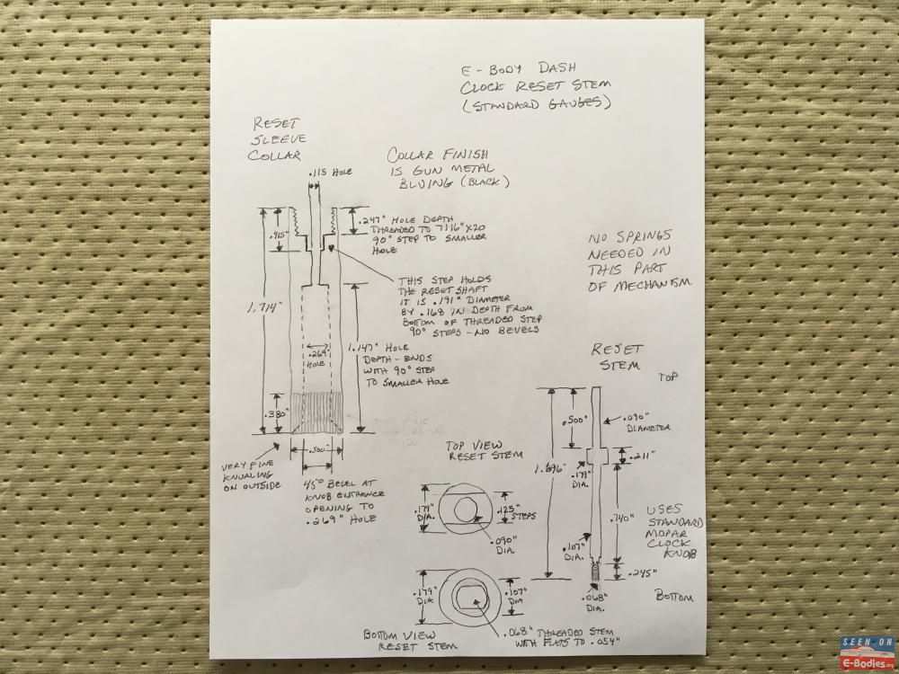

There was someone selling reproduction ones, a machinist who turned out some on a lathe, and while they were functionally equivalent, they did not not look OEM. The repro ones were one solid unit and brass color.

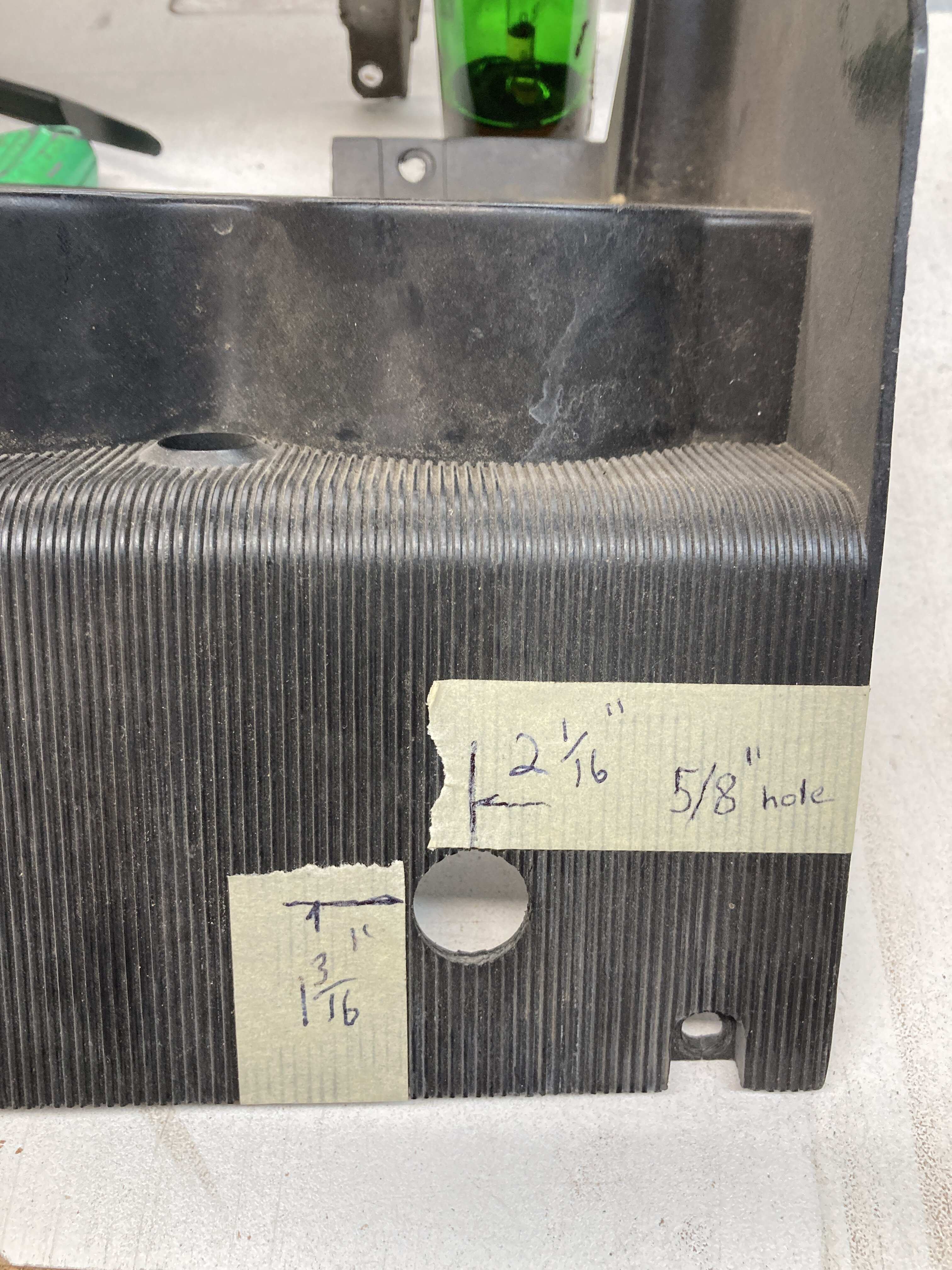

The only other thing I need to know is the size of the HOLE in the bezel, and does the big metal tube stay up behind the bezel or protrude down thru.
Sorry but car did not have the clock option this is being added.
You should find once installed, only the chrome part of the knob is visible through the hole. The black portion comes right up to, and maybe even into the opening but doesn't typically extend beyond the outer black surface of the bezel.
I have not measured this hole, but the black shaft is 1/2-inch and from memory, those holes are about the diameter of a dime (10-cent coin) just under 3/4-inch, perhaps closer to 5/8-inch.
Placement of the hole will be tricky to figure out. I did one by first drilling 1/16-inch pilot hole to check against the black-post center, and adjusted it before drilling the larger one. But the dash was not installed in the car at the time, so I had space to maneuver my angle of view. You want a slow drill speed for a clean hole.

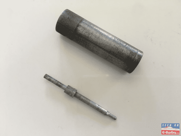

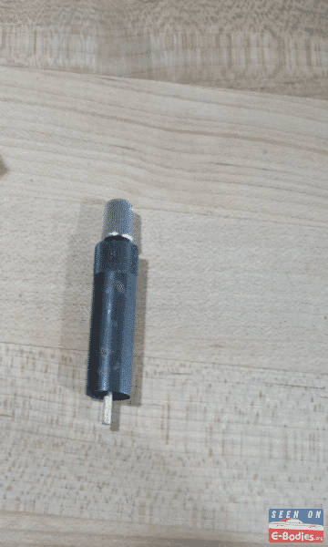

A guy on e-bodies.org took the trouble to reproduce the reset. I'm sure you could paint the main barrel black to look more exact. Linking his thread and his eBay listing. Only 2 left if interested.

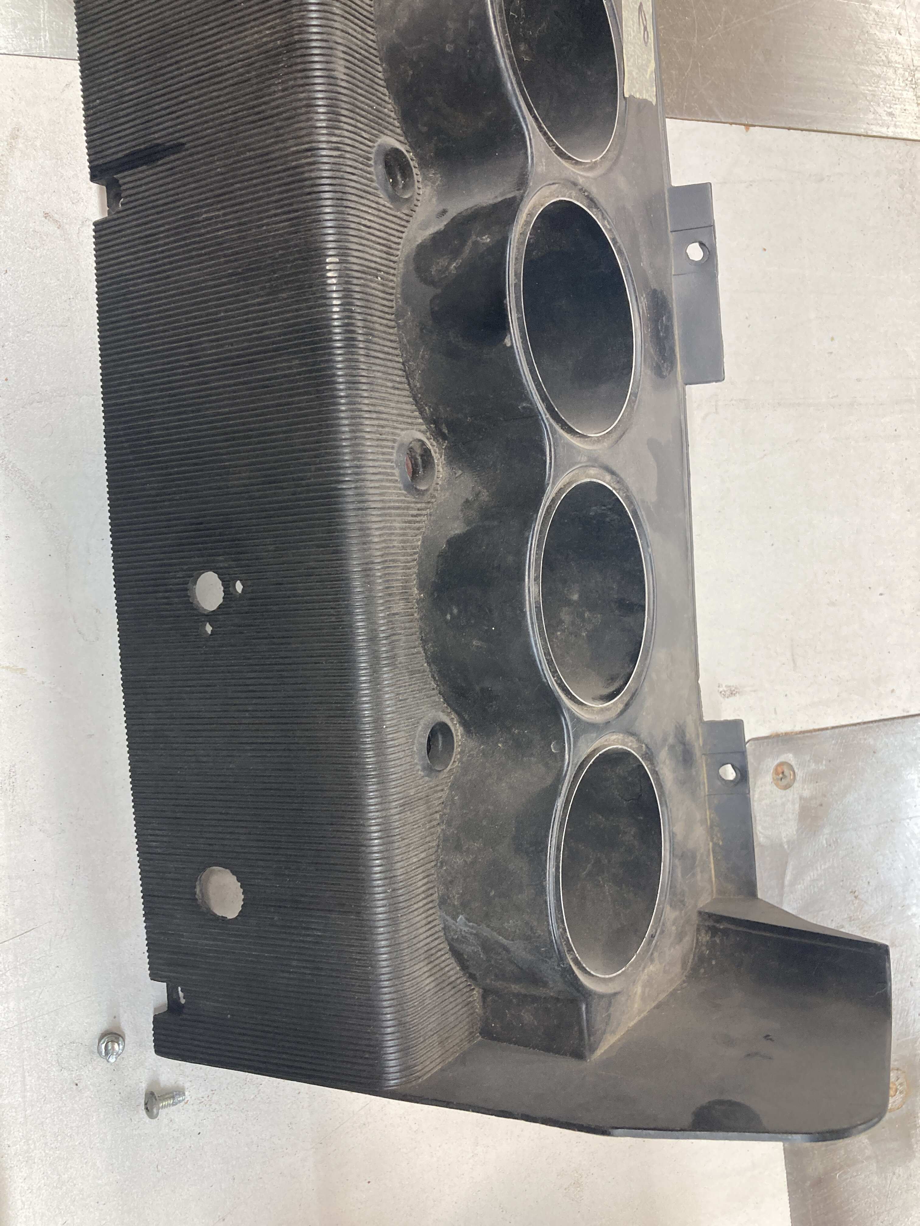

I have this bezel with what appears to be the factory hole for the clock but it’s ‘70 Challenger only. The location however could be transferred to the ‘71 + bezel. I also have a clock available but it’s rough, missing the knob but was removed from a ‘71 cluster.

@DetMatt1 It would be nice to get a measurement of the hole size, and its distance from the back-bottom edge of the bezel. Left-to-right, it appears centered directly under the clock.
