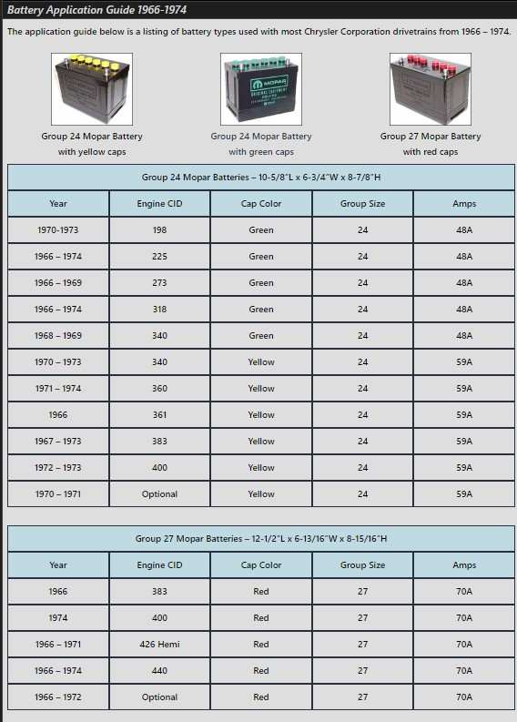

Do you have your broadcast sheet? Group 24 would be standard on the 340 but Group 27 was an option. BS would tell
MoparCarGuy
Jun 28, 2020
690
587

Thanks that what I thought but Costcos book says 27

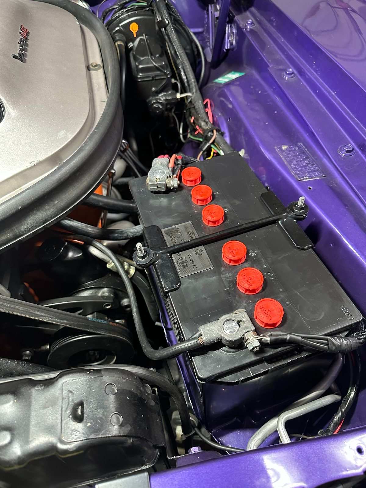

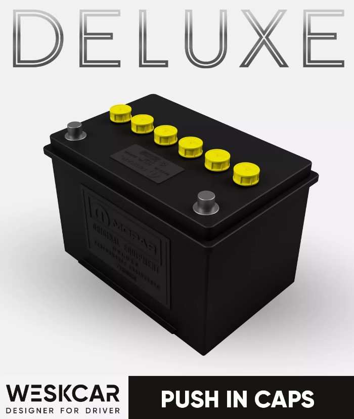

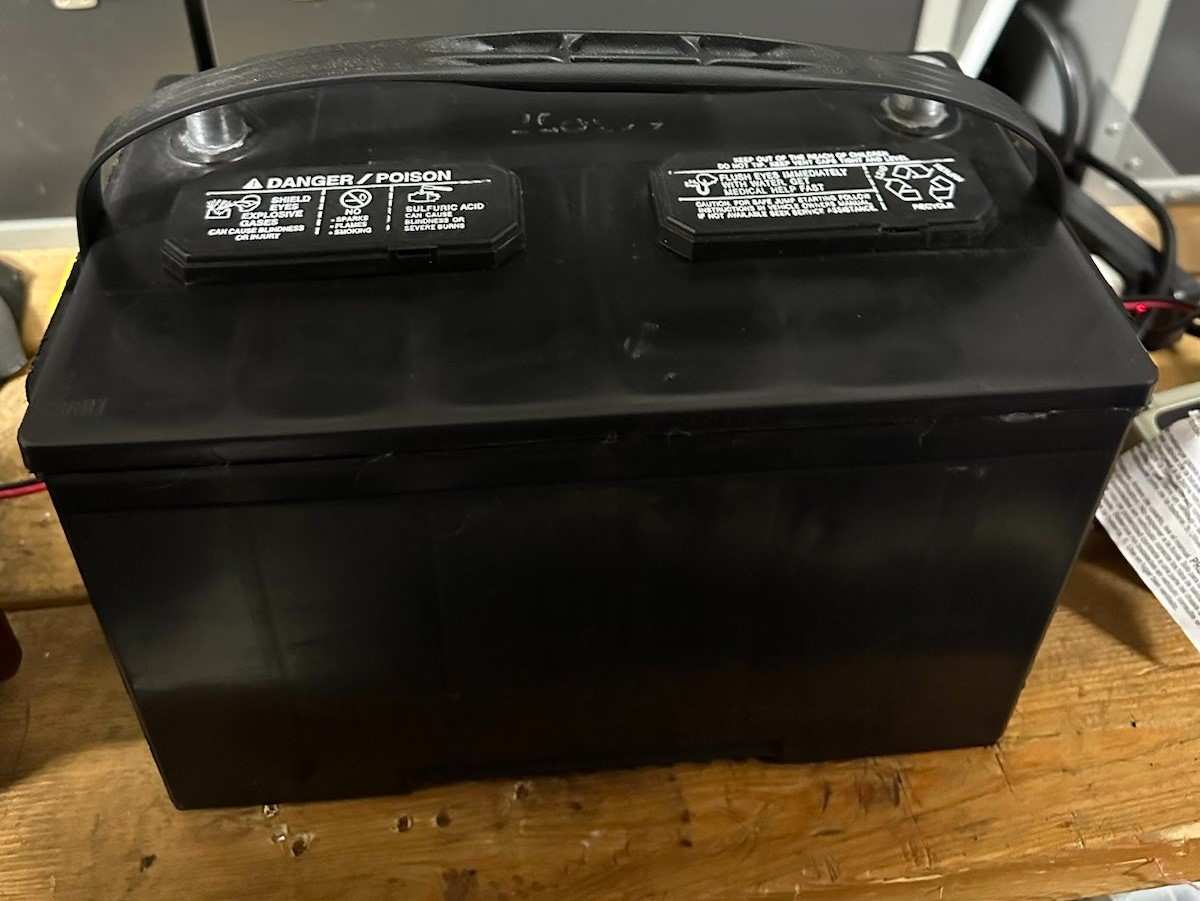

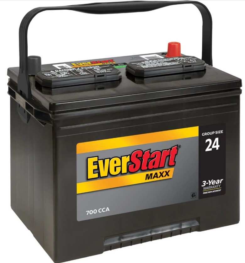

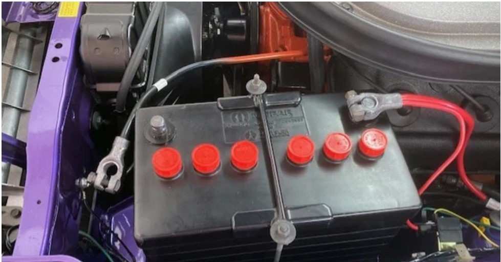

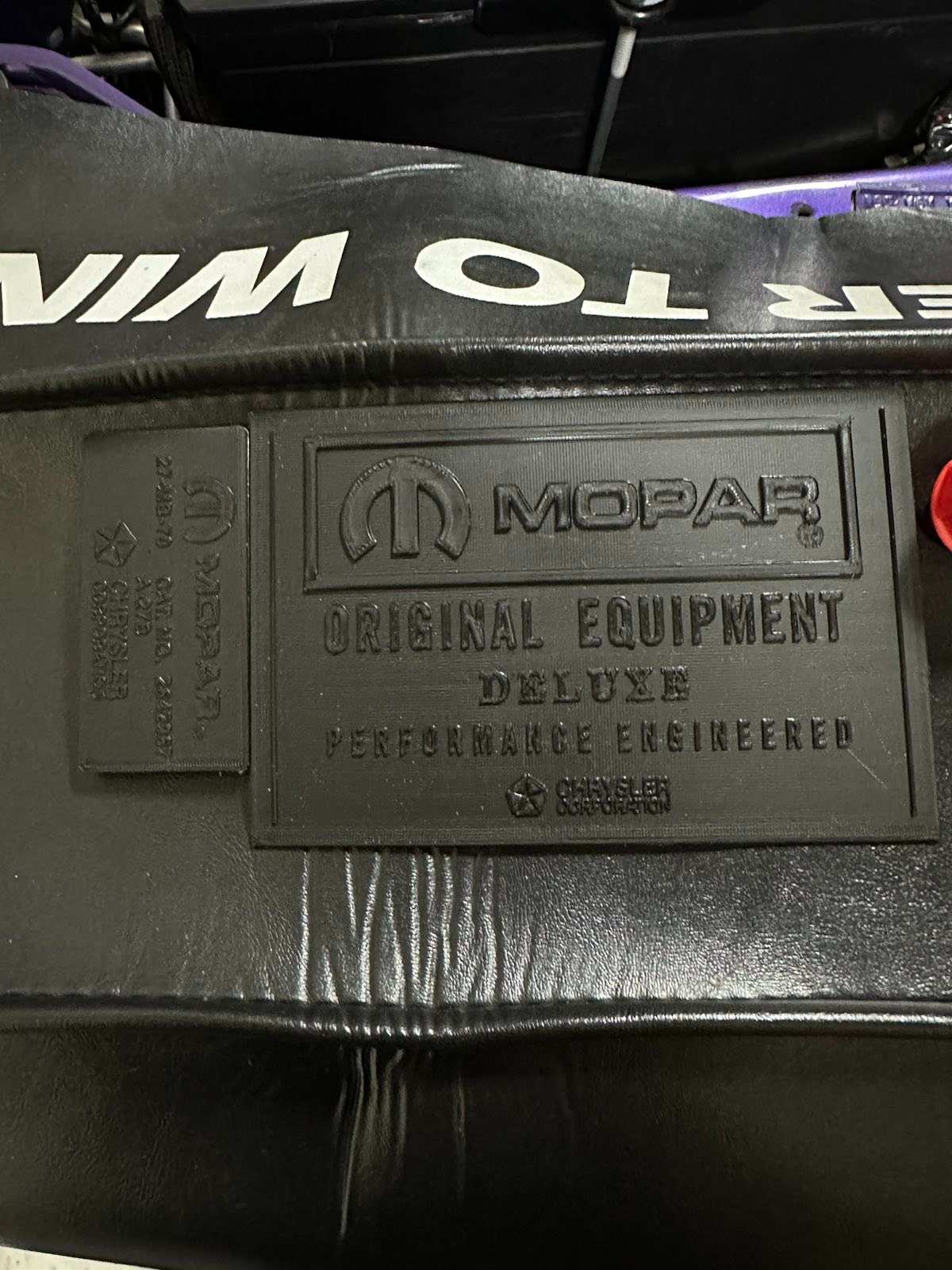

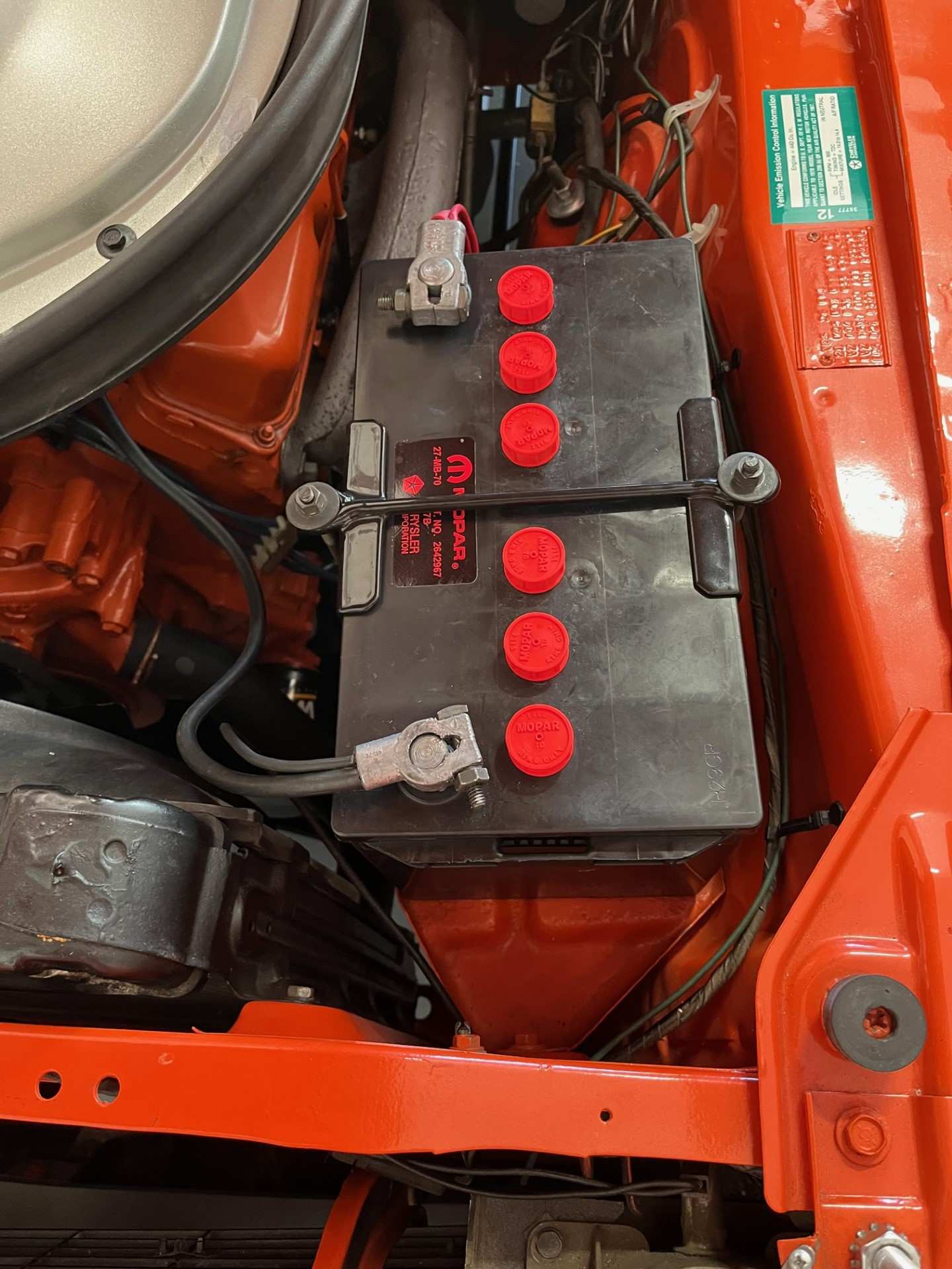

Consider a Walmart Everstart battery in group 24 or Group 27. They are about $150 plus fee, core charge, tax, etc. gets you to almost $195.
Peel off all of the labels and pop off the two plastic "caps".
Use the Weskcar Deluxe Push-In Caps Kit in Yellow for about $37 with shipping. The results are very good. I run the Group 27 (810 CCA) for my 440 with the Weskcar RED caps and embossed plates. The plates look to be 3D printed.
Comparison of this setup versus a repro battery below.
Weskcar 340 YELLOW Push-in Caps and embossed plates for side and top FULL PIC.jpg
