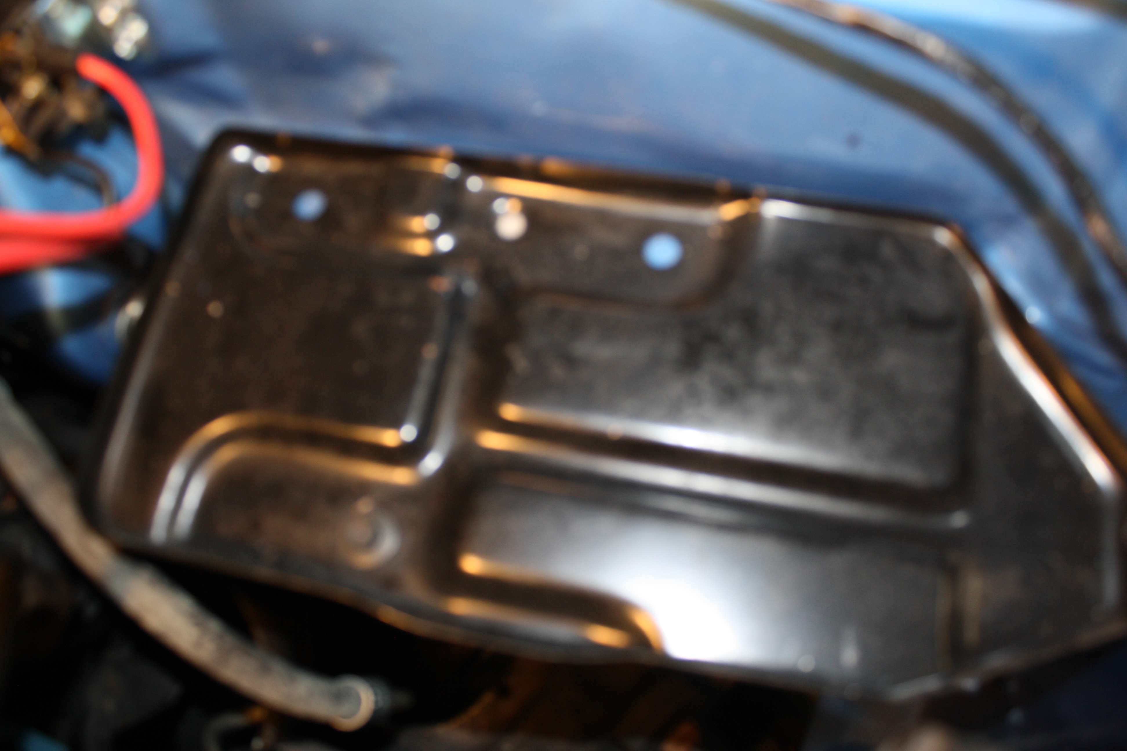

battery tray
michael bucklew
Aug 24, 2019
308
39

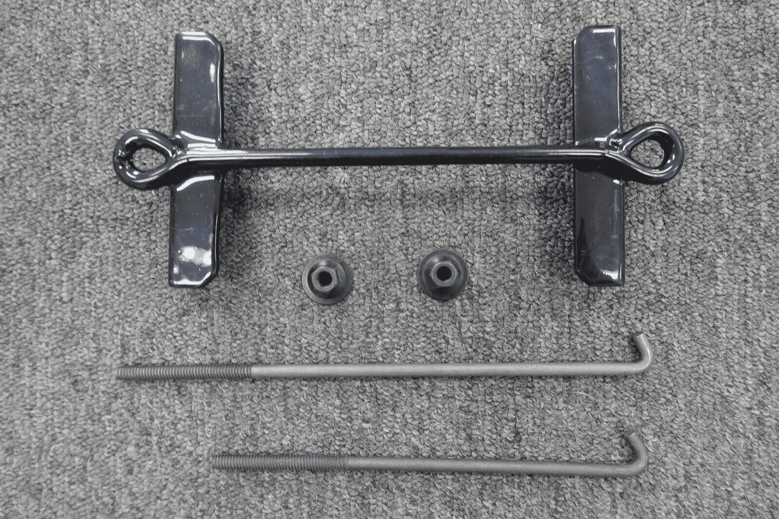

installed tray. attaches to rad frame and a bracket on the bottom. there are 3 holes in the tray. ? do nuts and bolts go in these holes and what kind???

The holes in the center are used by the battery hold-down clamp. These are two threaded rods the have hooks on their ends to feed through the holes.

The centre hole is a drainage hole - there should also be a hole in the inner fender to align with it.
The outer two have bolts ( 5/16 ) through them that thread in to captive nuts in the inner fender. There are holes and slits for the captive nuts to go in the inner fender.
The long battery hook goes to a hole in the side of the battery tray.
The short hook goes to a hole in the inner fender above the battery tray.

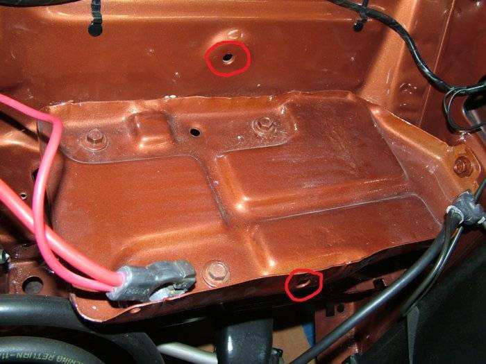

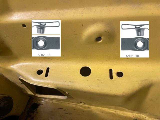

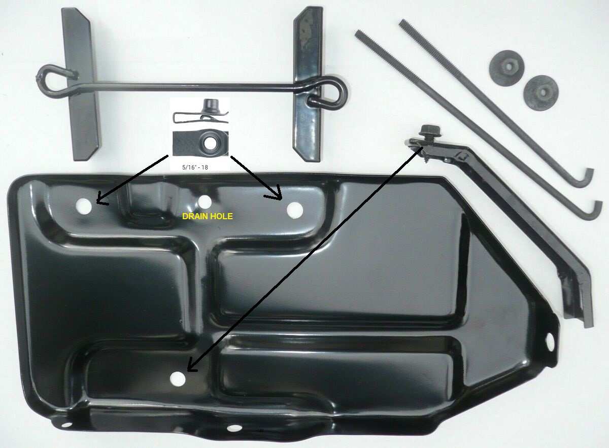

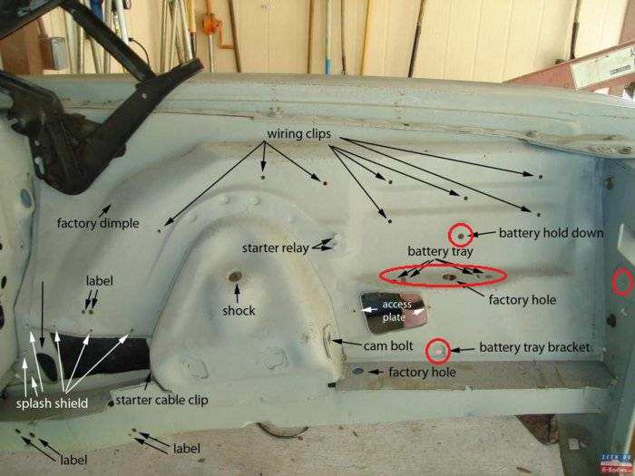

MoparCarGuy
Jun 28, 2020
689
584
These pictures should help.
The 5/16"-18 panel nuts a.k.a. U-nuts are available at Lowes in the hardware section.
