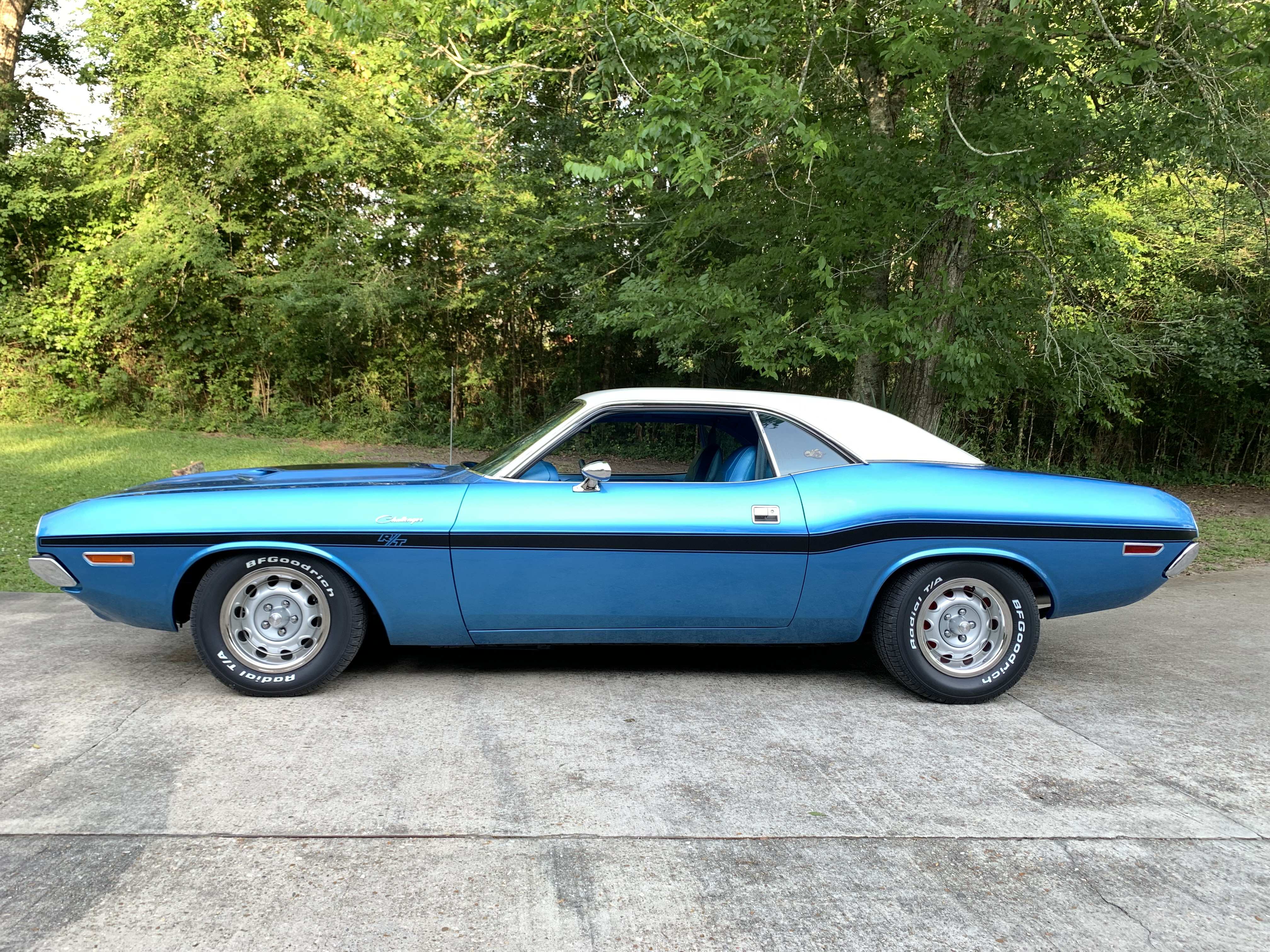

My ‘70 Challenger was built with column shift and a bench seat. It has retractable front belts and shoulder belts just like the bucket seats.
