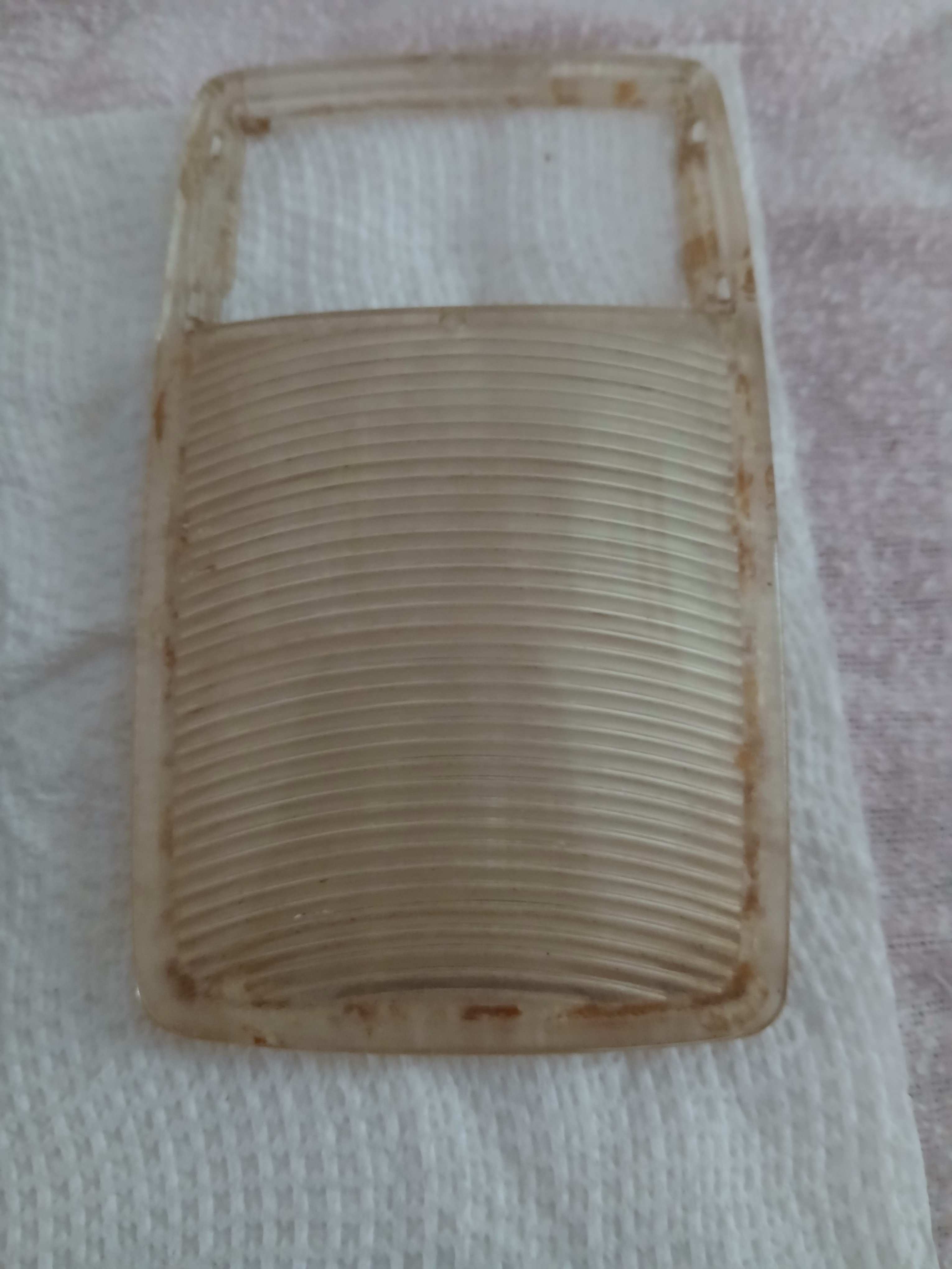

Got original dome lens. Really don't want to spend 50 + shipping for a repop that might or, might not work?? Anyways is there something to soak it in, or to clean it up? It will never be perfect. Just wanting it to look better than present condition. Already been cleaning it with windex for last 2 hours.

keep in mind 50-year old plastics are brittle, and can crack and break easily. more easily that you would think, so handle it with gentle care. a newer repop still has some flexure. the older stuff does not.
if that brown is rusty metal residue, you'll want to get that off first, as the grit may scratch the plastic as you clean it. for this, you can soak it in straight (5% off-the-shelf) kitchen vinegar. or something stronger, if you want. I often use an old credit card as a scraper. In this scenario, after soaking, you can scrap the metal off, and resoak until clean.
next is your basic soap and water. you want to remove as much or all of any dirt as you can. I like using liquid dish soap and water, mixed 50/50. if there are crevices, an old tooth brush works great. I even have an old sonic toothbrush I use on occasion.

After soaking, the brown around the edges is not rust. Found out the brown is glue.The housing has zero rust. Although the glue is a b to get off.

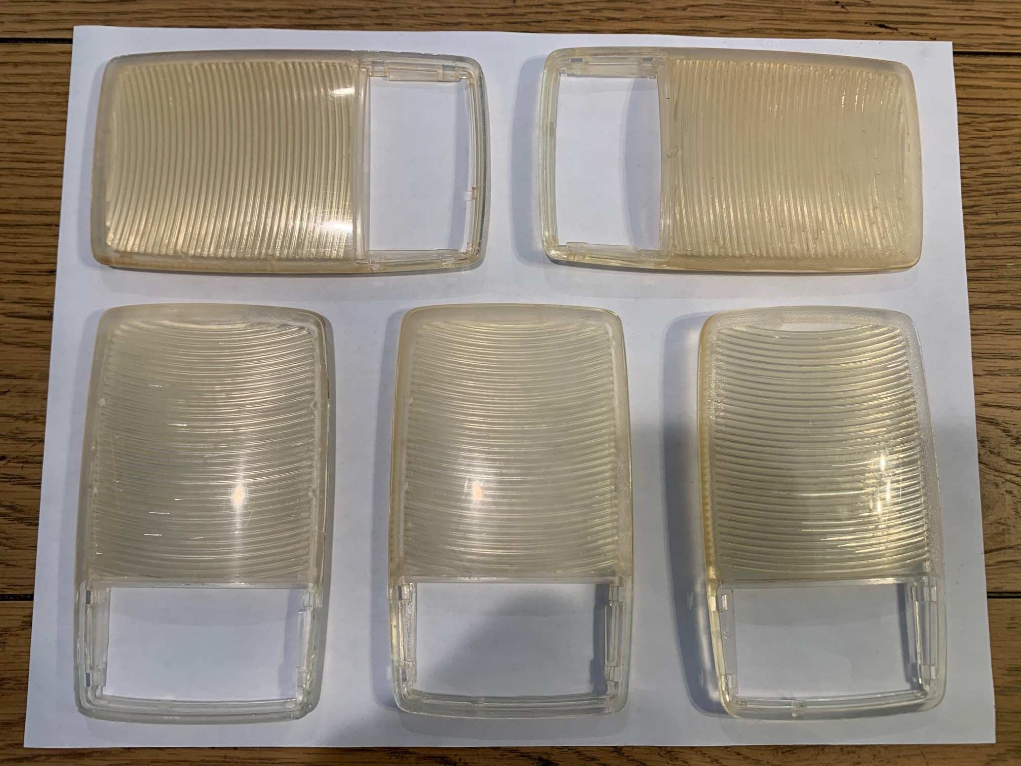

Here are my extra old lenses. I can't send pictures in a private message so I figured I'd post one here. Probably the bottom left or middle one would be the best of the bunch. The top two being the most yellowed, and the bottom right one seems to have some weird waves or something going on in the plastic.
They all seem to have most of the tabs broken off so would need to be glued in.

The one that was on the car was also glued in, only had 2 tabs left. Really don't want to glue that part back up. The tabs must be the weak link. Wondering how many tabs on a complete one. Thanks for pulling those out, and getting back with me.

No problem. There are supposed to be 10 of those little tabs altogether.
