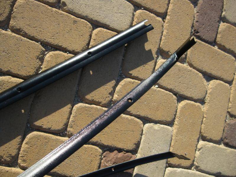

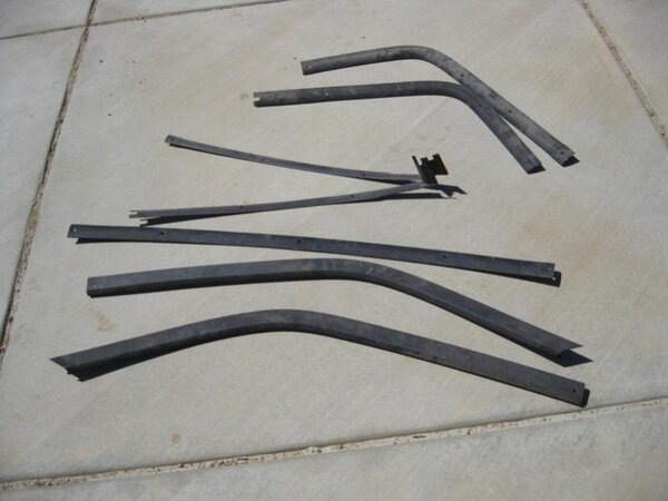

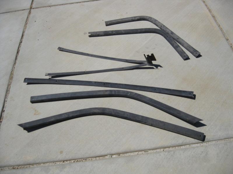

You will be ok with blasting the metal trim, not plastic (ex: A-pillar pieces, seat backs, etc). I sand-blasted my window trim with low pressure and fine sand (60 grit).. most sand I get around here is 30 grit which is too rough on detailed pieces, but it rips the rust right off suspension pieces.
Anyway, here are some pics of my sandblasted & painted metal trim. Click on the pic for a larger view. Also it would be very easy to cover the grain with too much paint. I recommend no primer. Trim before.jpgTrim after.jpg

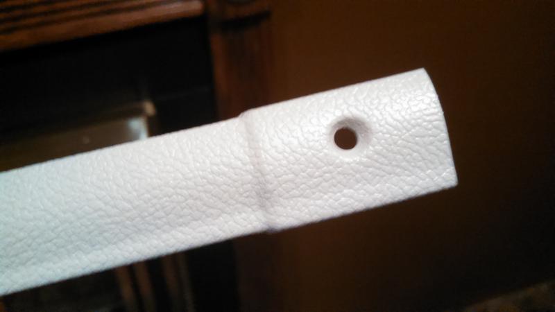

I bead blasted my metal interior window trim. The trim turned out great,no harm to the grain, I used sem paint.IMG_20150724_114150_883 (2).jpg

I blasted mine at work in our bead blast cabinet, we have used a silica sand based media and a glass based media that we order from Grainger ,nothing to aggressive. I'm on vacation or i could tell you exactly what we use, I can let you know on Monday if you really need to know. I would think most types of fine media in a blast cabinet would work fine on the metal window trim.
