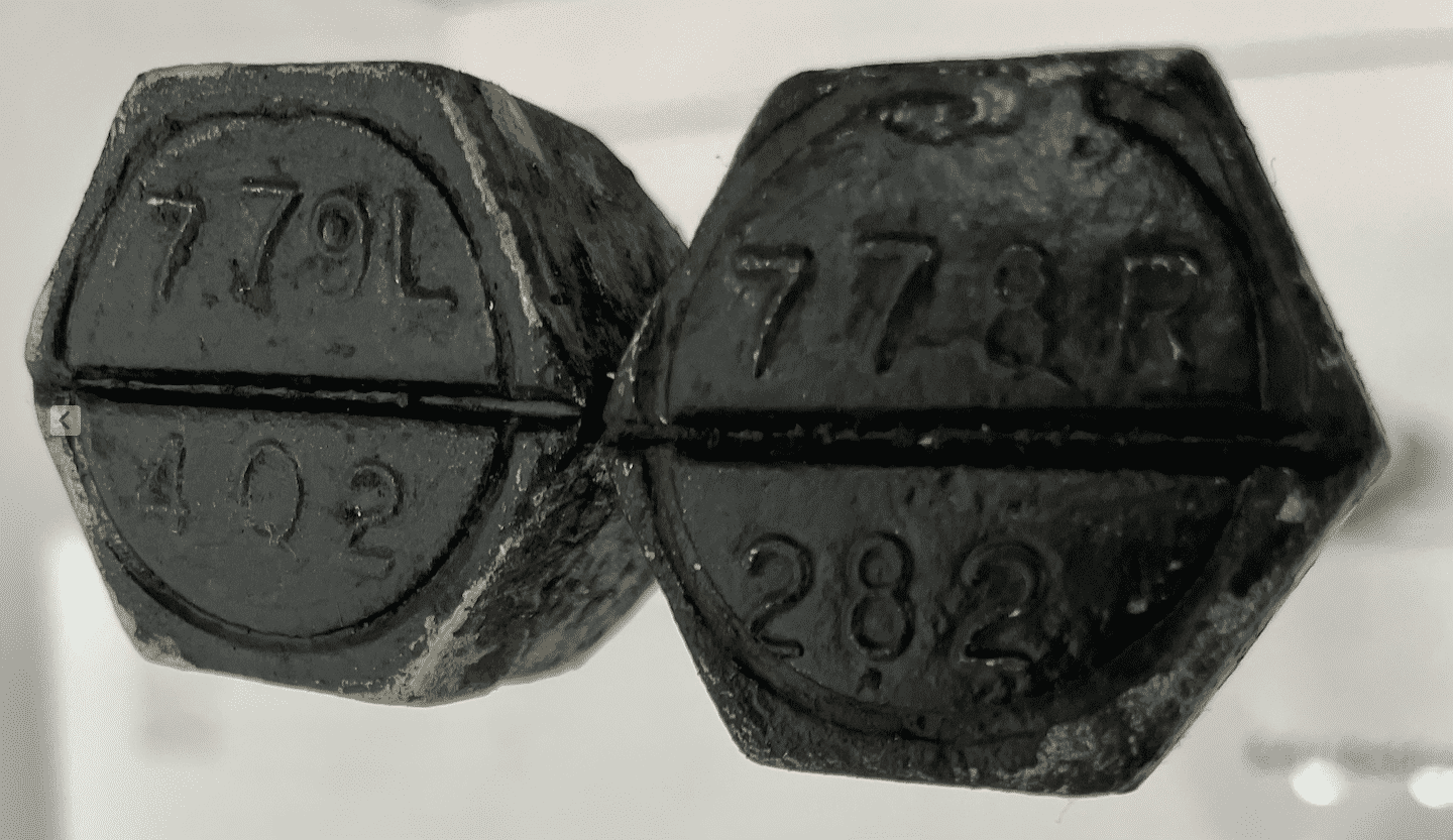

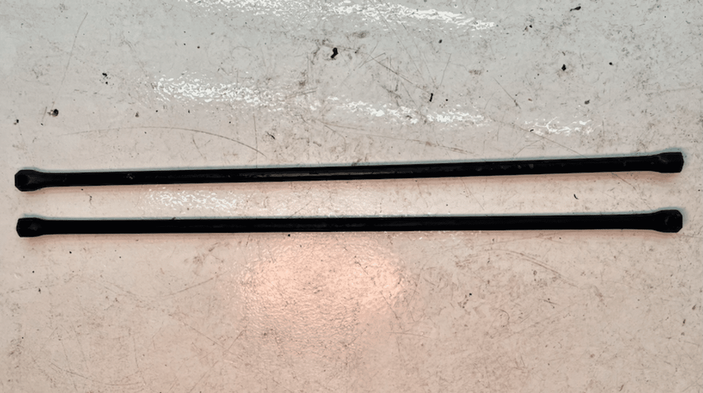

And if you're trying to keep it original with OEM parts, I'm selling my .90" torsion bars (1857778 and 1857799). They were included in the "Heavy Duty" suspension package according to the parts book, not to be confused with "Extreme Duty" .92" torsion bars.
