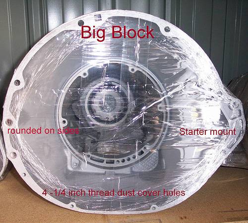

Big block or small block 727?
tactransman
13
Here is how to tell.;)
