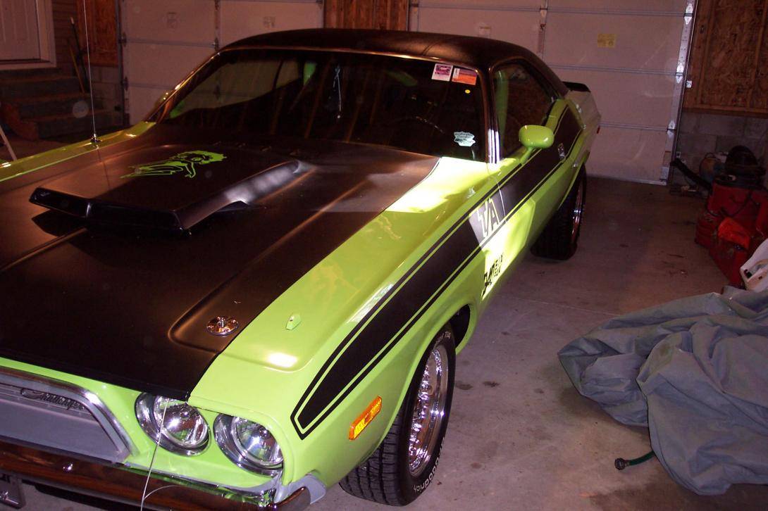

I would like to black out my 73 challenger grill and would like some feedback and pics as to what it would look like? it is a T/A clone and i'm afraid it won't look right, thanks Walt

The first pic is my grill, the second is another option. greenmonsta's suggestion of changing grill is another option. Does anyone have any other pics of blacked out late model challenger grills?

The pic of the yellow car looks OK. They left the hood moulding and the trim at the front of the fenders body color.
I think your car looks just fine. I wouldn't paint the header panel black but I would paint your grill black. It looks like it is the standard (non Rallye) gray grill. The black looks much better and would go good with your hood.

When painting the grill black I would also black out the filler pieces btw the grill and bumper and btw the bumper and fender too.

I don't like all one color for the grill area. The black one would look ok if it had some silver or some thing to brake up all that black and give it some depth. But thats just me.

The fillers he is talking about are the three gray rubber pieces on the front of the car. One in the center that is screwed to the grill. The two outside fillers screw to the header panel and clip into the fenders. Those fillers were used in 73-74 when the bumpers were moved out farther from the body.
If your car were mine, this is what I'd do. I'd remove the fillers all together and move the bumper in closer to the body. All you have to do is drill four 5/8" holes in the bumper bracket where the square holes are currently located. That will put the bumper in the 70-72 possition. Then I'd paint the grill(just the grill) black. IF you still think the front end needs more black, then you can go ahead with the rest of it.
That's just my opinion. You need to do what ever you like best. If you are happy with it...that's all that matters.

Yeah remove the 73-74 bumper fillers and move brackets back as burdar said, and I would for now just paint the whole grille black except the leading edges (would have been the stainless headlight buckets on 70-71)
and when you get up the funds change the grille and rear tail panel to a 70! Car looks great though! whats up with the betty boop decal? :D

I pretty much agree with what burdar said but if you don't want to move the bumper in I would paint the fillers flat black
As for the grille, leave the stainless piece around the grille silver and the leading edge of the grill paint silver.
