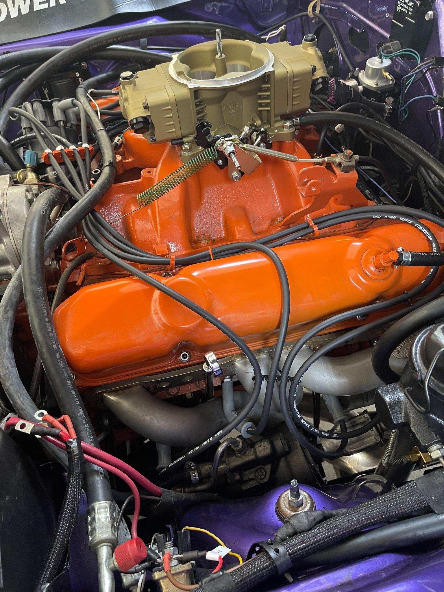

Highly recommend using studs. My example below is Indy 440EZ heads with stock valve covers and Moroso blue 93055 gaskets.
Just drop them on the studs and install the valve covers.

Thanks Looks good. No im not using aluminum valve covers
